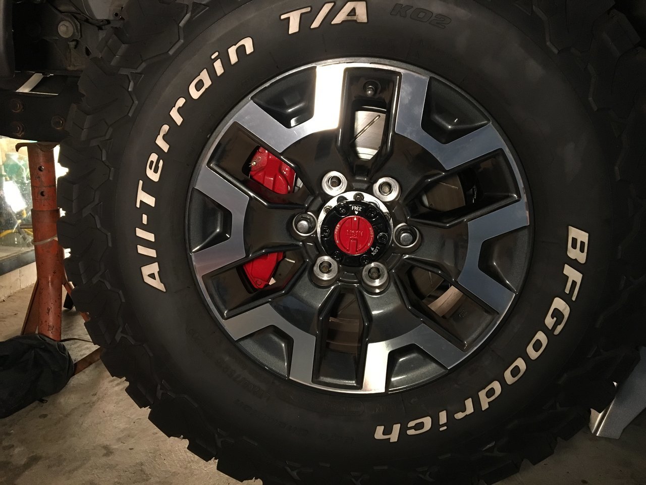

    Yes! The Tundra brake upgrade is my absolutely favorite mod to my truck. Braking difference is night and day.
    @mechanicjon should have a template you can print out to test your wheels but they fit my 2017 16" TRD OR Wheels just fine.

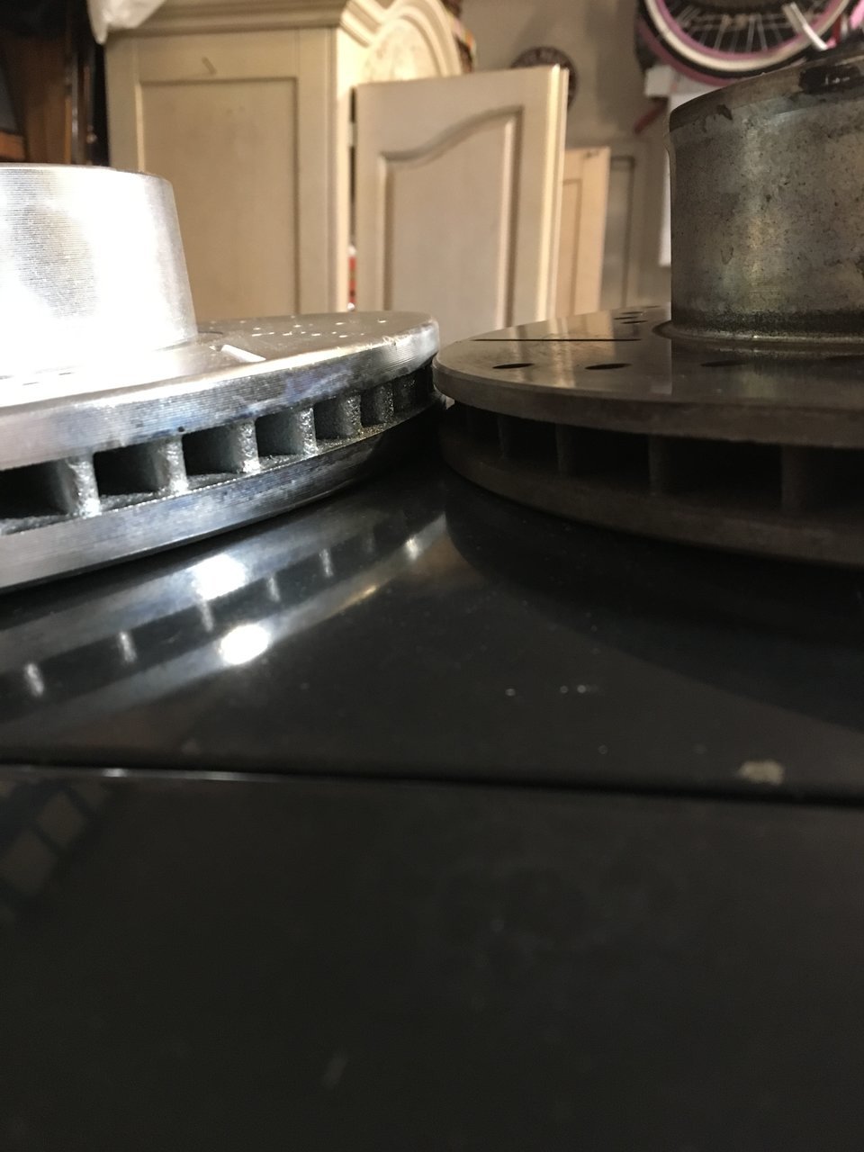

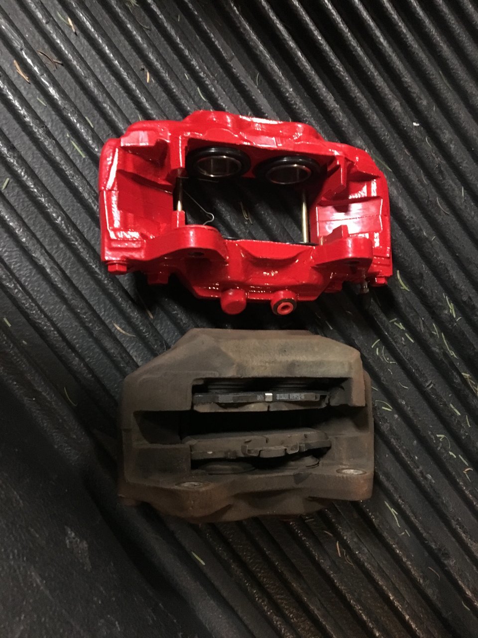

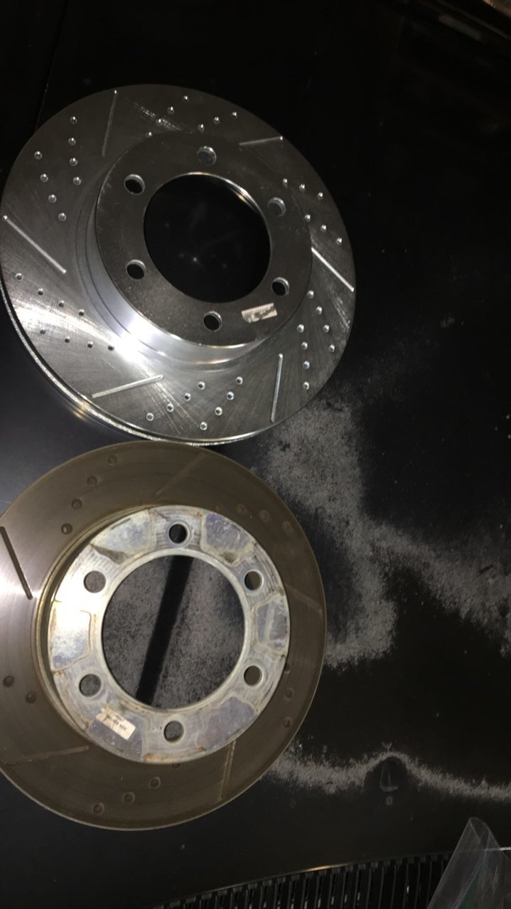

    The Tundra PowerStop kit it excellent. The Calipers are basically just remanufactured OEM Calipers so really only the pads and rotors are PowerStop. On my truck only the pads were PowerStop and the Rotors were upgraded to the discontinued Baer Sport Performance rotors.
    The reason the 13WL caliper exists in the first place is because the S13WE caliper on the early first generation of Tundra was too weak so Toyota had to create a much stronger caliper and braking system.
    You can see the huge difference between the old PowerStop Tacoma rotor and the Baer Tundra rotor here along with the Calipers:
