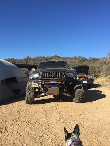

    Interested to see what you come up with. I used 1.5". 120 wall tube for mine.

    How'd the bumper look?
