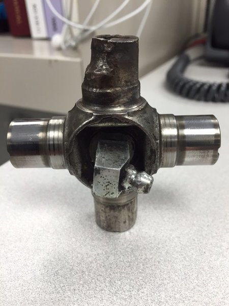

    The high speed vibes are probably from a failing drive shaft u joint, most likely at the rear differential. Unbolt the driveshaft from the pinion flange and rotate it through the entire range of motion. If it's sloppy, grinding, sticky, or anything other than smooth and easy to turn, it's toast. Pic related

    Turned out to be a bad u-joint
