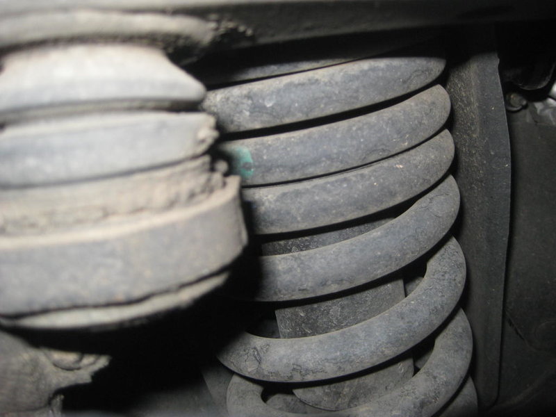

    your steering rack does look a little suspect. One thing you can do is take a push pin and poke a tiny hole in one of the bellows boots. If fluid comes out, you should replace the rack. The greenish fluid might be dye that was added to the fluid to find the leak.

    Also, the power steering rack is mega leaking. I released one of the clamps on the accordion hose and a brown sludge poured out. Any way I can find the leak and patch it, or am I hosed?

    If the rack is leaking inside the boots, it's time to replace it.

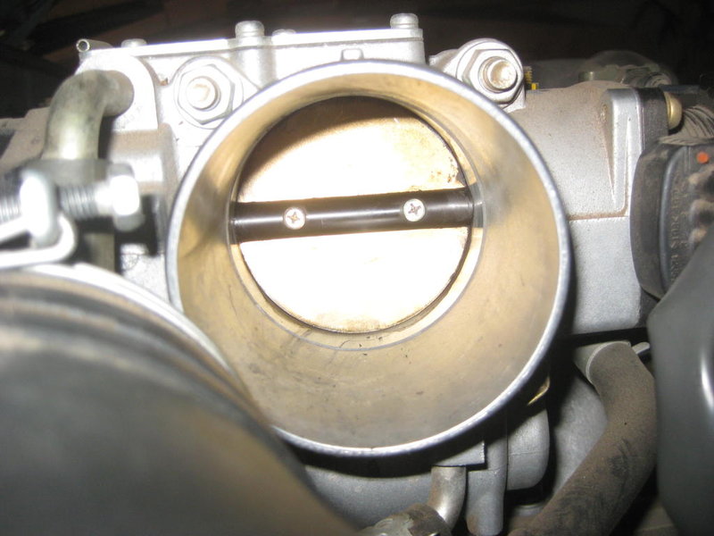

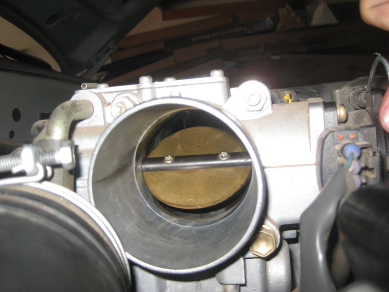

    So I was just looking through the forums and noticed something odd. This is as far open as the carbon plate will open with the accelerator to the floor. I can push it open with a screw driver, but i've seen other posts where it's open all the way on it's own.... is this normal?
    I took another look at this after I noticed that the truck idles very high on start up for a while. I've read that they can idle up to 1900rpm on startup when it's cold, however i'm in Arizona and it's 100* out. The truck will stay at 1600 rpm for a few minutes when left in park, and SLOWLY drop down to just under 1k rpm. Any thoughts?

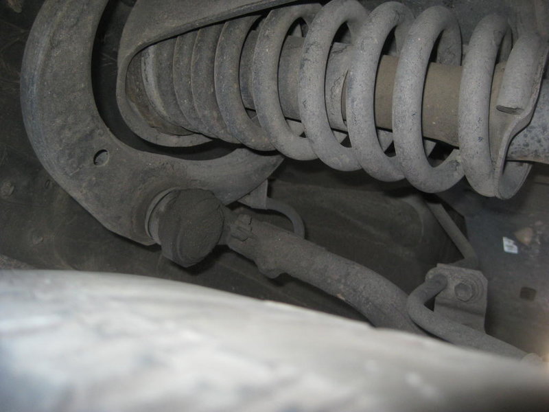

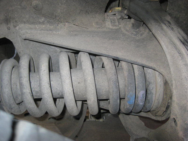

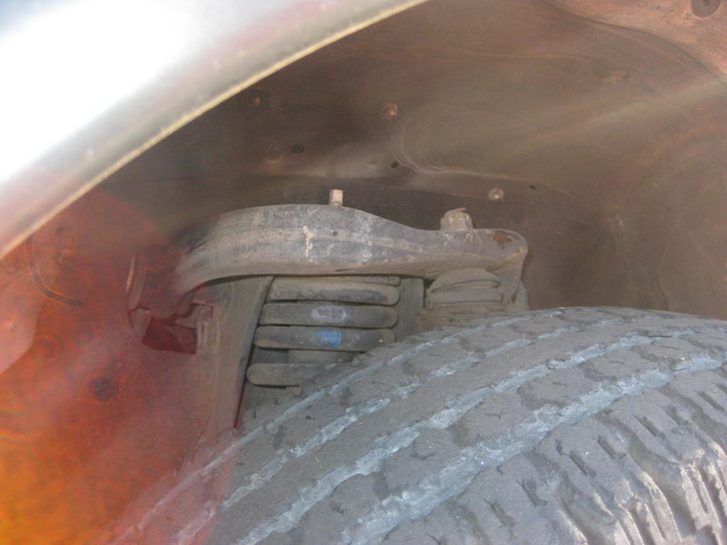

    I also wanted to add that I read this :
    my coils are about 1mm from touching at the top. Does this mean i need to replace them? I want to get new shocks (probably some billys), but I feel like if the suspension is bad it will wear out new shocks faster... Any input on that?

    post some pics of the spring so we can see what you mean

    There are some pictures posted on the first page, but here's some new ones.
    Passenger side followed by driver side.

    Coils are defintely shot dude. Hit me up on a PM, I have some stock TRD coils with ~45,000 miles, I'll make you a deal.

    Aren't the coils on our trucks known for being bad or having a short life? I've heard that they're pretty much done at 70k miles....

    From my understanding the TRD coils are progressive rate while the non TRD coils are not which cause the TRD coils to wear out faster. My coils were shot around 80k-90k miles.
