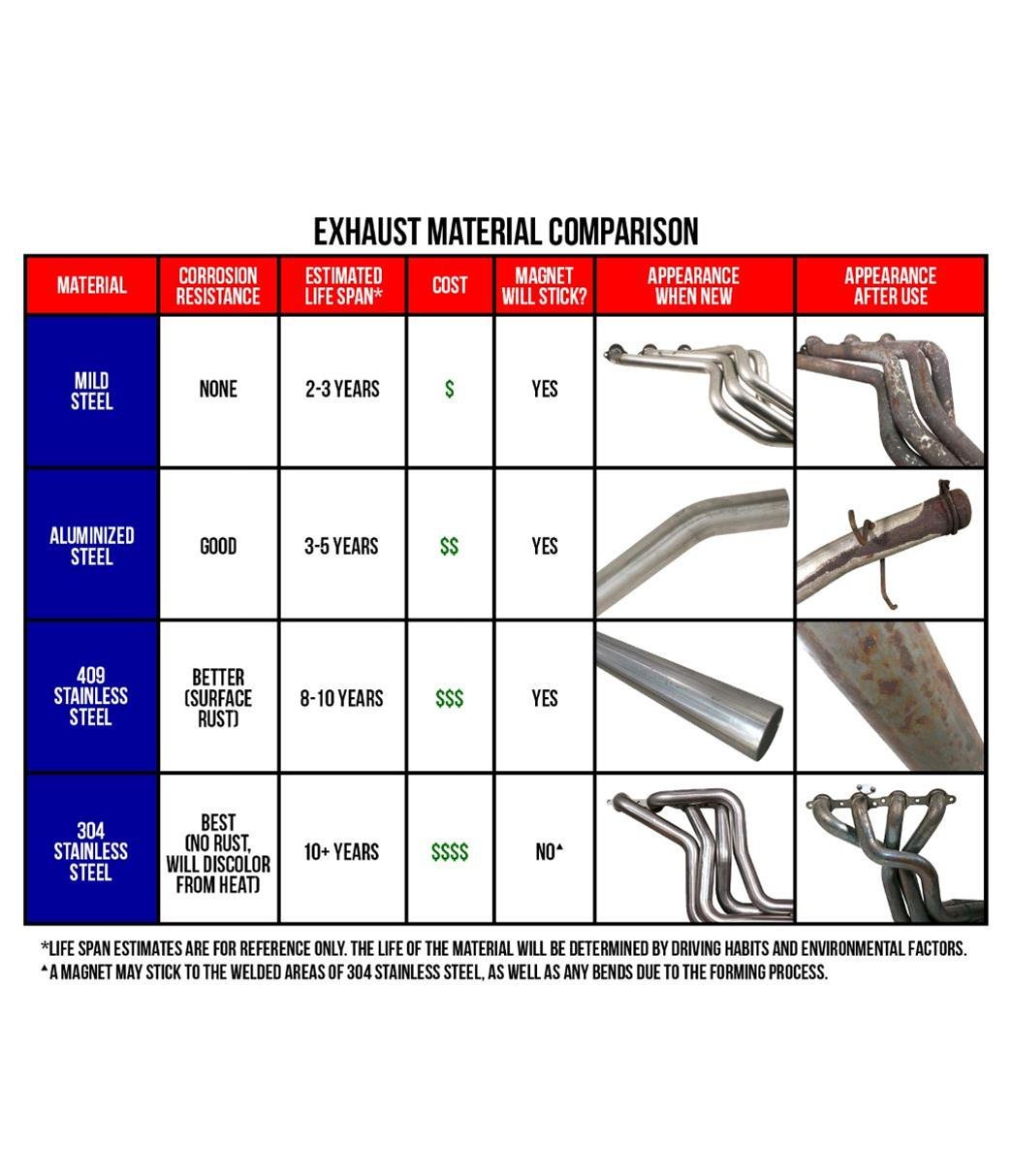

    I installed the TRD cat-back kit years ago. I take it that it is no longer available. Borla makes good stuff, I have their cat back on my Jeep. Whatever you buy, just make sure it is 304 alloy.
