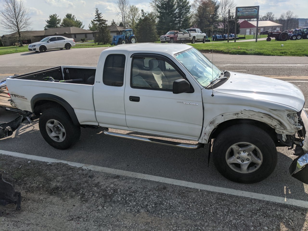

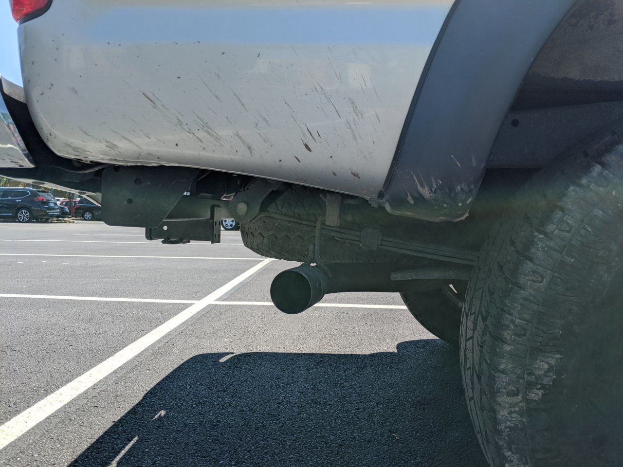

    I found an '04 4x4 Xtracab V6 automatic this past Friday. 214,500 miles. Has had the frame replaced as part of the recall. Really good condition, except after I bought it I noticed from the side that the bed doesn't seem to sit at the same angle as the cab. The bed seems "flatter" compared to the cab I guess. Also, when standing behind the truck the bed rail on the driver's side seems a bit lower than the passenger side (I don't have a picture of that at the moment unfortunately).

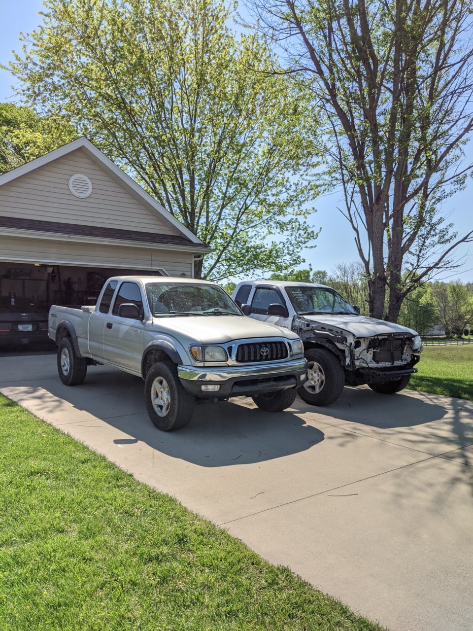

    In the attached photo, it's sitting beside my totaled '03 and if you look closely, the bed rails on the '03 sit slightly higher than the '04.
    It rides incredibly rough over bumps. Much worse than my '03. If you hit a bad enough bump or rough bridge at 75-80 (on the interstate), it feels unstable like the wheels temporarily lose contact with the road. thinking it could be the leaf springs needing replaced, but they look new with no rust or anything. I suppose it could also need shocks and/or struts but I really know nothing about suspensions.
    Bonus question, what would you do with the wrecked '03? Engine needs valve covers replaced eventually, but they're not leaking too badly yet. Passenger rear strut was bent in the wreck so it would need replaced. Probably needs an alignment because the front passenger tire got whacked during the accident. Body damage is about $7k done right, or $4k patched back together good enough to drive. Previous owner had recently replaced shocks, brakes, alternator, water pump, timing belt, plugs,a wires and some pulley under the hood that was squeaking. It was really great for 231,500 miles so I hate to scrap it. Insurance wants $1,360 for me to retain the vehicle.

    Hmmm, as far as the new one goes, if the bed isn't sitting right it shard to tell why from these pictures. I'd want to look at the mounts for the bed and see that they're right to the frame and not damaged.

    The bed not riding at the same height is likely worn leaf springs. But feeling unstable at speed I would think would be more likely to be in the front end. I would check to see if you have a sway bar, and if the sway bar is connected, and also would check LCA bushings.
    Would be curious to see some more pictures of the totaled one.

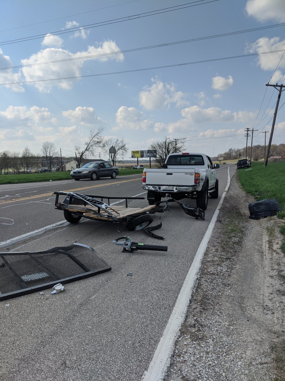

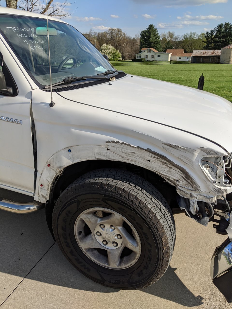

    Hope you're alright! I thought your first pictures showed a lot of front end damage considering you were rear ended. Looks like your trailer absorbed a lot of the impact.

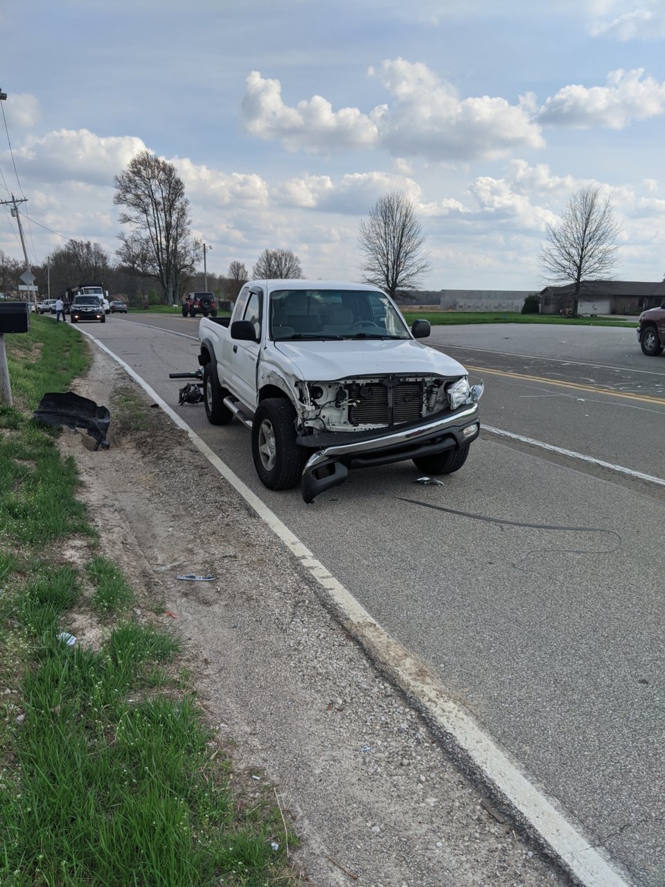

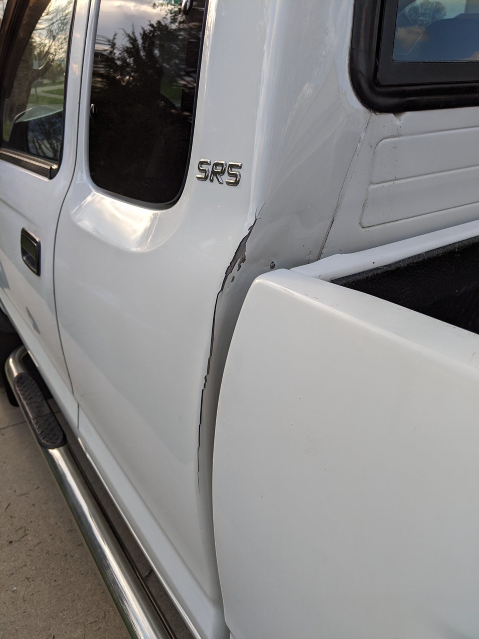

    Yeah my friend's 13yo son was with me so that was the scariest part, but neither of us were seriously injured thankfully. The trailer did take the brunt of it, but he still hit the bed hard enough that it put the dent in the rear of the cab on the driver's side. Then he pulled it back left and did a number on the front passenger fender and tore the front off, too.

    No he swerved right to try to avoid us and just caught the rear passenger corner. But I think he was about to hit a mailbox or go in a ditch or something and tried to get back on the road which is when he tore the front up. He managed to get stopped about 200 feet down the road after he went around me. Wasn't too nice or apologetic about any of it.

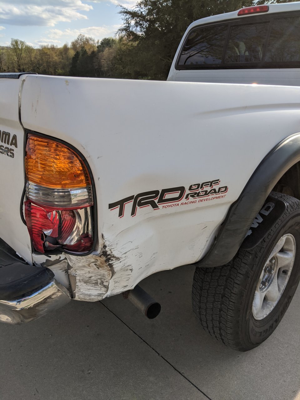

    It might make sense, especially if you fix most of it yourself. Needs a new fender, headlights, grille, taillights, leaf springs and rear shocks from what I can see. I bet you could source all of that for around $1000. Get a body shop to bang that rear bed corner out so you can fit the tail light, give that corner some white touch up paint. It wouldn't be perfect but I bet you could sell it for at least 4k at that point.
