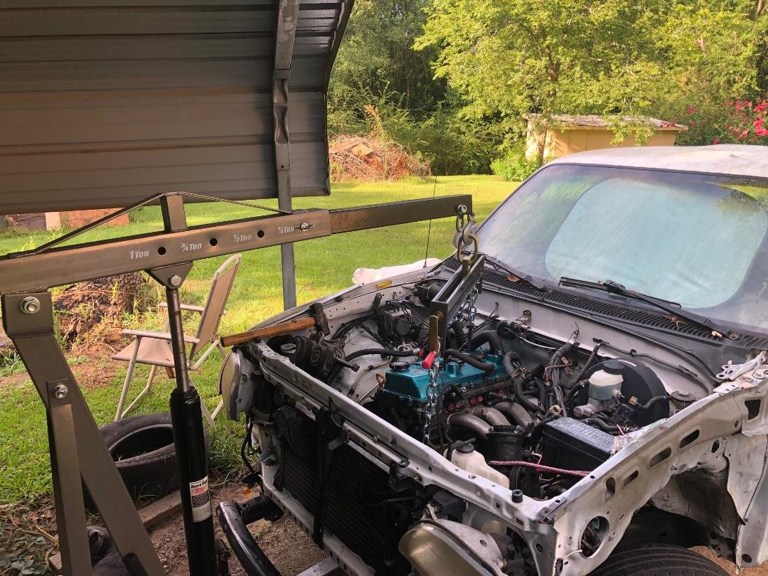

    I got both motor mounts secure, and bolted into place this morning. It just had one holding it yesterday. Manual says it has to be level. So great! I get to try out my new leveler! What I had to do was loosen the 2 bolts on either side of the mount, where it attaches to the frame. I had to remove one bolt on the right side, so I could align the center, main bolt, then pry, and shift the engine to a point where the last bolt went in.
    I spent some time arranging wire cables, and planning my next move.

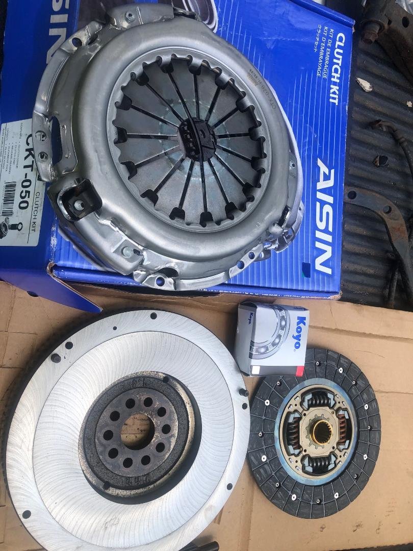

    Just got the flywheel back from the machine shop. Turned down nicely.
    Getting ready to put the clutch, pressure plate, and throw out bearing, the bearing in the back of the engine and a new rear main seal.

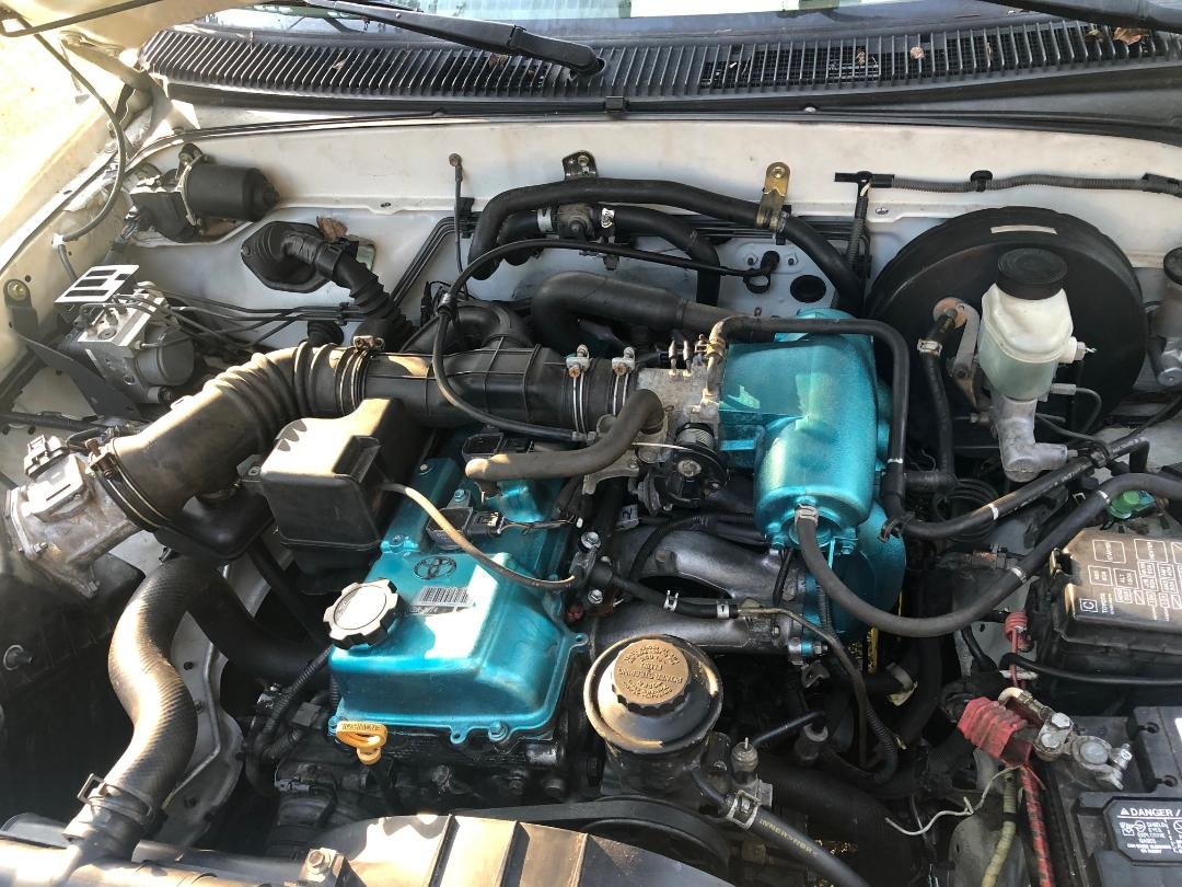

    The engine is back in the truck, and seems to be running okay. Smooth idle. No warning lights. Happy, happy me.

    Should slide that clamp on the fuel return hose back up, its not currently hanging onto the regulator.

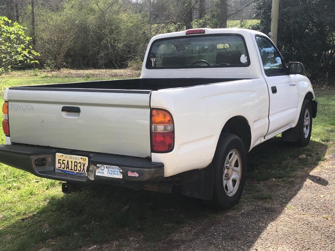

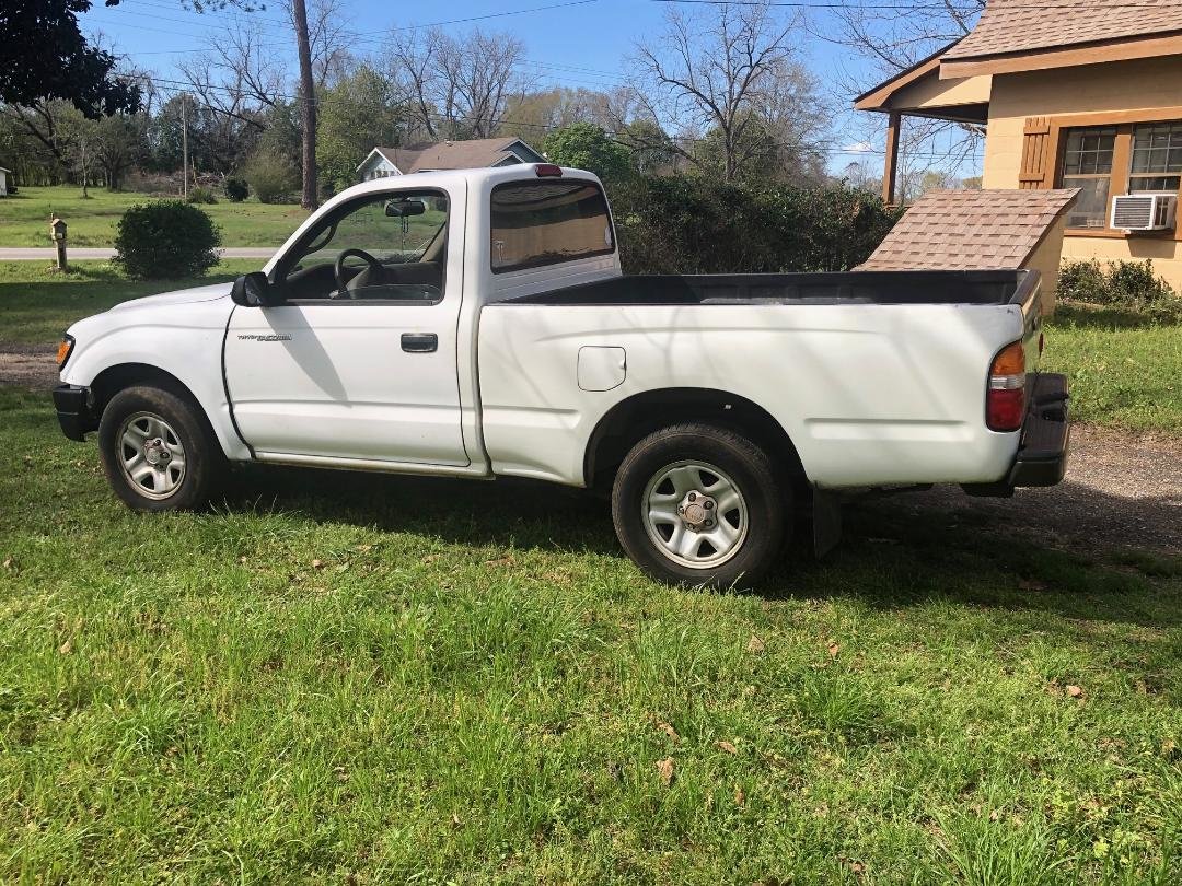

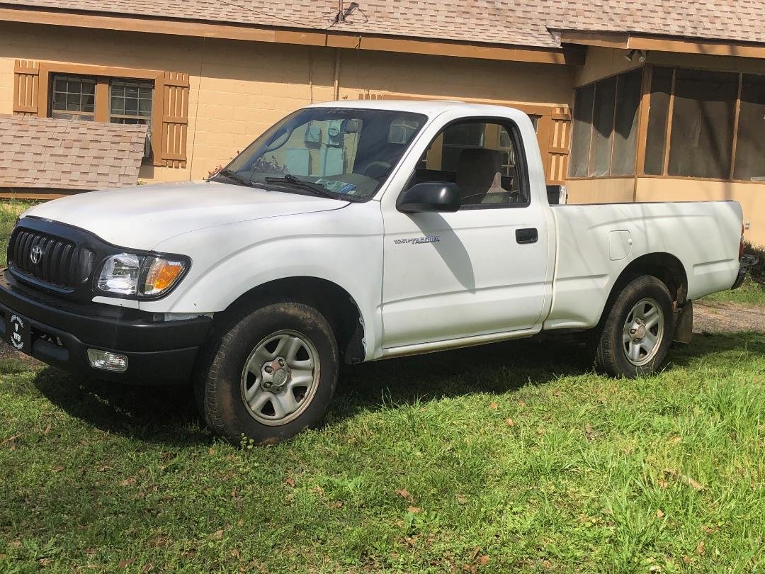

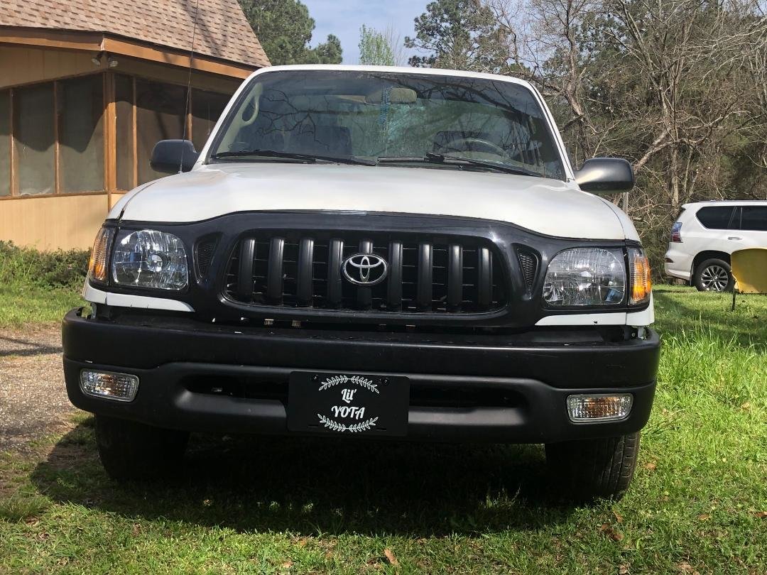

    I guess the project is winding down. Well, not really. i still want to get some new tires and replace the solid back glass with the sliding version out of the donor truck. Maybe upgrade the sound system.

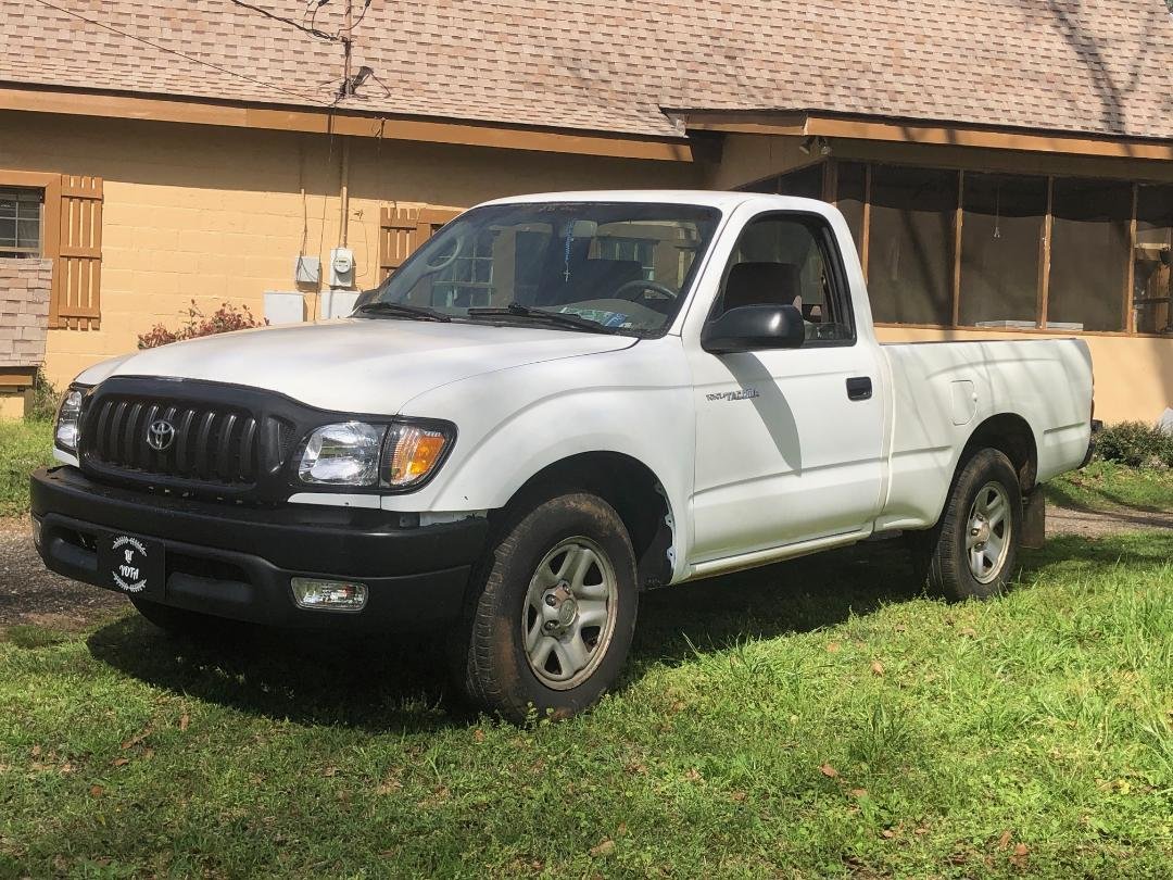

    Anyway, here is what I have been working on. New grill. New bumper. New lights and all fixtures. New LF fender. All the suspension stuff under the LF side is new. I had to get the frame pulled, then a complete wheel alignment. I ready to ride! What do you think?

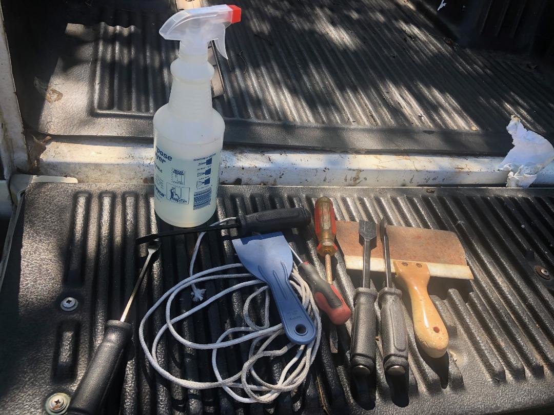

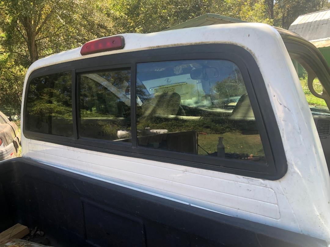

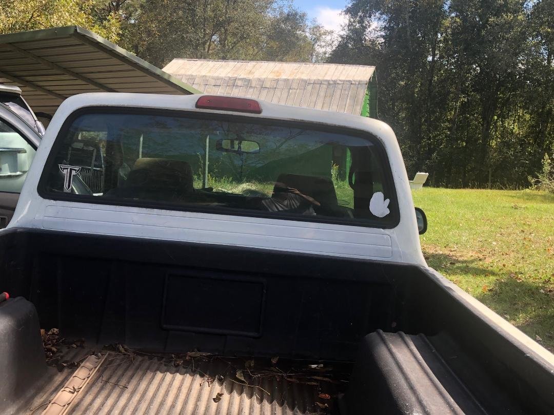

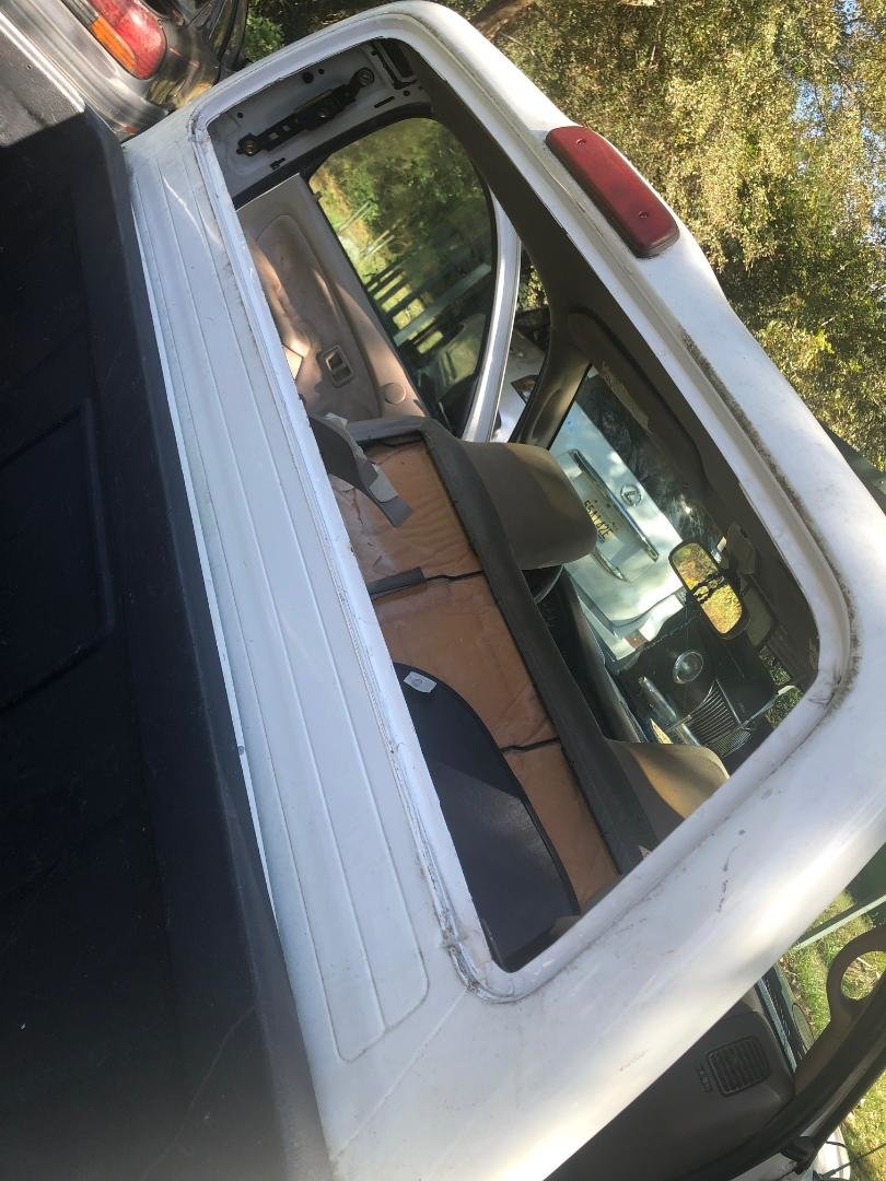

    I changed the rear glass out over the weekend in my 04 Taco. It wasn't to bad of a job. I needed a pic tool to get the rubber seal over the pinch weld on the window frame. Important tip. Lift the window up into the upper first, due to the shape of the window, then work the sides and bottom. I used a 3/16 soft cotton rope to pull the rubber around. The new window opens. (hooray)and is tented from Toyota. You don't see these windows on a base cab truck. Must be a custom jobby!!!!
