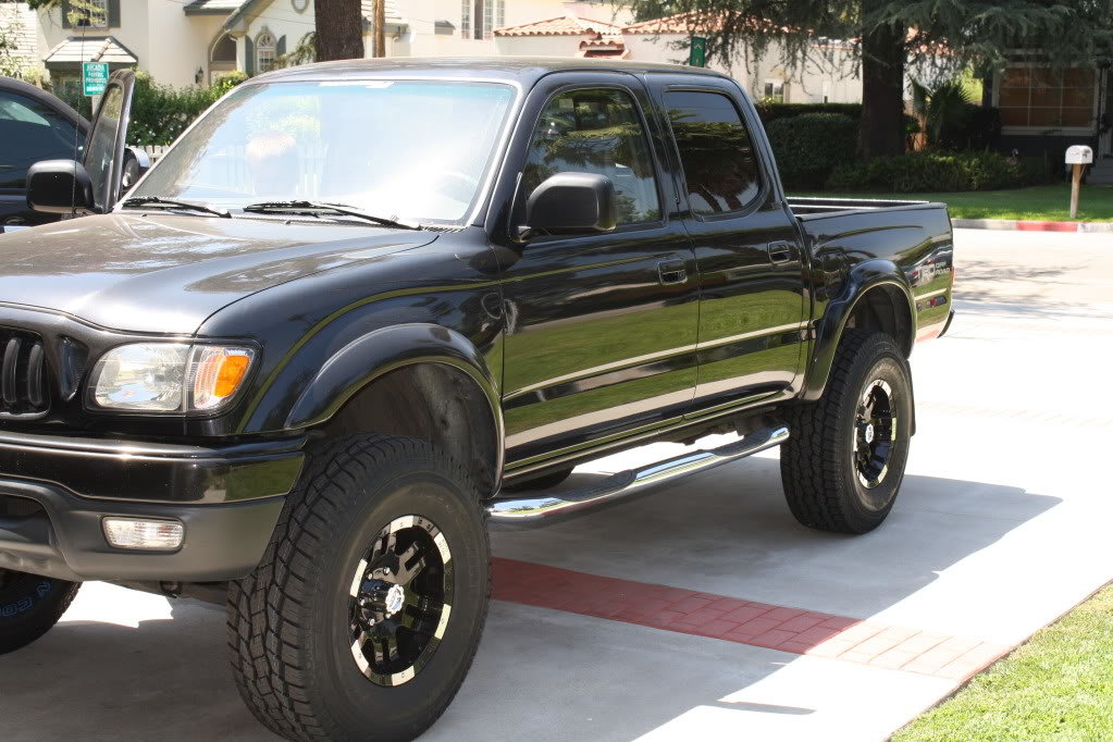

    the size I would recommend is 265/75/16 its basically a 31" tire. you won't rub much and it will be somewhat proportionate. i have a 3" lift and 32's but a similar truck:

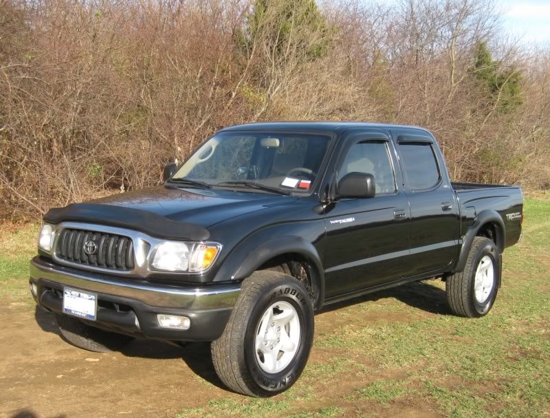

    This is what 265 70R16 look like on a factory wheel without any lift:
    If you don't mind how the factory wheels look just get some larger tires. If you don't have to change the fit (I don't think you do) there's no reason to change out the wheels.
