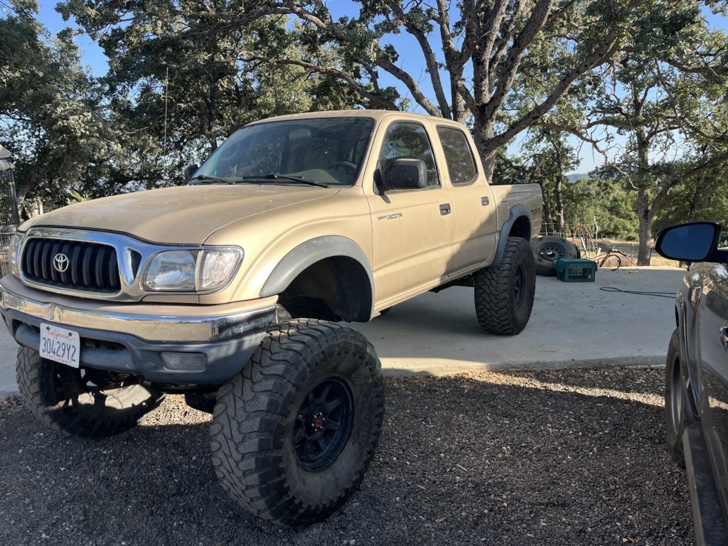

    I’ll get this thing done…

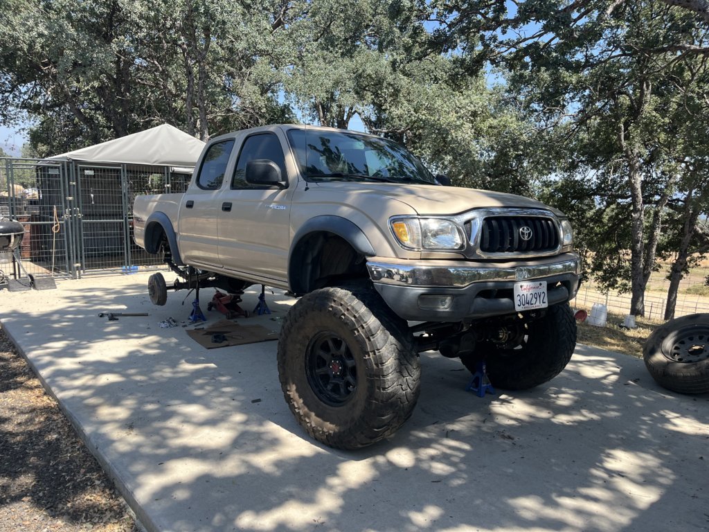

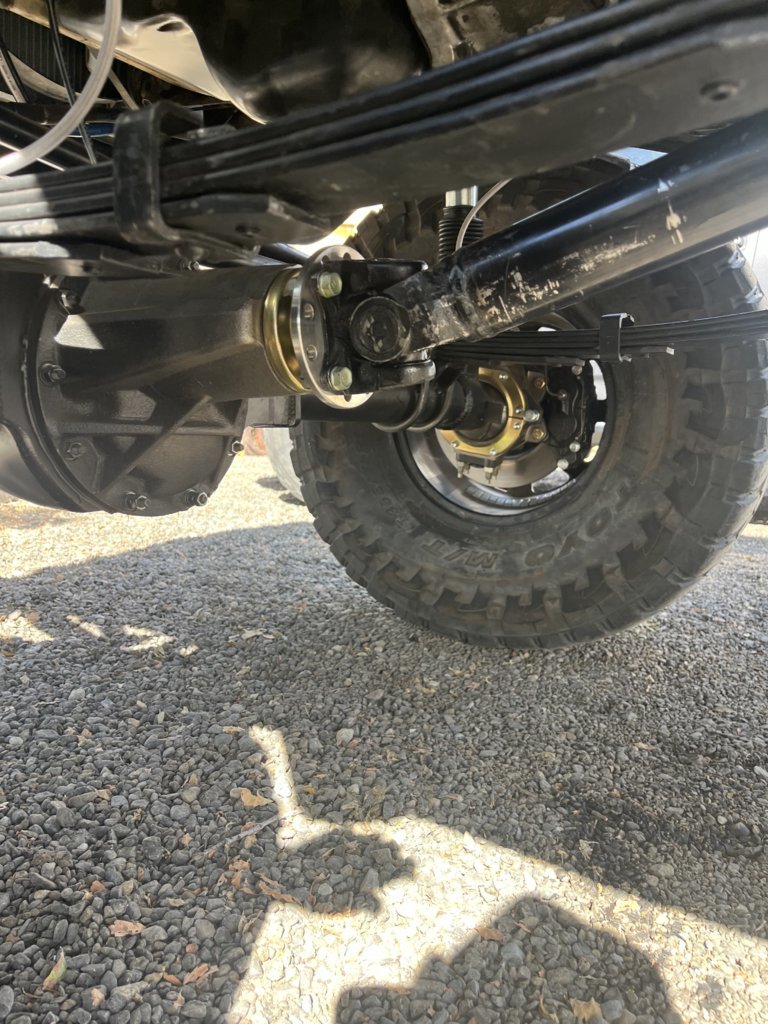

    Tonight I installed the rear differential, had 4.88 gears installed, as well as installed the new front drive shaft, bought a decent one from a friend then, had driveline service machine the Cardan and install a 16.25 long spline, sick one, decent price.
    Got the 37s on, semi bled the brakes, need more fluid, the took it for a cruise, not bad, needs some minor trimming.
    Tomorrow I’ll get fluid and install new rear shocks. As of now, she sits at 26.75 in the front and 26.5 in the rear.

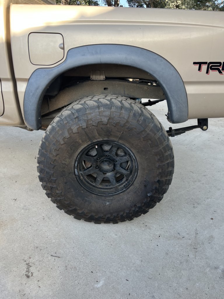

    79

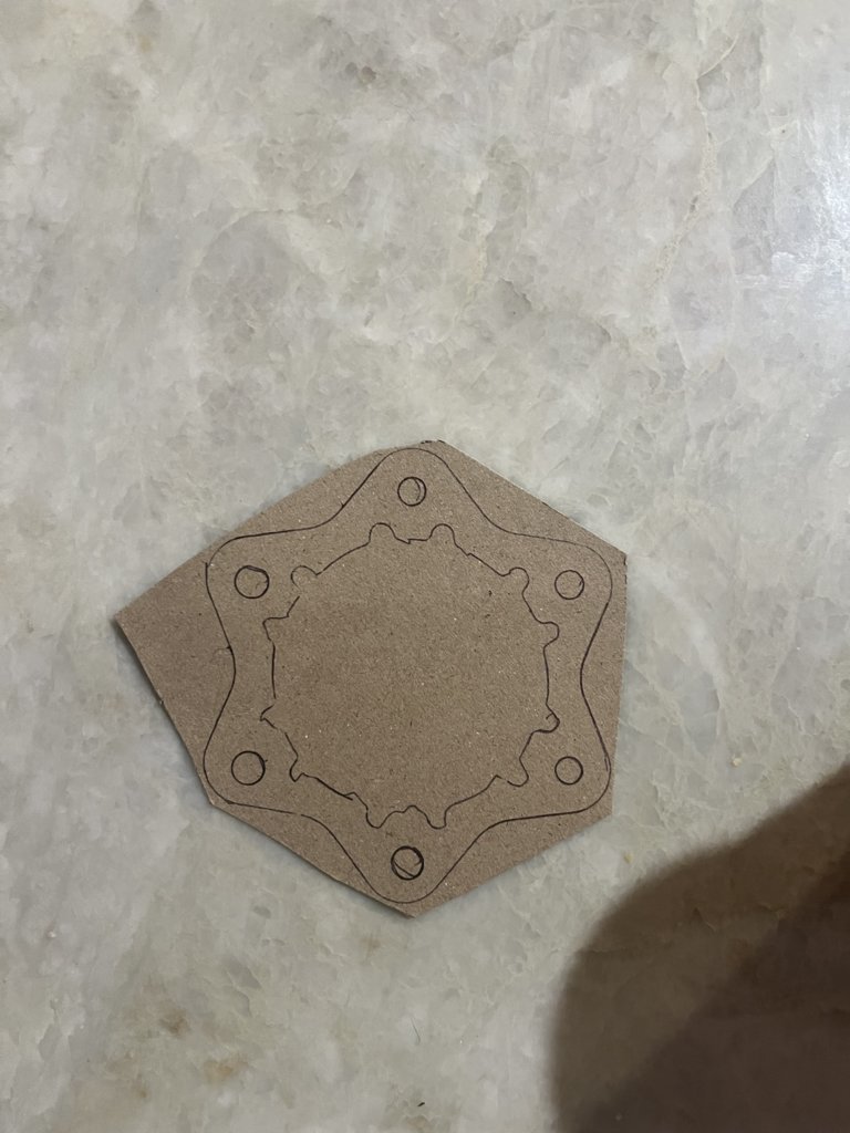

    Made some gaskets out of a beer box, stacked a couple to fix my dial issues, seemed to work.
    Gonna try some out of leather so I can keep reusing them, instead of tearing the things up everytime I gotta get in there.

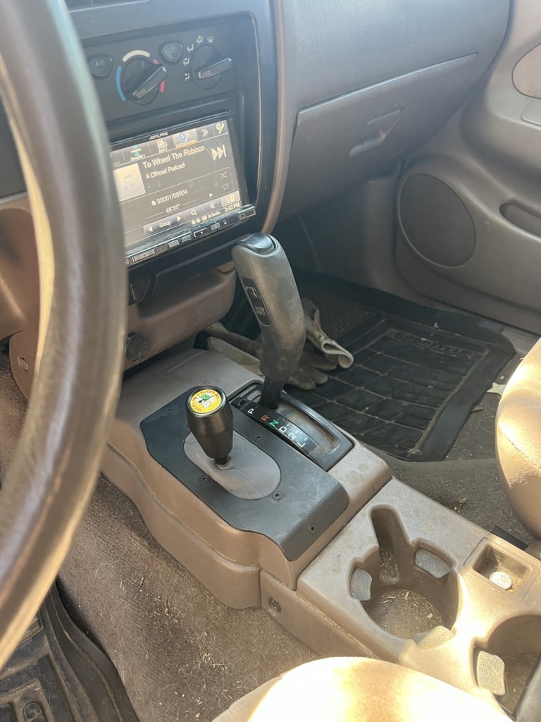

    79
