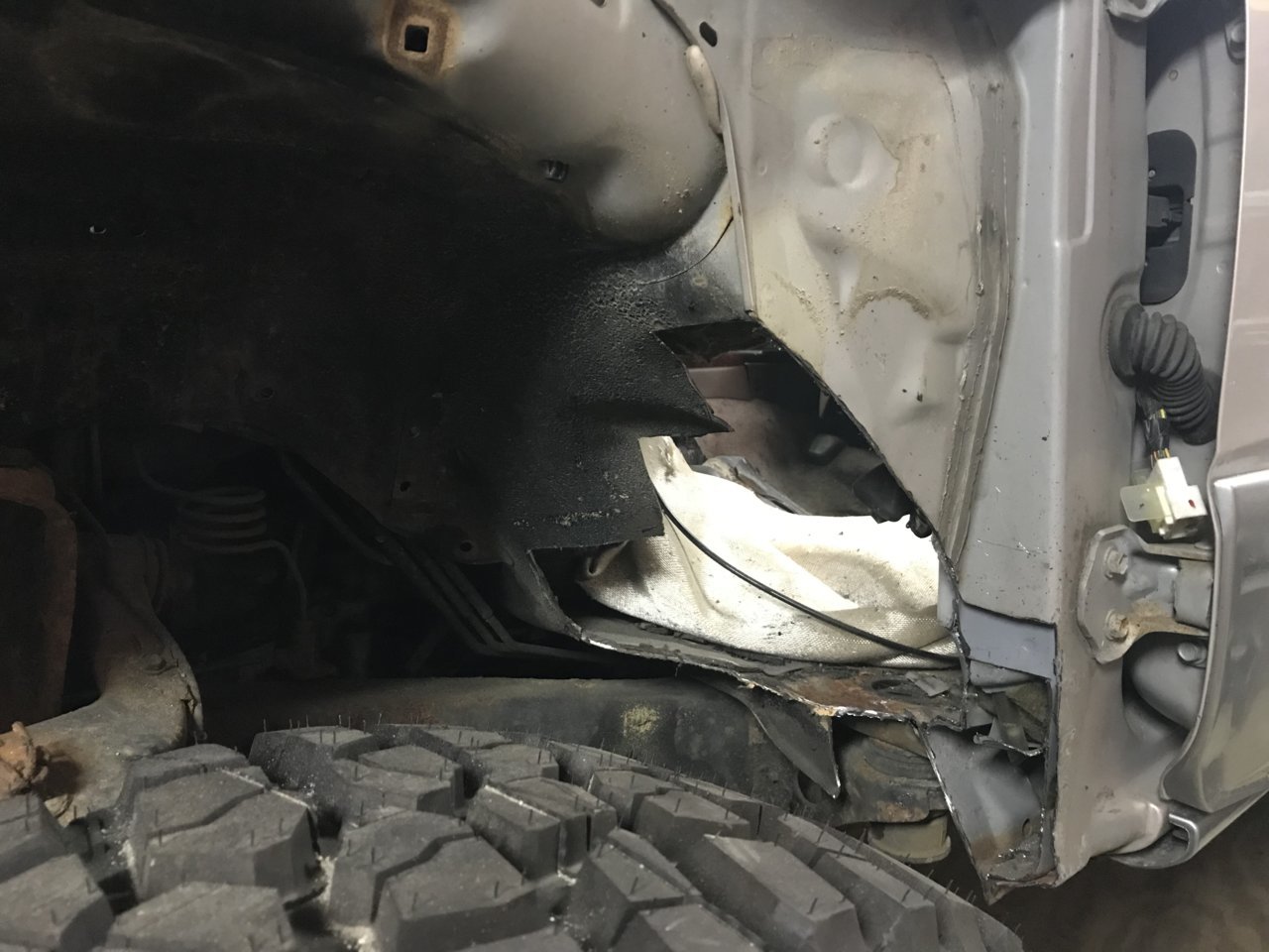

    So you had to push the axle that far forward to avoid the oil pan? Looks like a lot with have to be clearanced to clear the tires in the fender?

    Oil pan is 1 reason. I didn't want to mess with the firewall any. So I set the axle to a distance that gave me an appropriate amount of clearance, and it just so happens to be a good amount of clearance for the oil pan as well

    Having a Diamond axle and 3 link, I gained 2.75" of WB when I did my SAC. The pan was the reason for most of the WB gain and this is after I purchased a reverse sump pan and pick up tube.

    I gained a little less than 5". I was really hoping to gain less because of how much more work needed to clear fenders. But having a low ride height poses a lot of problems

    My axle is 62" WMS so I didn't need to cut anything firewall related. The OEM pinch weld and plastic cover are still in tact.

    Firewall tub kind of sucked but fitting 35s on less than 2” lift it was work that had to be done. I keep going back and forth on it I want to do the swap or not. I should just take that time to get my Tacoma back together, especially since it’s been apart for 8 years.
