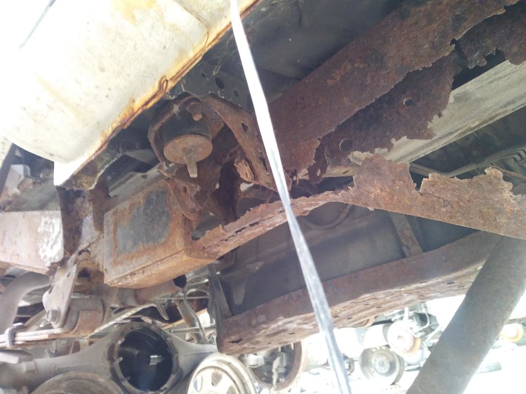

  6. Sep 18, 2019 at 5:14 PM
    Zurovetz
    Zurovetz [OP] Member
    Sep 18, 2019
    #305672
    5
    Here is a pic

  8. Sep 18, 2019 at 5:22 PM
    Blue92
    Blue92 Well-Known Member
    Aug 26, 2017
    #228071
    16,471
    Daniel
    North Carolina
    2018 Sport
    Thats beyond rust. Thats full blown disintegration.

  9. Sep 18, 2019 at 6:20 PM
    Black DOG Lila
    Black DOG Lila Well-Known Member
    Jun 14, 2019
    #296344
    9,116
    Virginia
    2003 Tacoma SR5 2.7 5 speed 4WD
    Stock. EZ pass.Dump pass.Inspection sticker.Convict printed lic.plates.FG cap.
    Looks like it was CRC coated as required by Toyota to get 15 year extended warranty against frame rust perforation. Thats 15 years from the put in service date. You may still have time to get a new frame but hurry up and check your date.

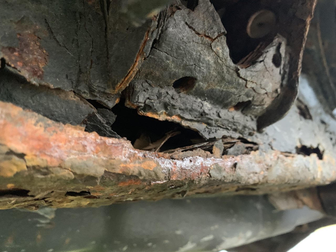

  11. Sep 18, 2019 at 7:28 PM
    GQ7227
    GQ7227 mw survivor
    Dec 6, 2018
    #275019
    29,298
    J A Y
    this is full blown disintegration that was still on the roads here a few months ago
    my state is not a cold climate winter state with problems per Toyota...

    The most important thing you do today is start the recall process, if you are within the 15yr period and the vehicle was treated for rustproofing by Toyota (they have a record by VIN if it was) then you have won the lottery. Use this link to start the process, you will get a case number and call back number:
