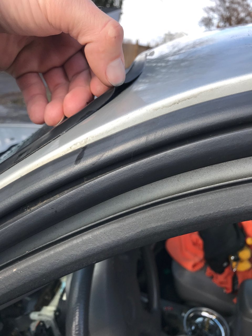

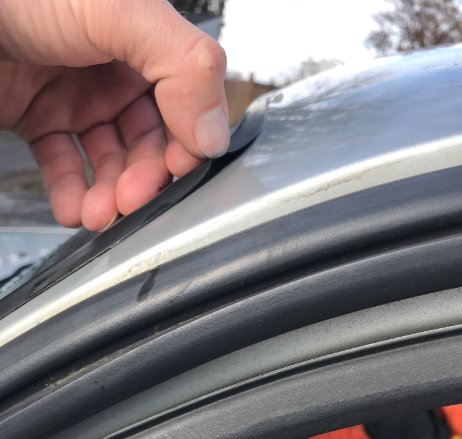

    I found where the water was entering the cab. After pouring about a gallon of water across the the bottom of the windshield trying to replicate the leak I turned my attention to the top of the windshield. I found a small gap under the windshield perimeter trim and poured some water on it and water started flowing down the inside of the dash and onto the body ECU. I tested a few other spots but only replicated the leak in this one spot. I guess the windshield glue has a gap in it? Not exactly sure how that's all put together. Anyway I put some heavy duty sealant in the gap, down the side of the windshield, and across the top under the trim and wiped away the excess. Had a good rain last night and when i checked this morning everything was bone dry! I suppose that's good enough of a band-aid for now!
    Thanks for the suggestions everyone!
