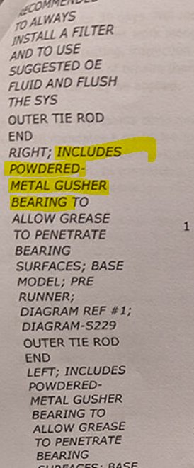

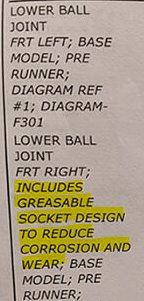

    @OP:
    This means they are not Toyota OEM parts. Don't let them try to tell you they are OEM equivalent or better because they are greaseable.

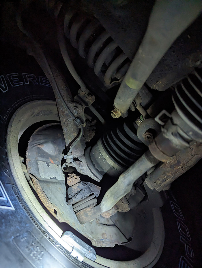

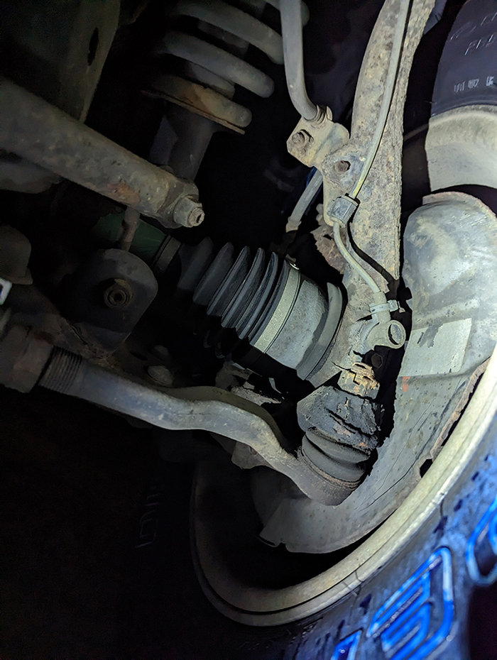

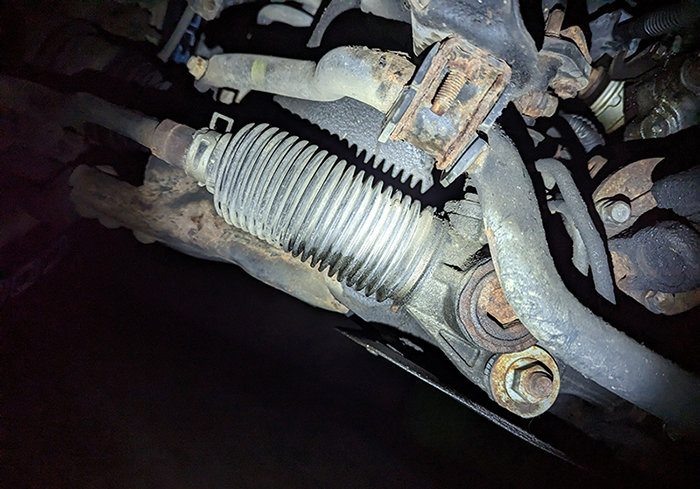

    Yea, most of the truck's life has been in Michigan and New Hampshire so ungodly amounts of snow, salt, etc. I found this https://toyotaparts.mcgeorgetoyota....meT0yMDA0JnQ9cHJlLXJ1bm5lciZlPTMtNGwtdjYtZ2Fz but it's discontinued so I have no clue what all parts I'd need to buy. Found https://toyotaparts.mcgeorgetoyota.com/oem-parts/toyota-steering-gear-4425035042 but does that come with tie rods and everything else I need? I think I'll just take my truck to the local mechanic and have him look at it. I don't have the space/time/knowledge to attempt this type of job.
    Just took some pics, I'm gonna assume all those wet spots aren't normal:

    Still lots of options.....your lucky these were used on a ton of vehicles....
    Fit for
    1996 - 2002 Toyota 4Runner All Models
    1995 - 1997 Toyota Tacoma 4WD All Models
    1998 - 2004 Toyota Tacoma 4WD and 2.7, 3.4 Liters
    1998 - 2004 Toyota Tacoma 2WD and 2.7 Liters
    1998 - 2004 Toyota Tacoma 2WD and 3.4 Liters and Pre-runner
    OEM Number
    4420035013, 44200-35013、4425035042, 4425035041

    That's where I bought my new rack maybe 18 months ago, cost $525+ if I remember right. Crazy it's actually gotten cheaper
