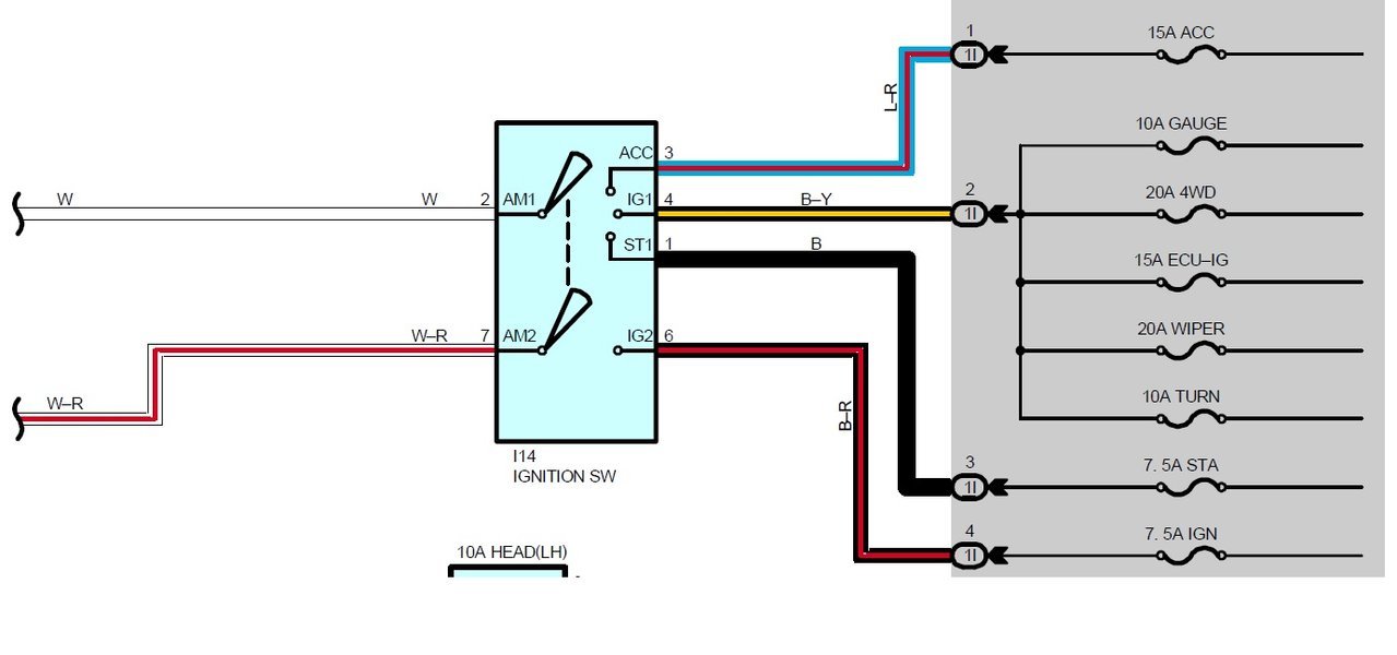

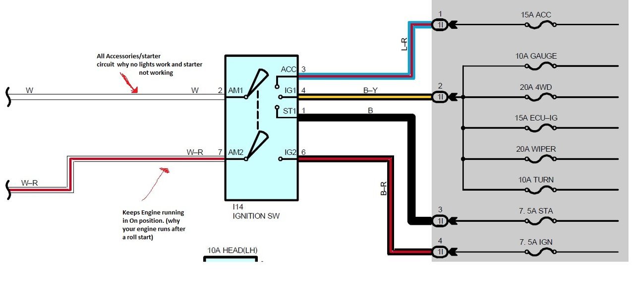

    These trucks have 2 Ignition leads. It could be potentially that you are having issues with the White lead while the white/red lead is fine which is to keep the engine running after starting. The white lead is what provides power to the Accessory circuit, and starter.

    This May help as well. See attached
    Look at Items AM1 and AM2.
    AM1=40amp Fuse for your White (Start/ACC) Ignition Wire
    AM2=30AMp Fuse for your White/Red (Running) Ignition Wire
    Help you narrow down possibilities.
