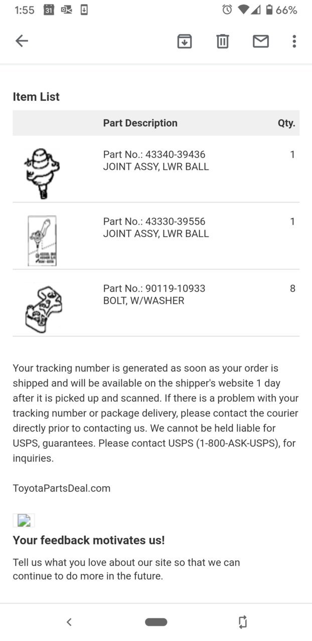

    01 - 04 LBJs have a different part number than the 1995.5 - 2000 LBJs. They are the same except the early ones come with bolts and the later ones do not. I suspect this is because the later models have the dust boot that attaches via 2 of the LBJ bolts, I'm not sure.
    I have an 04 as well and this is what I used last time I did them
    btw I don't recommend ordering from ToyotaPartsDeal, if they mess up your order they are virtually impossible to deal with (didn't happen to me but has happened to others).

  5. May 25, 2021 at 10:07 AM
    eon_blue
    Mar 4, 2016
    #180213
    69,762
    Azusa, CA
    ^^^ and to add to this, my dust boot broke off on one side and I didn't attach it back on when installing my new LBJ. As a result (I think), one of the bolts snapped when I was torquing it to 59 ft/lbs. I think the dust boot cover effectively shortens the 2 bolts that it attaches with, and without it you risk breaking a bolt off in the spindle. It was a pain in the ass to remove the broken half of that bolt.
    Just my .2c, maybe I just got a bad bolt but I ended up putting the broken dust boot cover back on and the 2nd set of bolts when in perfectly without issue.
