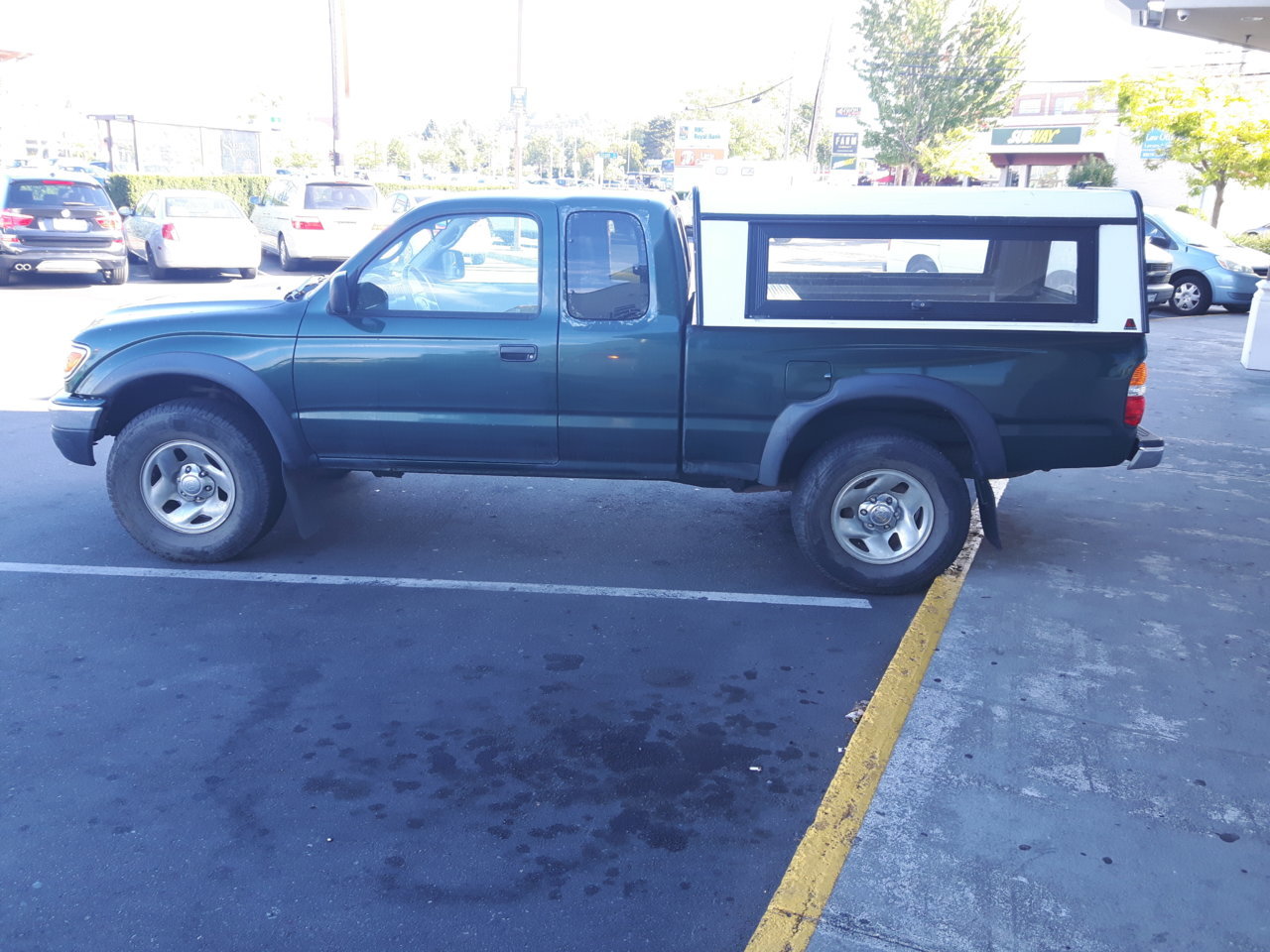

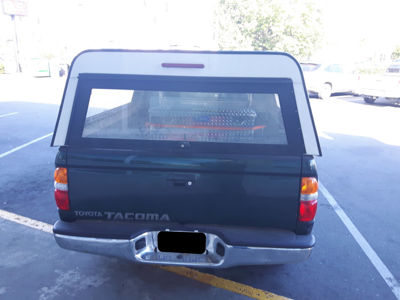

    I got my truck a couple of years back, and recently I've decided it would be fun to start modifying it, making it more my own, and maybe a little unique. This threat will chronicle my struggles and help keep my ideas all in one place.

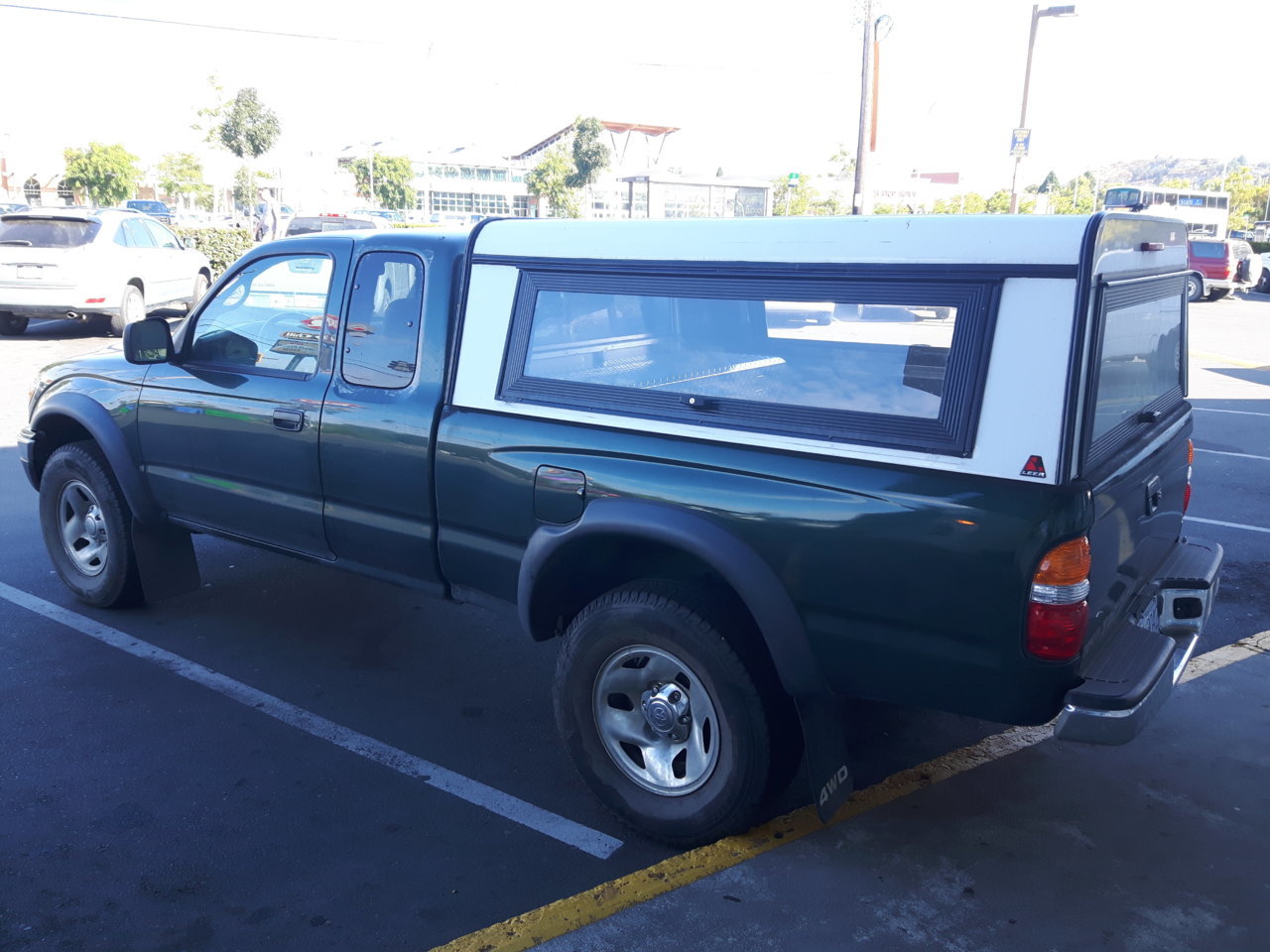

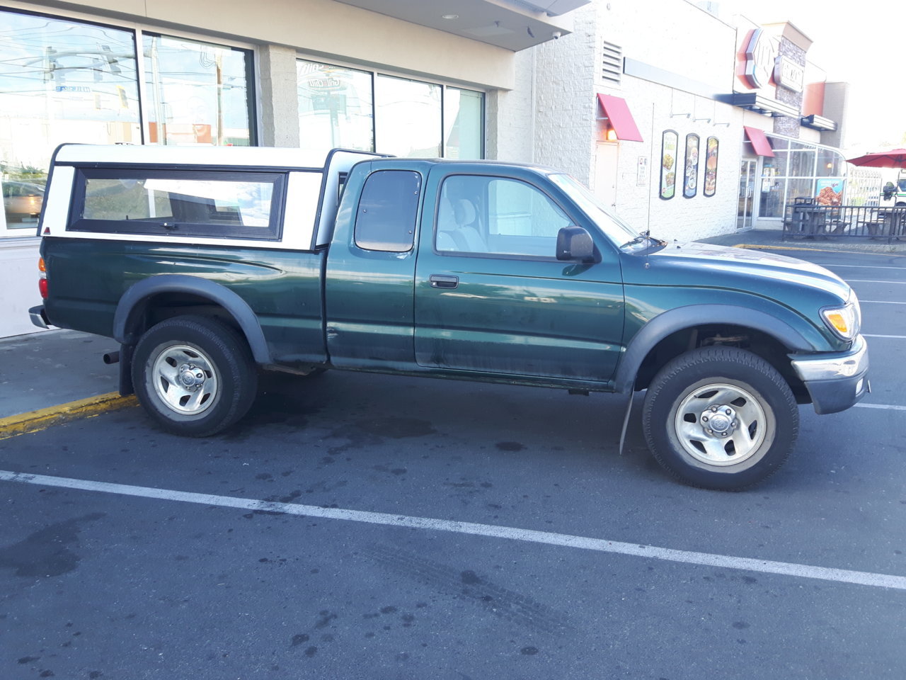

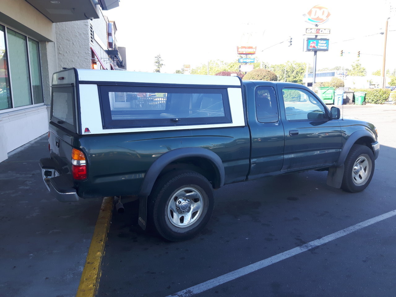

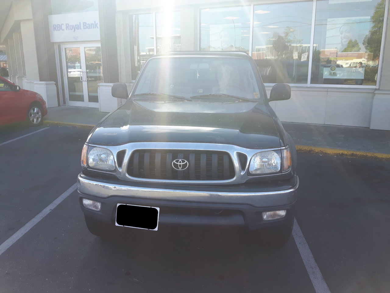

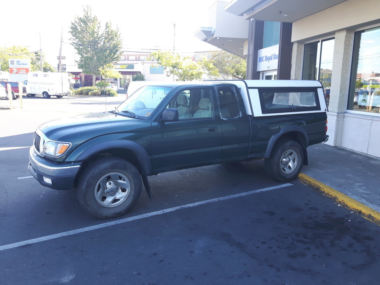

    Starting off with some pictures of before I did anything. Truck was stock when I bought it as far as I can tell, and all I added was a hard shell and a toolbox in the back.

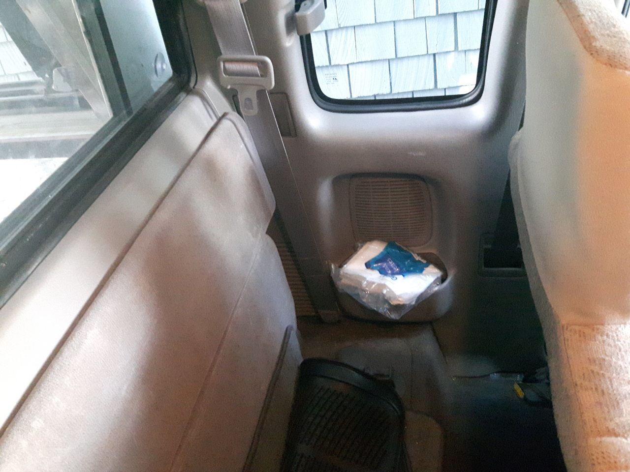

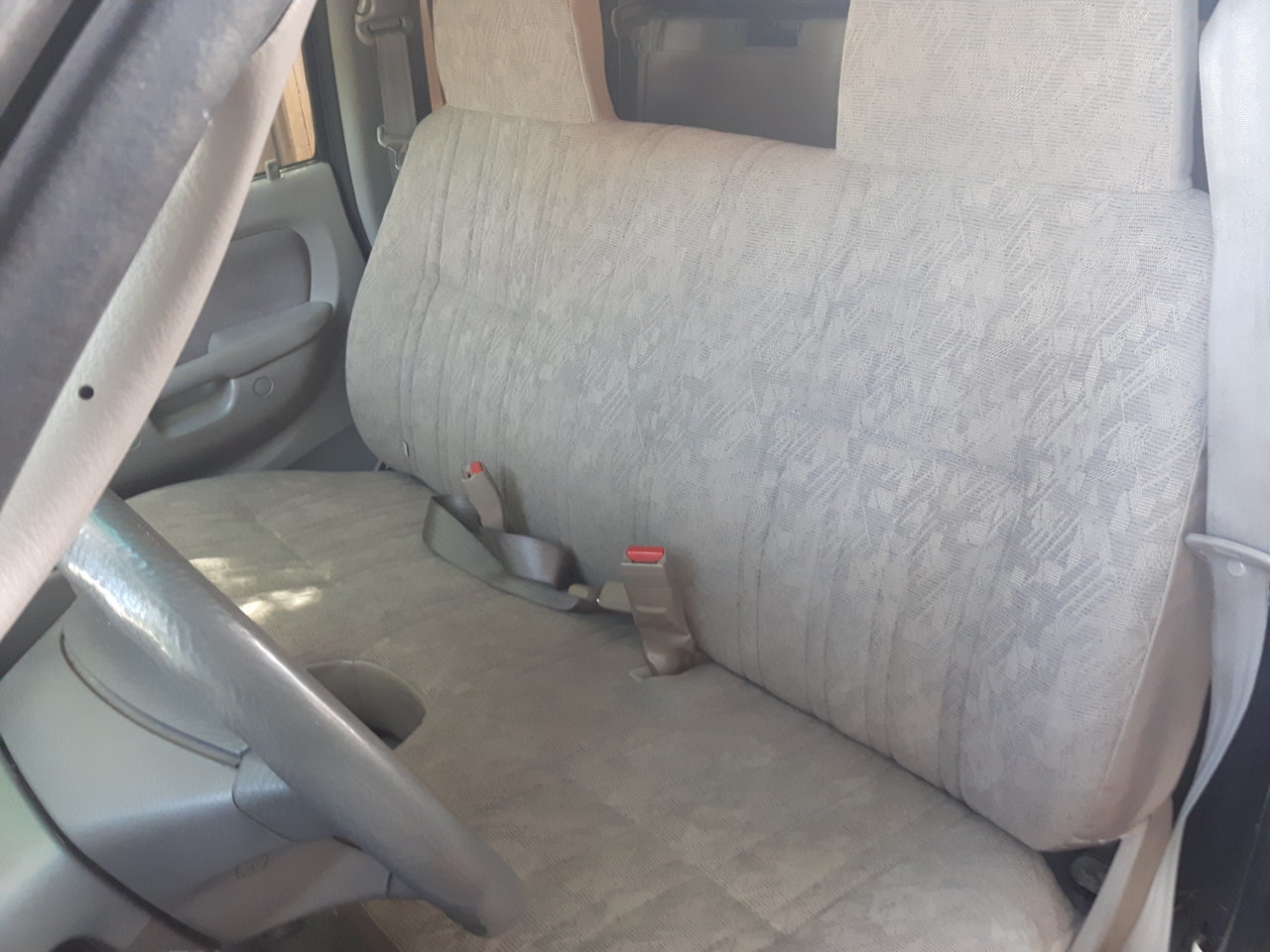

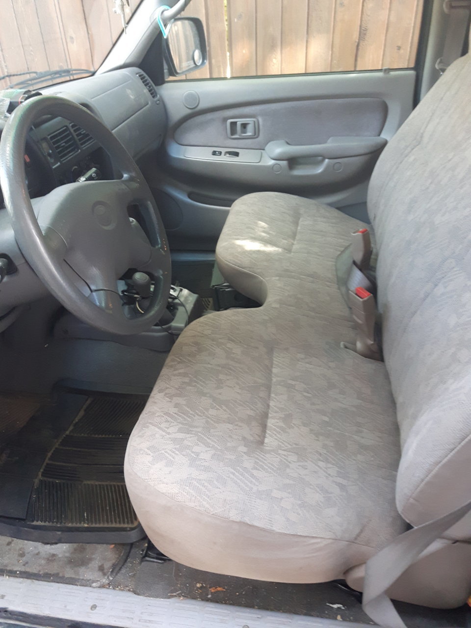

    Next up is my new bench seat. Cost more than I wanted it to, but I'm really happy with the results. Back seat is about the same size, but the bench does sit a little more forward than the buckets did. Loss of the center console is temporarily fixed by an ammo can wedged under the passenger's side, between the seat and a ridge on the floor. Stays pretty good aside from panic braking, not sure how well it will stay off road, but I'll find that out in a couple weeks. The loss of the cup holders isn't fun, but I'm working on a solution, just waiting on my new cup holders to show up from Amazon before I can give that a try. Probably going to bolt them to the side of the shifter boot.

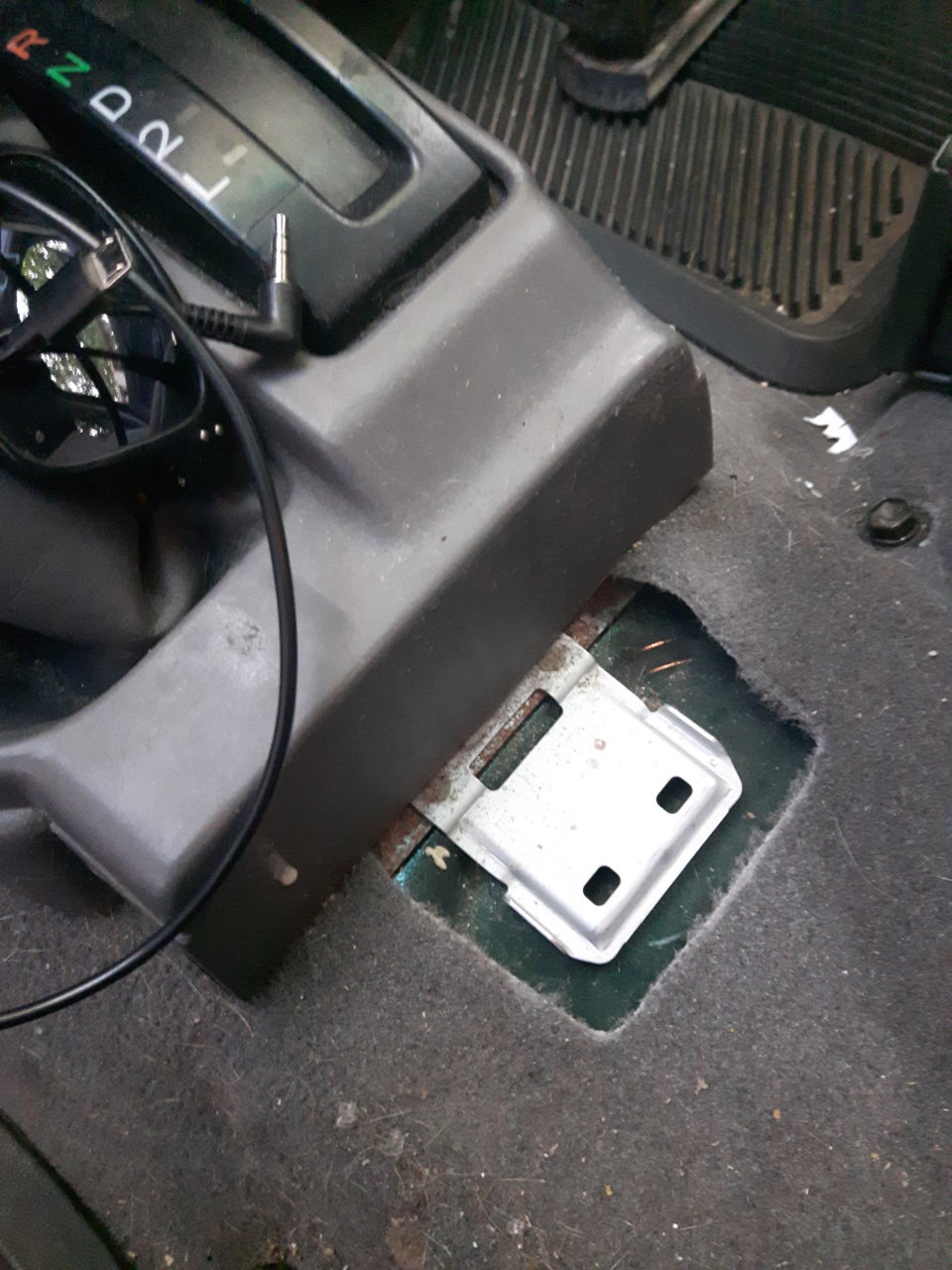

    Now I've got a bracket poking out just behind the shifter boot, looks like it was probably supporting the cup holders or something when I still had those. Any ideas what to do with it? Might be able to bolt a new cup holder to it or something, let me know if you have any ideas!

    Also that metal tab can be used for another cupholder for a total of three. I don’t have a pic.
