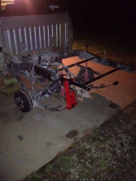

    Tacoma based buggy
    working on installing all this right now.

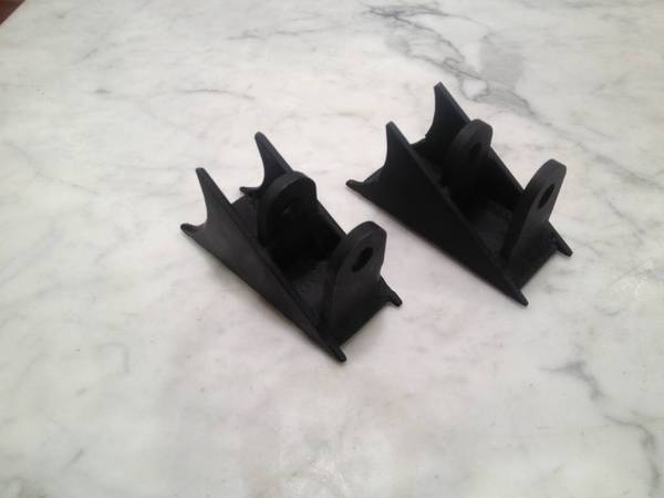

    bumps, spring perches, poly lca bushings, bpv, 12” shackles, ruffstuff shackle bushings, new cv, front limit straps, front wheel bearings (for the second time), and new shock tabs (gonna try to get a lil bit more travel out of the rear when i put on the new shackles). iv also got a nice pile of metal that im using to plate the lca double sheer the uca, and gusset the cam tabs.

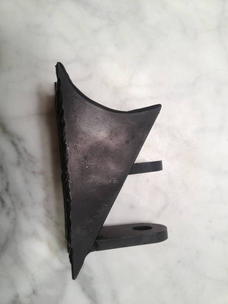

    started working on my LCAs, making an area for the hydro bumps to contact. i wanted to do it in front of the axle thinking i may add a secondary shock in the future. but anyways this is what iv got done so far, not done yet ill be adding more gussets to the underside.
    first built it out of cardboard just to get an idea of how i was going to make it
    then out of 3/16 plate

    i think finished up the strike pad for the bumps, i may beef it up a little bit more.

    do you have a pic of the top? Did you run the stike over the top of the arm or just weld it to the side?

    It's just welded to the side. Never crossed my mind to overlap it, might of been the stronger way to go.

    Im sure it will be fine. I would just watch that the pad doesnt start cracking the arm at the weld.

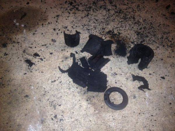

    removed the LCA bushings to put in the new energy suspension poly bushings, and i was a freaking pain in the ass.
    left this crap all over the driveway

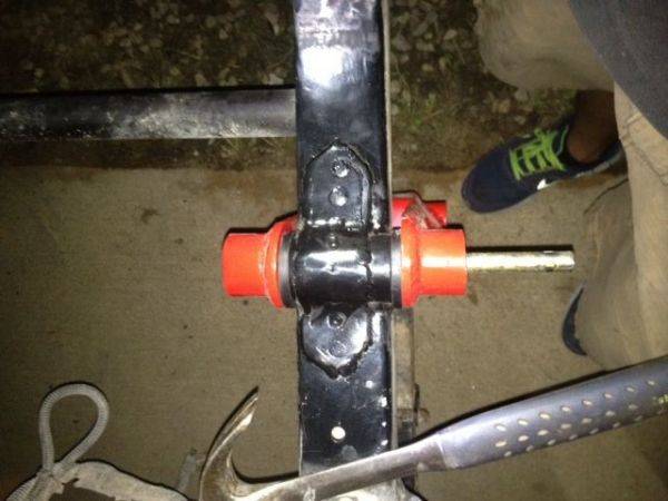

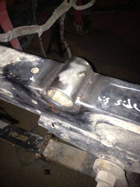

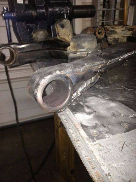

    iv seen some pics of second gen LCAs failing at bushing sleeve (never seen it on a first gen tho) but i figured id rather be safe then sorry so i went ahead and ran a pice 1 1/8 x 1/8 around the sleeve.

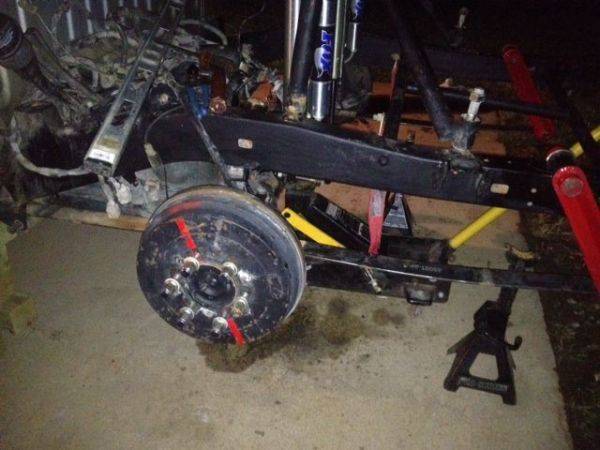

    did some work on the rear

    getting there...

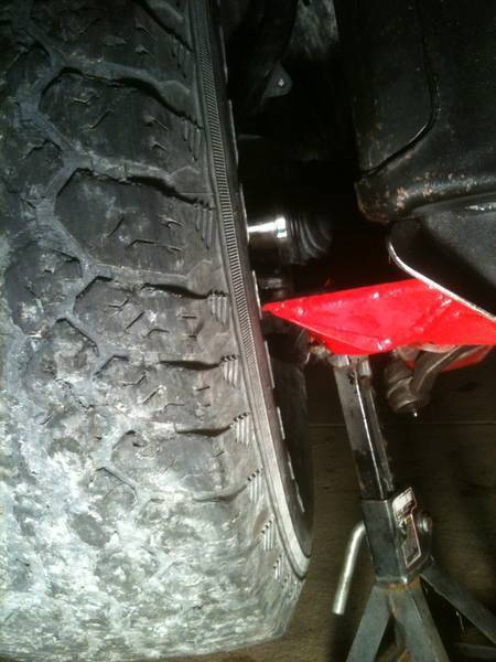

    what a fail on my part, cant believe i completely over looked this when i was building my LCAs
    should clear if i run a 1.5” wheel spacer and trim the pad a little bit...hopefully
