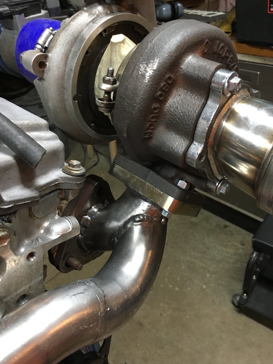

    Got any more details on the CXRacing turbo kit? You said it didn't line up at the crossover pipe... how did you fix that?
    I ask because I was considering getting the CXRacing turbo manifolds.
  5. Jul 10, 2014 at 5:19 PM
    #165
    livel0veryde
    livel0veryde [OP] Well-Known Member
    Jun 17, 2011
    #58450
    830
    josh
    mid missouri
    04 tacoma double cab
    100% stock...ish
    I had to cut it and weld in another section of pipe.

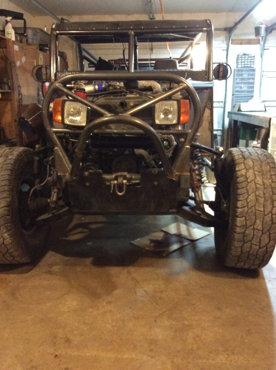

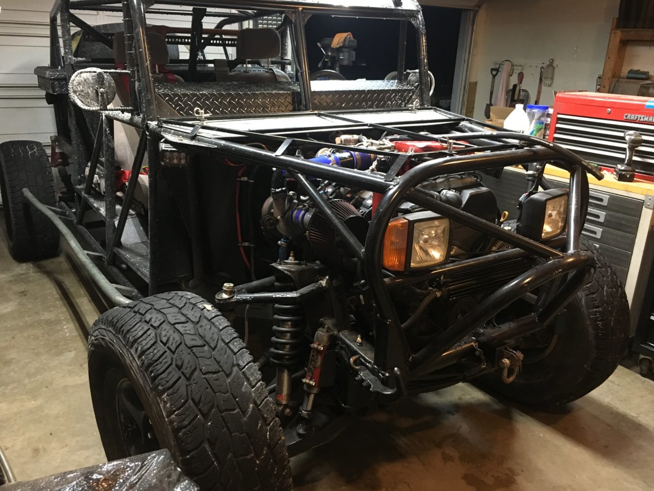

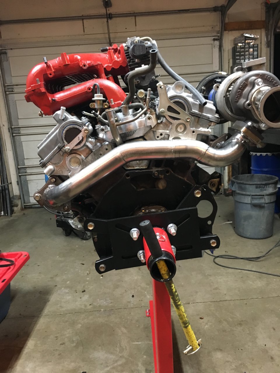

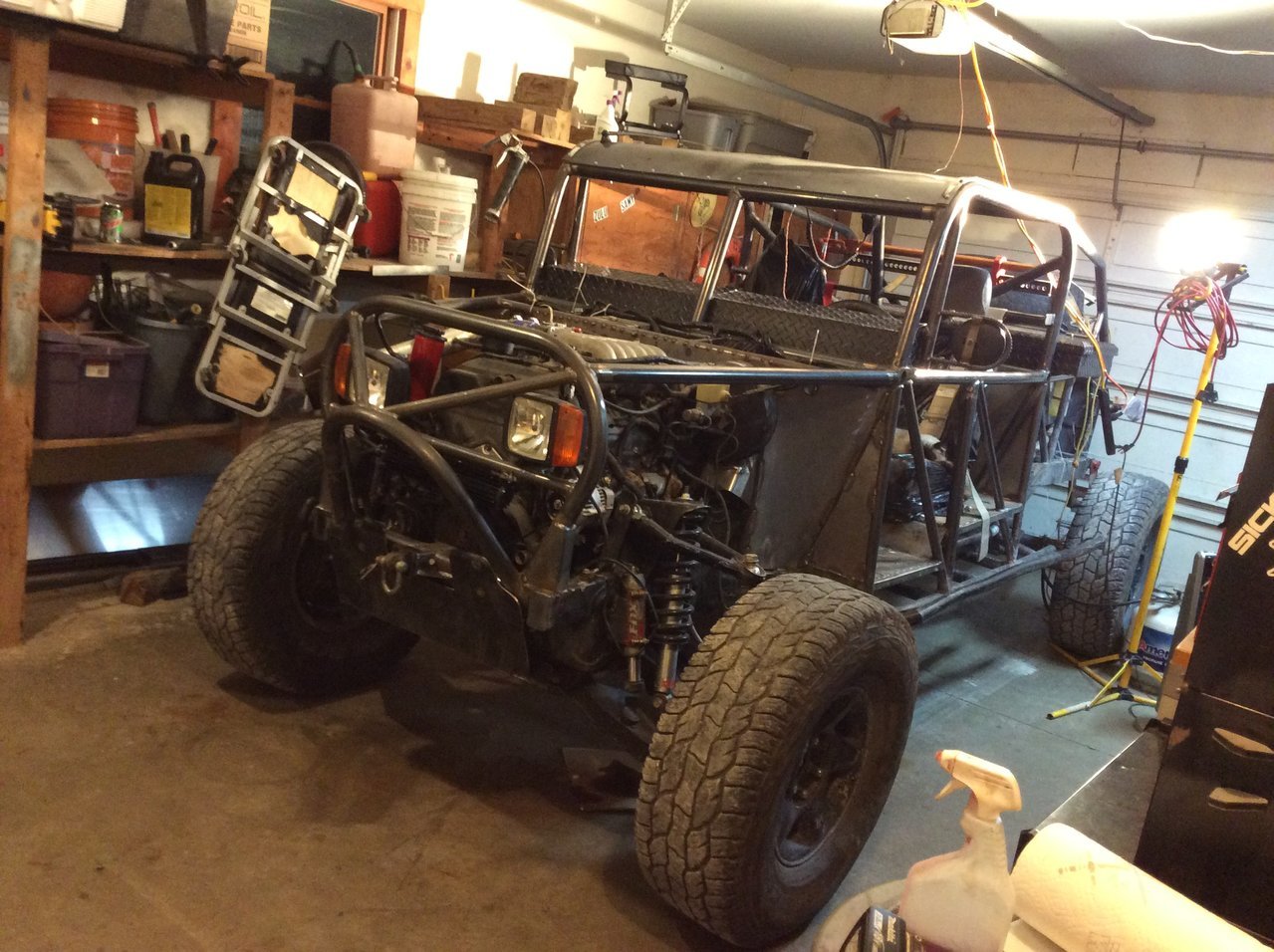

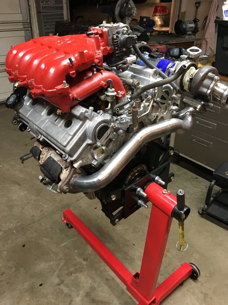

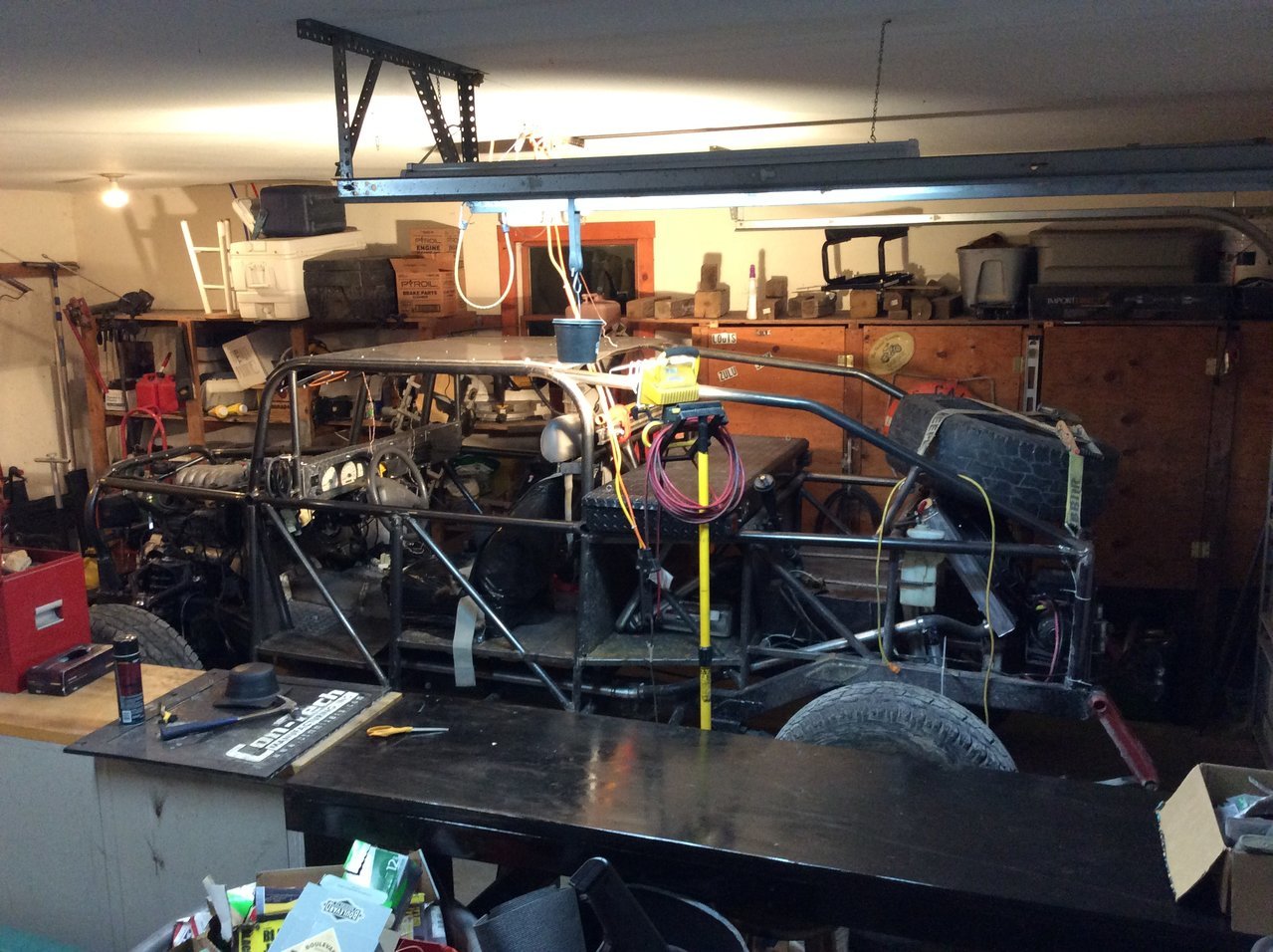

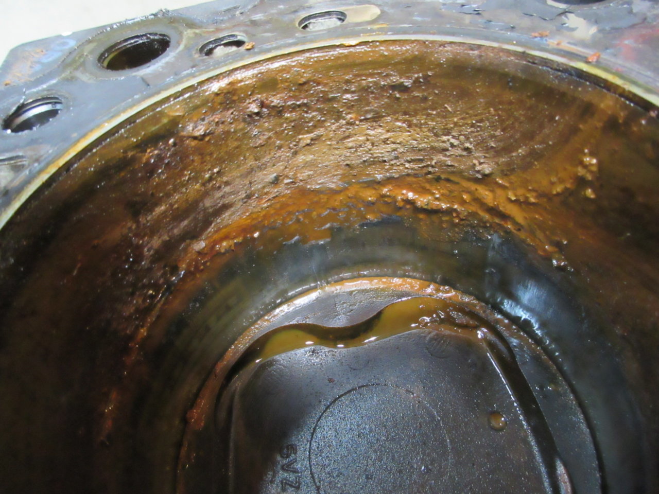

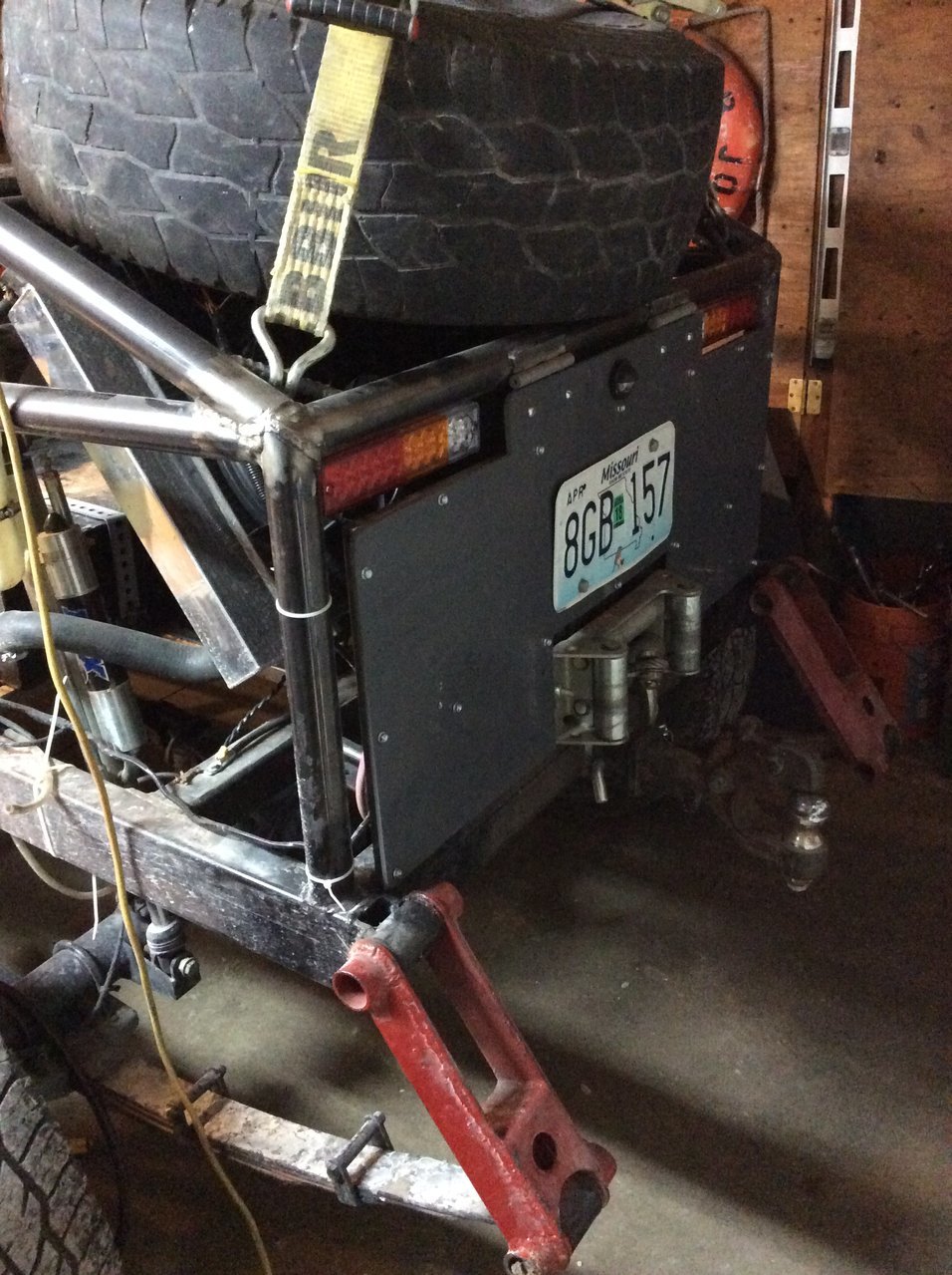

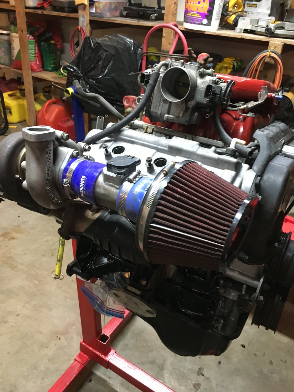

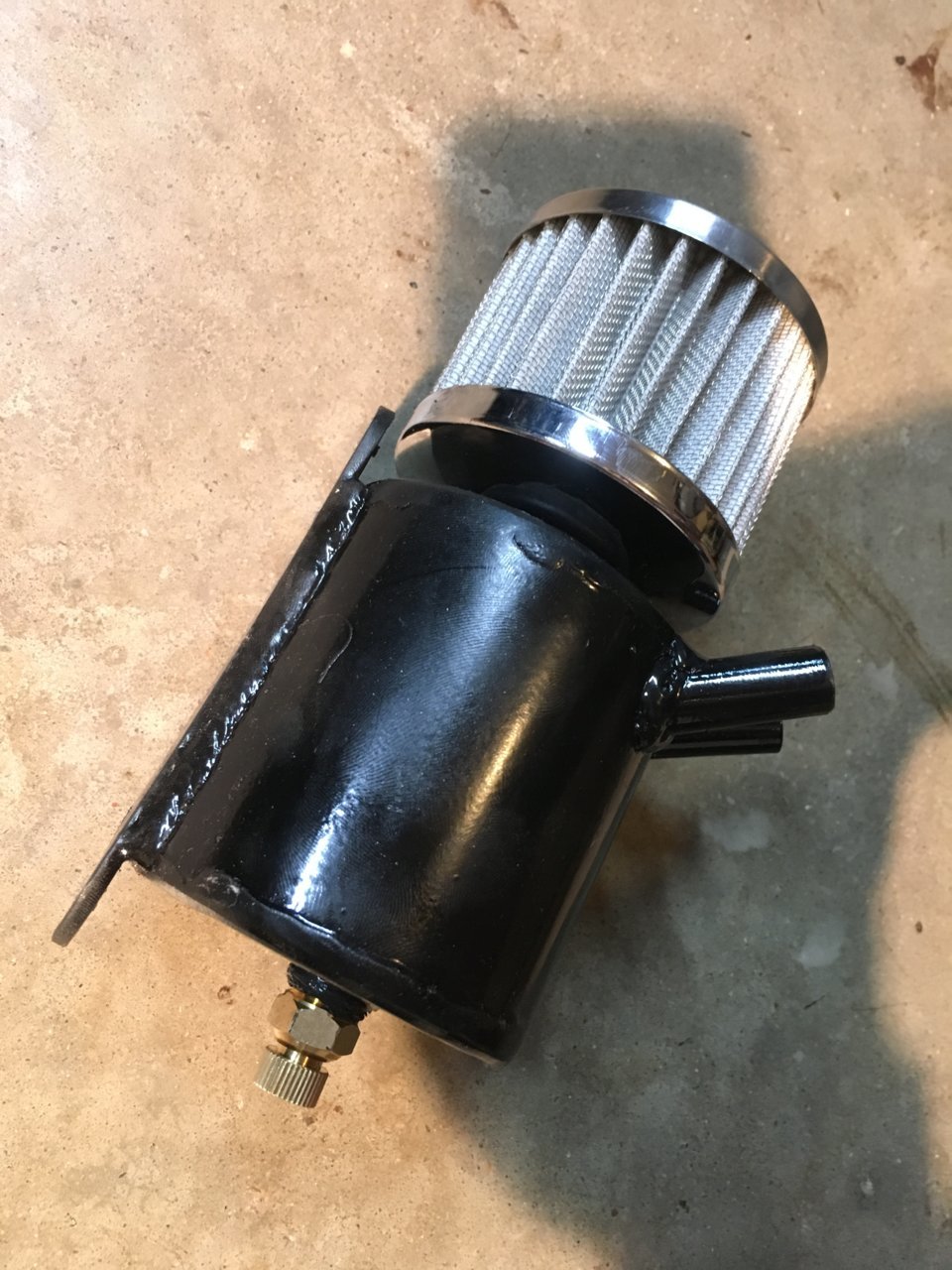

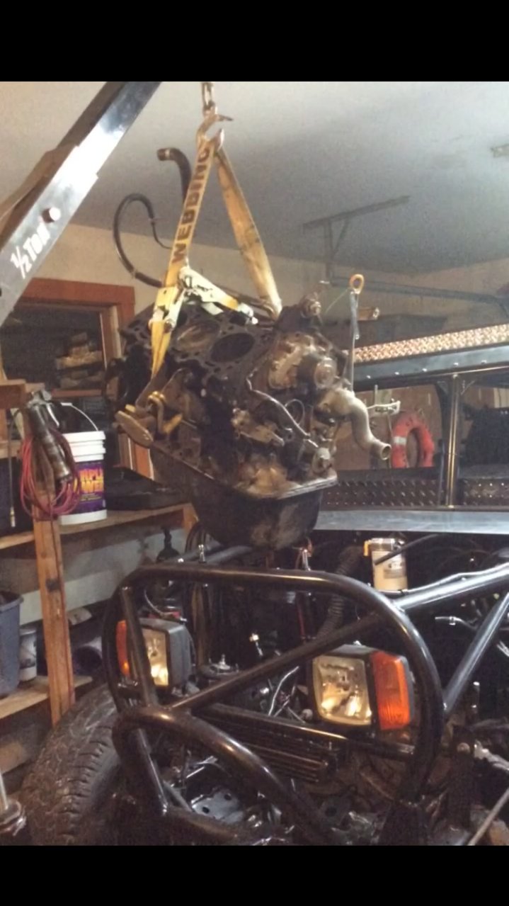

    Alright soooo time for the 3 year update.
    Been doing big turbo Subaru stuff for the last 3 years. I got tired of blowing money on nitrous and methanol so subi is now in storage and the trucks out.
    At the beginning of summer I put a new motor and started wheeling the piss out of her.
    About a month ago I was pulling up on the trailer getting ready to go to flatnasty and the rear diff grenaded.
    So I got a set of 4.30 diffs from a 4Runner and started wheeling again. Then today while going out to get the mail this happened.
    Broke the ps side gear in my new diff... good stuff ::)
    and for good measure a few pictures of the old set up.
    kinda ironic that after blowing the ringlands in the Tacoma i decided to move on to Subarus.
