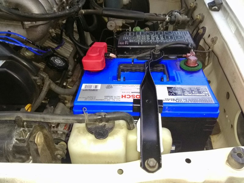

    I got mine at pep boys on sale for 135 dollars.

    Color matches your spark plug wires, too. Looks like Pep Boys is sole distributor for Bosch batteries. I wonder who makes them - Exide?

    From what I read yes exide makes them.

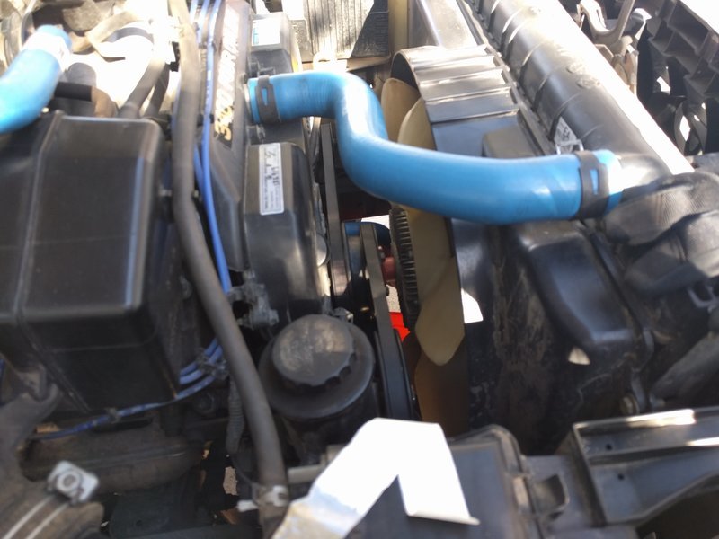

    And yes great match with my hoses as well
