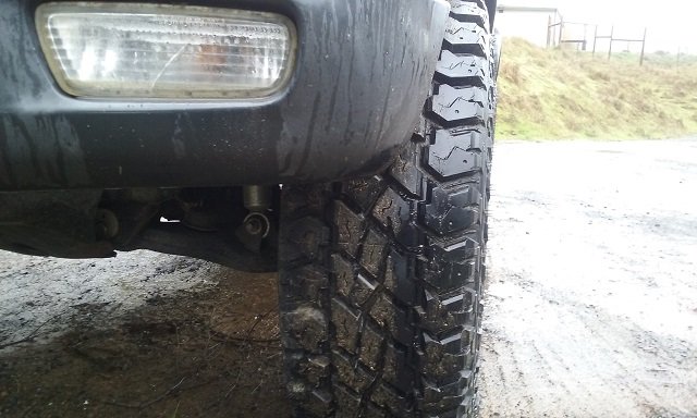

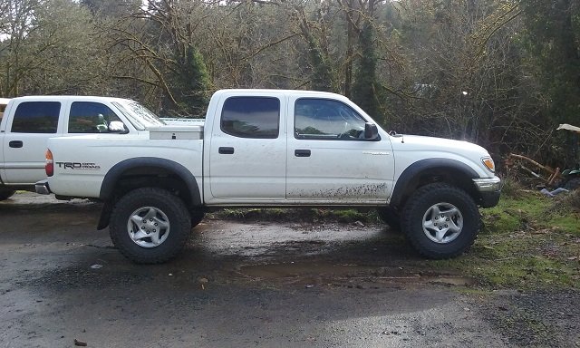

    heres a pic of mine I have coopers 285/75R16 with stock rims and a 3in lift and .25in wheel spacer upfront the tire still rubs at full lock on the upper control arms but not as bad if it didn't have them and the lug nuts still have plenty of bite on the studs
