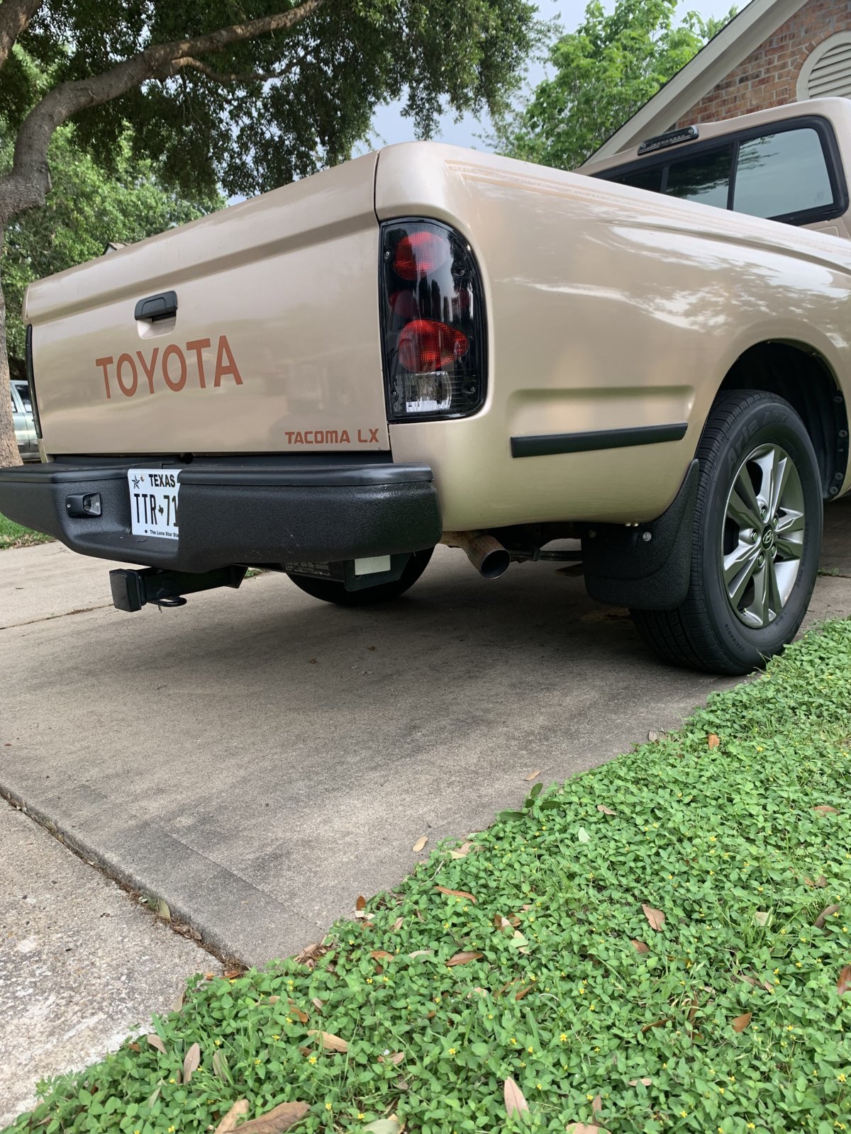

    Shops don’t use ‘bondo’ anymore, now
    They use an epoxy filler (like 5 to 1 mix)
    That is what I would recommend/use
    to get the scratches and texture out
    And a shit ton of sand paper and patience!
    FYI
    I found that a professional spray-on bedliner vendor does wonders
    And costs lil more than materials alone (for proper painting)
    S paper/epoxy/primer/paint/etc
    that’s what I did

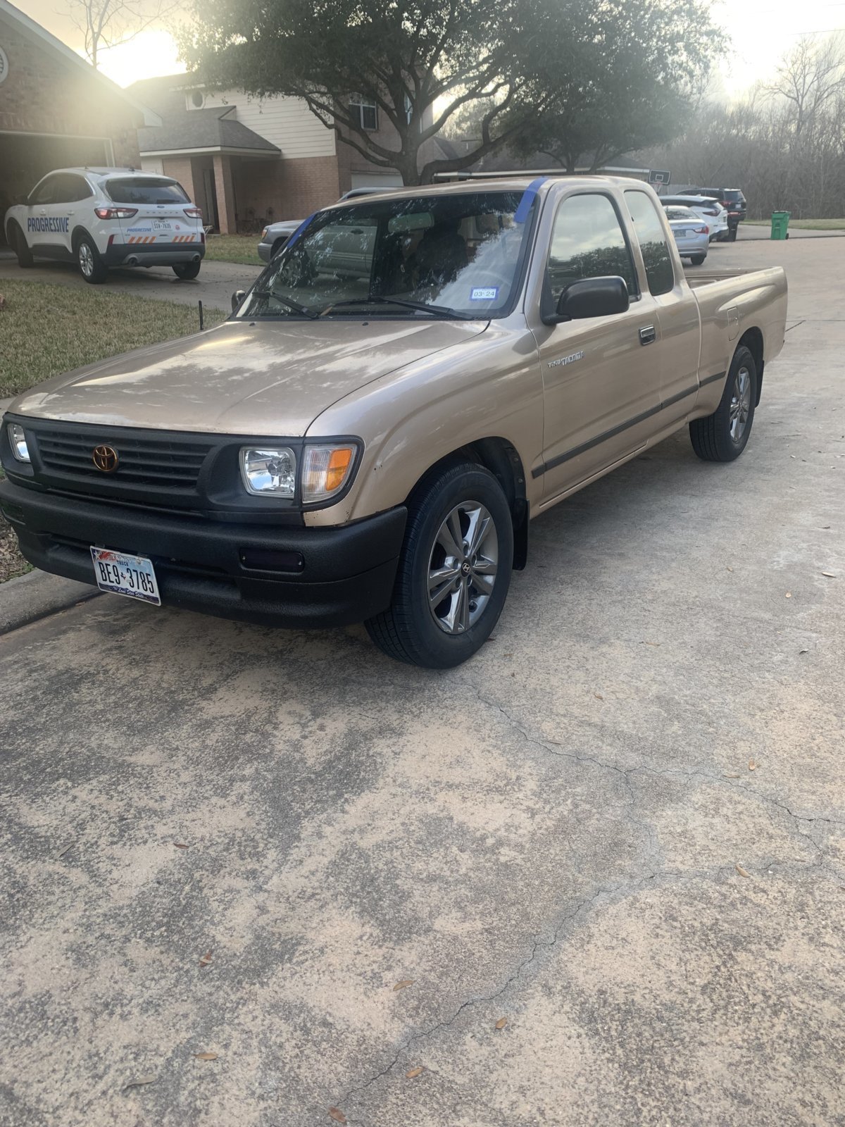

    Interesting.
    kid has been asking me if some exhaust system has sold here on FS forum
    Your link gives me another option
    My Son is…..well…..low key
    You want aggressive All-Terrain tires or just regular tires?
    Regular.
    Offered a free lift kit(installed)…..
    Naw dad rather have cracked windshield fixed.
    incredible.
    however, he has asked about this exhaust twice. I’m kinda worried that he won’t like the louder exhaust note
    Guess will ask him again

    thank goodness you or he has a '96 5-lug
    the '97 and up 5-lugs were not quite so 'aggressive' looking in some opinion circles
    that stuff definitely works As Long as the crusty is not so bad
