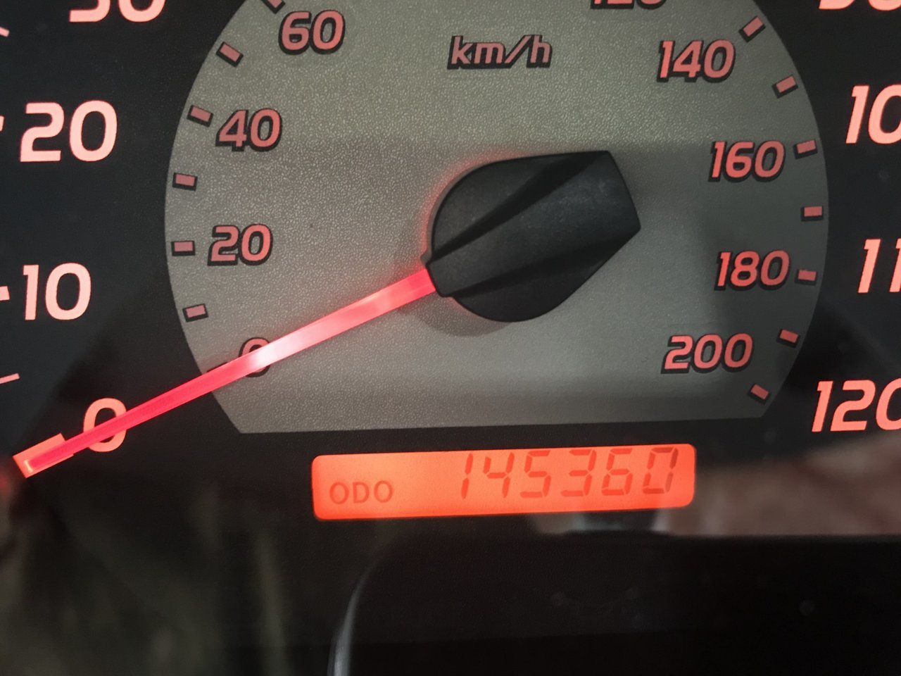

    2006 DCLB TRD Sport PreRunner
    Any Mods? One. Maybe two, tops...
    2006 Tacoma PreRunner TRD Sport 4.0 V6
    145360mi
    Purchased new in October 26, 2005.
    Replaced timing chain, OEM alternator with a 270 Amp XP Series Large Case High Output Alternator from DC Power Engineering, and COMPLETE FRAME replacement courtesy of Toyota Motor Corporation... other than that - ZERO ISSUES!
