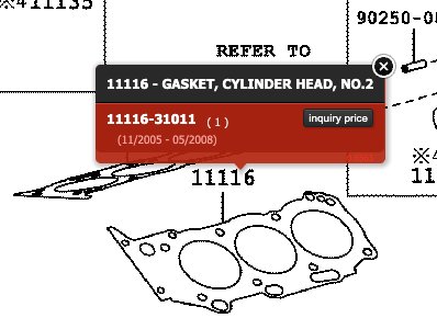

    any chance you can point me to the official info that states That they fixed the issue after 12/2005? I can’t find it anywhere online

    Looking at the parts diagram, they specify build dates on parts if they vary between MM/YYYY.
    The head gasket is listed as 11/2005-5/2008. So the earlier statement of 12/2005 is probably safe since there may have been some leftover earlier ones in production of 11/2005.
    http://japan-parts.eu/toyota/us/200...59W/tool-engine-fuel/1104_cylinder-head#11116

    you are a genius. good thinking to look there. you may have just stopped me from my plan of selling my 2006 with a 07/2006 manufacture date. I was trying to get rid of it just because of fear of this impending head gasket failure
