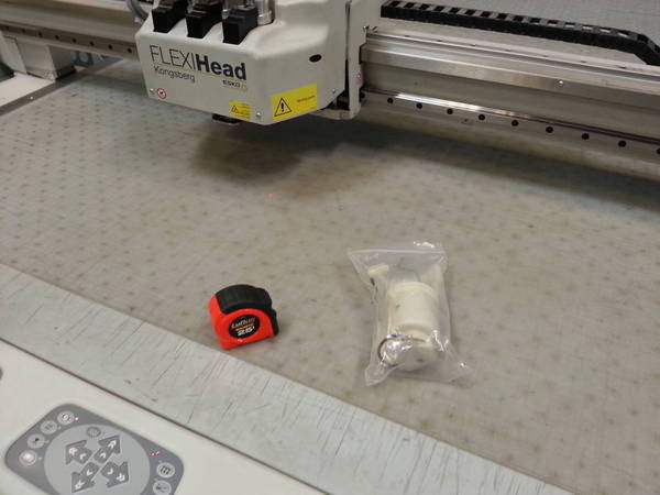

    slow at work.. so documented the Great Fuel Pump Journey..
    taking measurements
    design and cut box
    assemble box
    package fuel pump
    ready to ship

    Wow. That's pretty damn cool. Like watching "How it's Made." Lol

    hahaha.. that show is a guilty pleasure of mine.. :eek:
