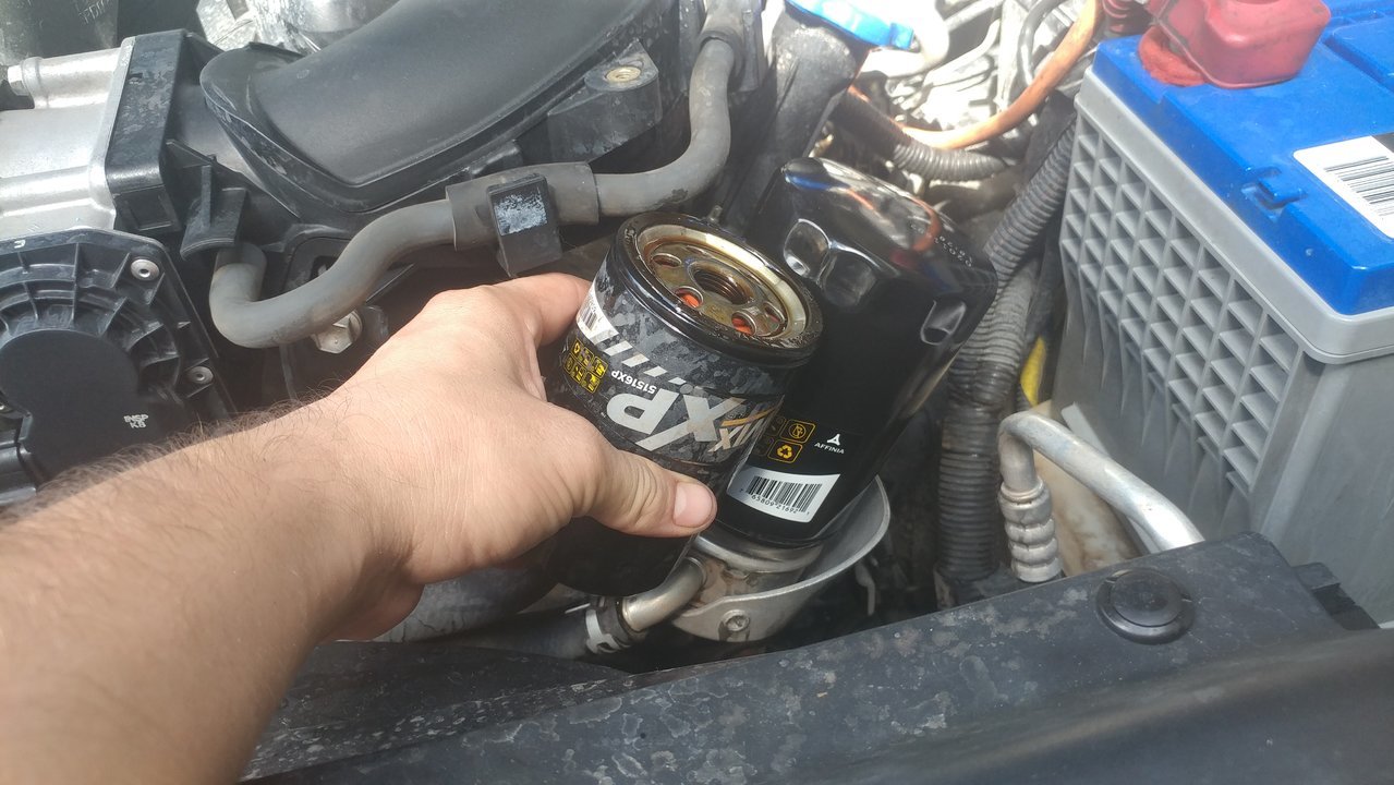

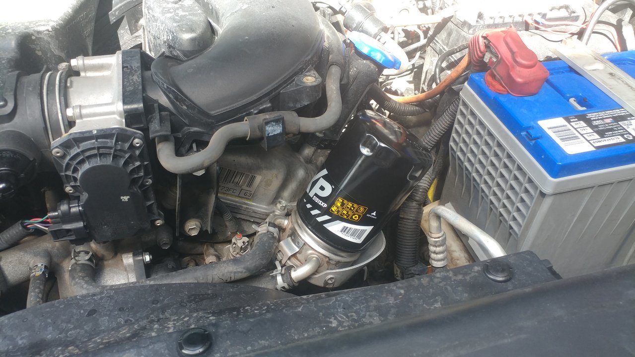

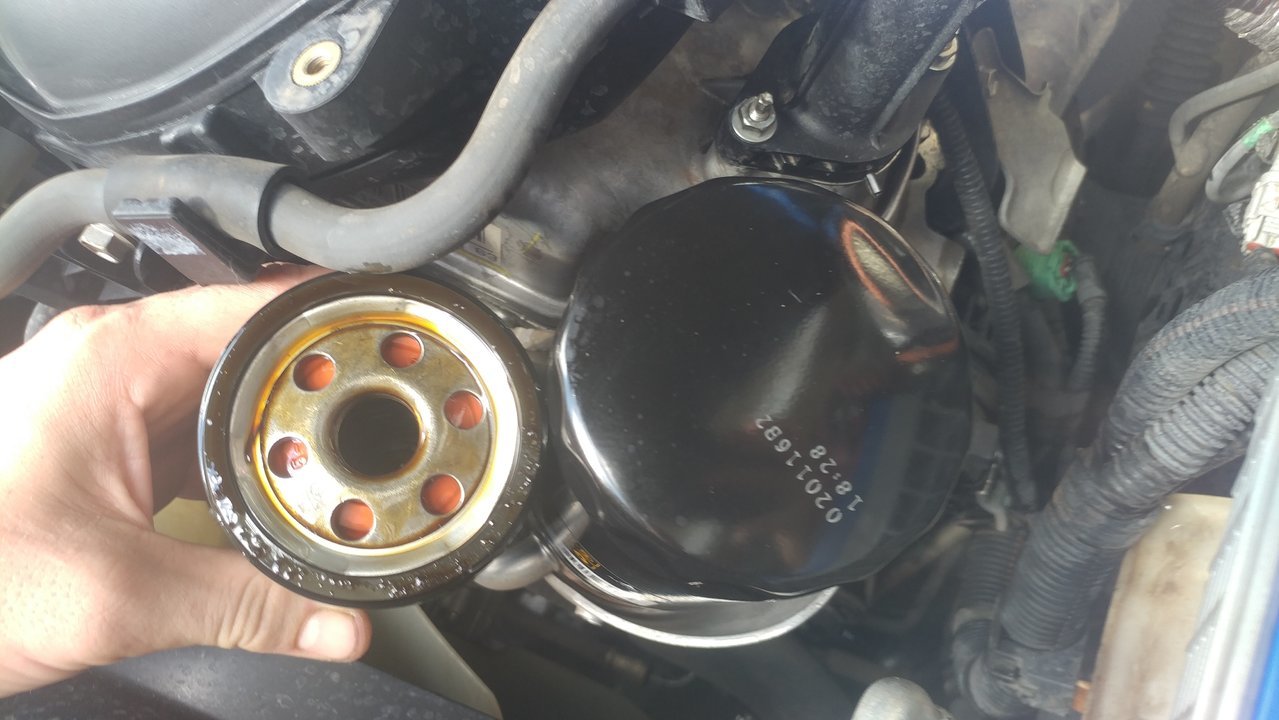

    So ever since I discovered you can run longer filters years and years ago, as I'm sure many of you know, so long as the base is the same I have always run an oversized filter.
    The benifits of an oversized are; more oil capacity, more surface area for cooling, more filter media for more filtration, less resistance in the system, leading to less wear and potentially longer change intervals. Plus they are typically the same price or within a buck or two.
    I've been running WIX 51516xp on everything I own, well recently I discovered the wix 51515xp it has the same size threads and O-ring. It's huge! It holds over 3/4 a quart of oil!
    If you're looking to run a larger filter you can't go wrong here, clears everything just fine! It does hang over the oil cooler a bit but the seal sits exactly where and how it should.
    Installed pix with the 51516xp for reference. The 51516 is the same diameter as stock but almost twice as long. The 51515 is yet longer and larger in diameter.

    Should fit any 05-10 Tacoma with the 1GR and top mounted oil filter base. In 2011 Toyota moved the oil filter to the bottom of the engine and changed from spin on to the evil Ready-Strip 13 sided BS drop in cartridge style t̶o̶ ̶m̶a̶k̶e̶ ̶m̶o̶r̶e̶ ̶m̶o̶n̶e̶y̶ because it's better for the environment.
    As with any non standard application however and your own mods you may have made please confirm fitment with your own individual system. I can however confirm that the O-Ring and filter thread size and pitch matches the OE reciver. As for clearances, YMMV. :D

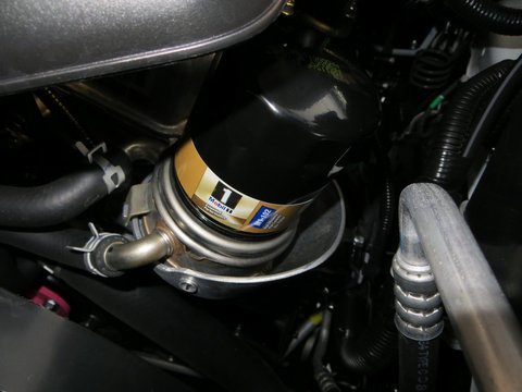

    The 4Runner/FJ 1GR had the cartridge filter. All Taco 1GR's had the top mounted spin on filter
    Sig45 likes this.

    My '15 with the tow pack.
