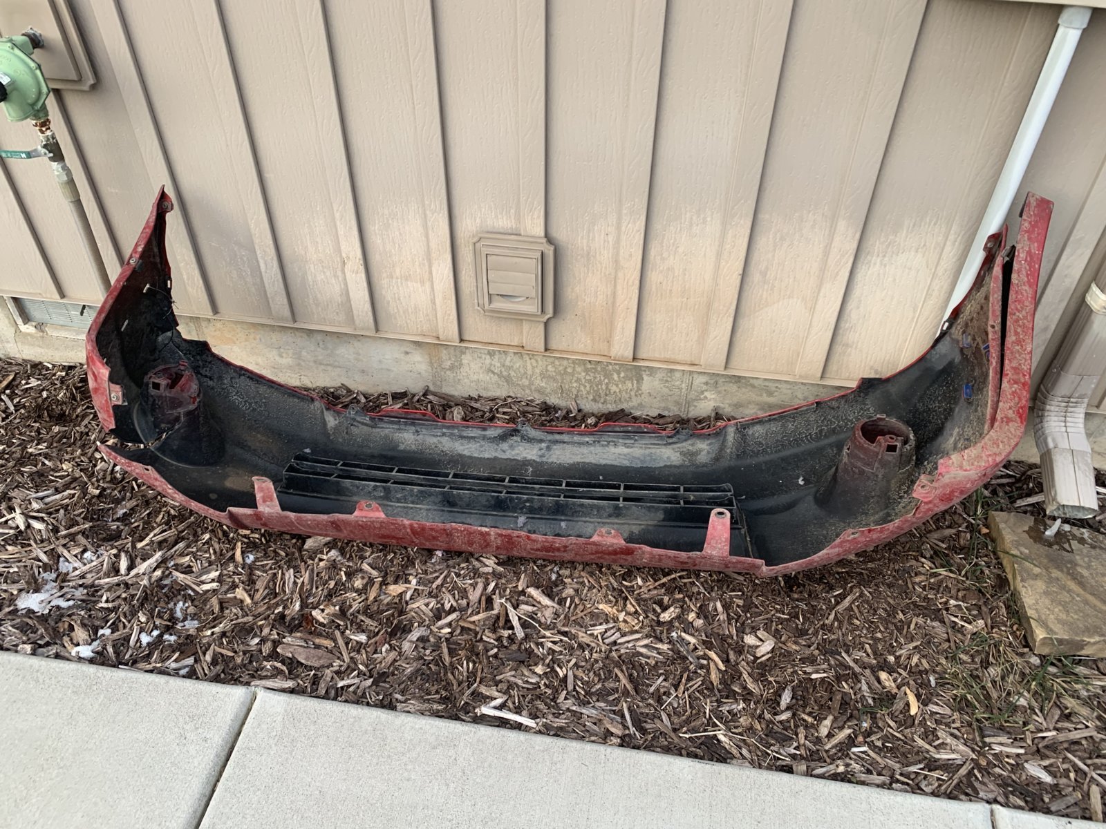

    UPDATE/For Sale: So after getting my 2009 back from the body shop after hitting that darned deer (he tastes pretty good though), I realized that the Victory Strike bumper install requires taking off a few brackets. I failed to research that before giving my body shop all the details of doing the conversion, so now I have a few brand new brackets needed for the stock bumper/grill. I’ll add a few pictures of what I have - 3 are brand new for the 2.5G and I also have all the old brackets that are from the truck before I clipped the side of that deer. For the old brackets, everything is in good shape except the driver side far left that goes around the corner. But I think you’d be able to straighten it out if needed (honestly I’d just buy a new one of those). Also, I have the old bumper cover that has damage to the driver corner side, but I’m assuming that the bumper cover is trash?
    If anybody needs these, let me know. I’ll hang onto them for a bit.
