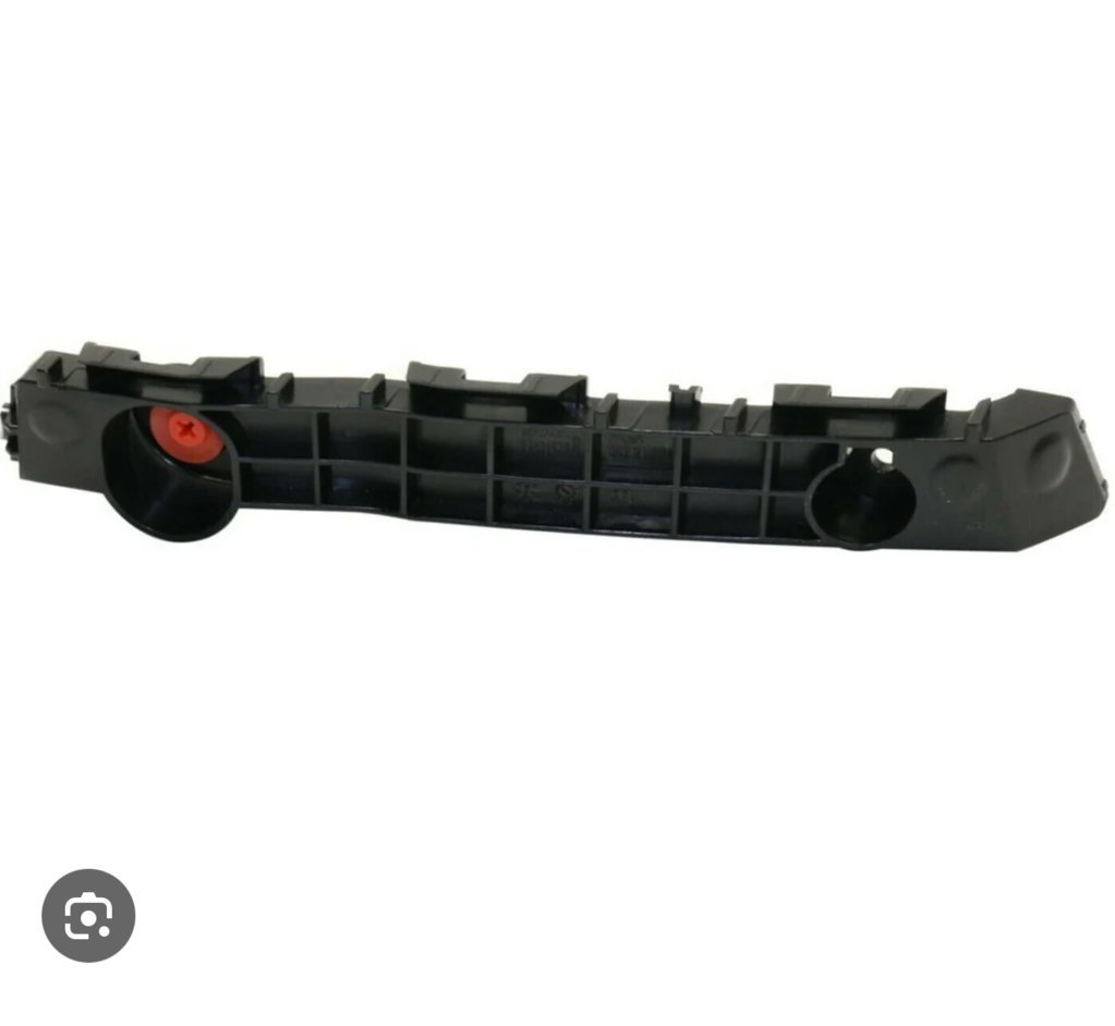

    Because the complet bumper kit is not available for viewing, was curious if anyone knows a part number for the side mounting bumper brackets? These brackets mount on the front edge of the fender, and I can’t find them. Pic related. Or I just need to know if they fit for the 2.0 and the 2.5.IMG_3362.jpg

    Just updated the thread. You won't need to swap out the plastic fender to bumper brackets. Those are the same from 2005-2015 Let me know if you have any other questions!

    Thank you.

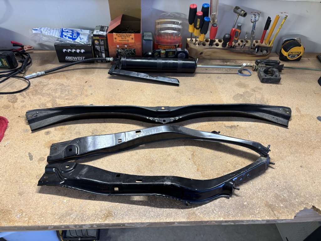

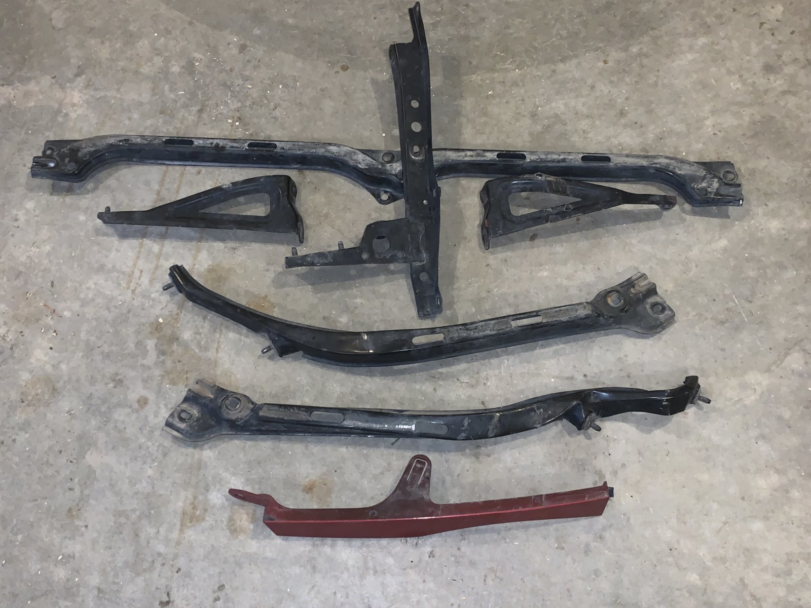

    I have brand new subframe parts for a 2012-2015 for sale. I hit a deer and the body shop ordered them anyway after I told them I wanted to put on an aftermarket bumper. So they are brand new and collecting dust.

    Are they OEM, or aftermarket?

    Those are Toyota brackets.

    Yeah if those are OEM I’ll totally take them off your hands. How much you want for them and shipping?
