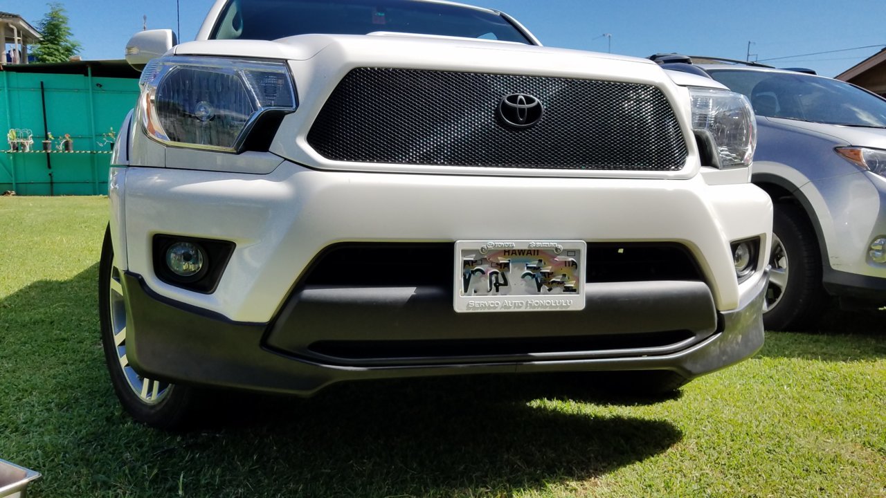

    A few
    You will also need to pick up left, right spoiler and lower grill for the x runner .Also xrunner bumper has holes for spoilers but can use reg bumper and make holes for spoiler .

    hemitruk
    hemitruk Old man , young boi truk
    Oct 17, 2009
    #24461
    2,302
    Kurt
    Hawaii
    2010 Dbl Cab Sport,
    A few
    Thanks . Added few more pieces after . :eek: :D

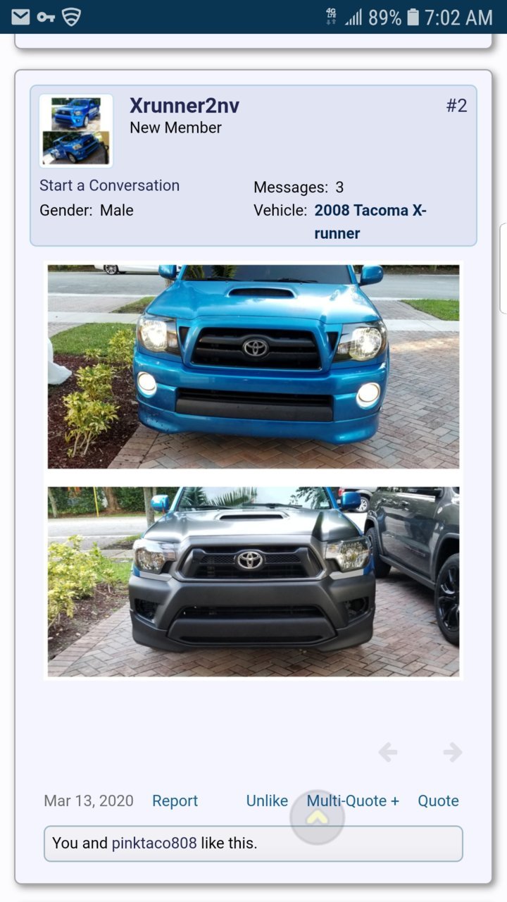

    Can i just get the 2015 prerunner bumper? Will it match the x runner fender flare?

    Getting xrunner bumper will make swap easiee but spoilers and lower grill diferent so will need those too. Not sure on fender flares but believe they are the same. I seen 1 guy swapped to 12 up front

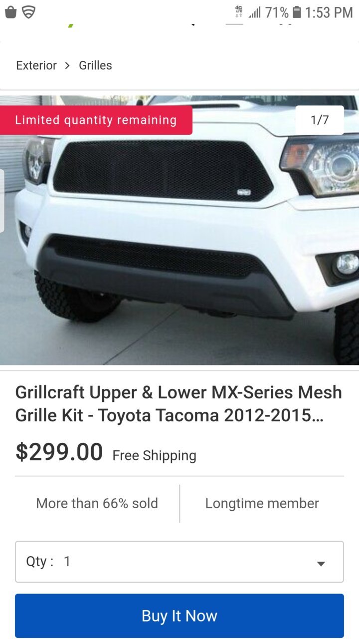

  11. Jan 14, 2021 at 3:49 PM
    #51
    hemitruk
    Oct 17, 2009
    #24461
    2,302
    Kurt
    Hawaii
    2010 Dbl Cab Sport,
    A few
    Just letting him know so he knows what it is .
    Maybe he can find used:notsure:
    Just saw on ebay someone selling grill and lower grill for $299 .

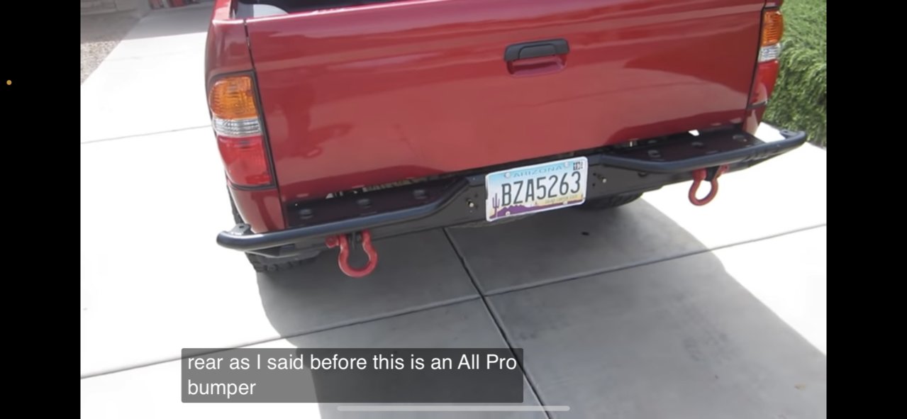

    I’m new around here and I was referred to this conversion. I have an 04 and I was wondering if anyone can help me identify this bumper. I had seen it in a video and wanted to know the name. It is an All Pro.
