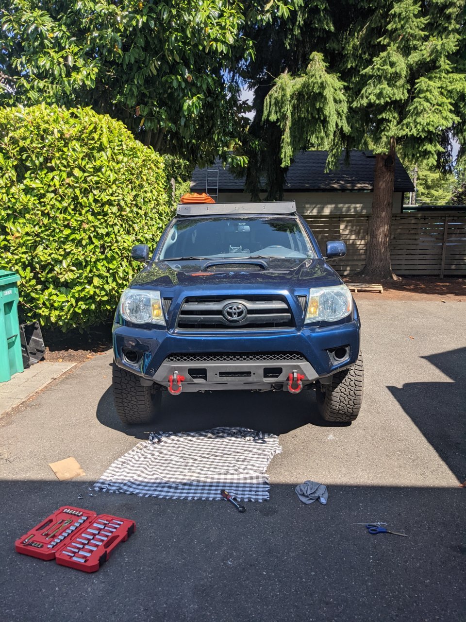

    Thanks for all the helpful info. I was able to use this thread and one other to verify all the parts needed to swap my 08 over to the 12+. Super excited about the results! Changed the whole look of the truck. Added new wheels and tires, then built a winch bumper to go with it. Can’t thank this community enough for all the info!

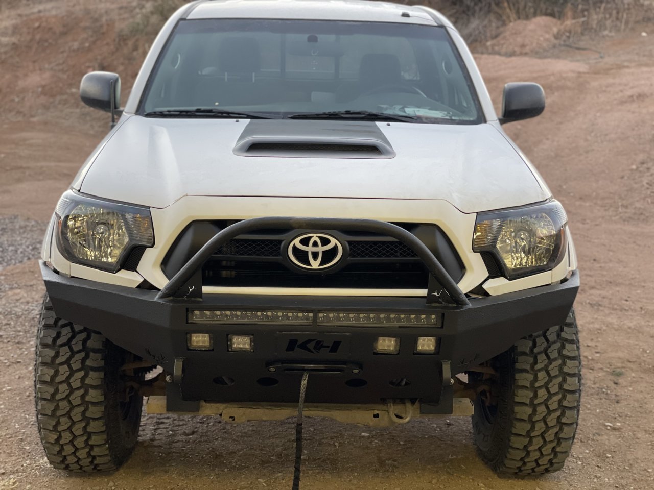

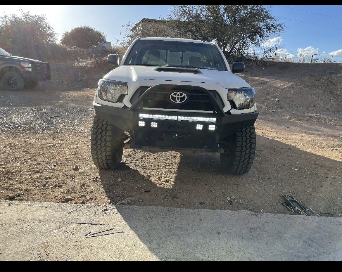

    Does anyone here know the thread for this photo or know how they mounted the 2.5 gen bumper without a full redo? As is what brackets would I actually need for just the bumper and if it only takes trimming up the bumper?

    I've never seen that before, it looks like a 12-15 oem bumper heavily modified on the top to fit the grille/headlight lines of the 05-11.

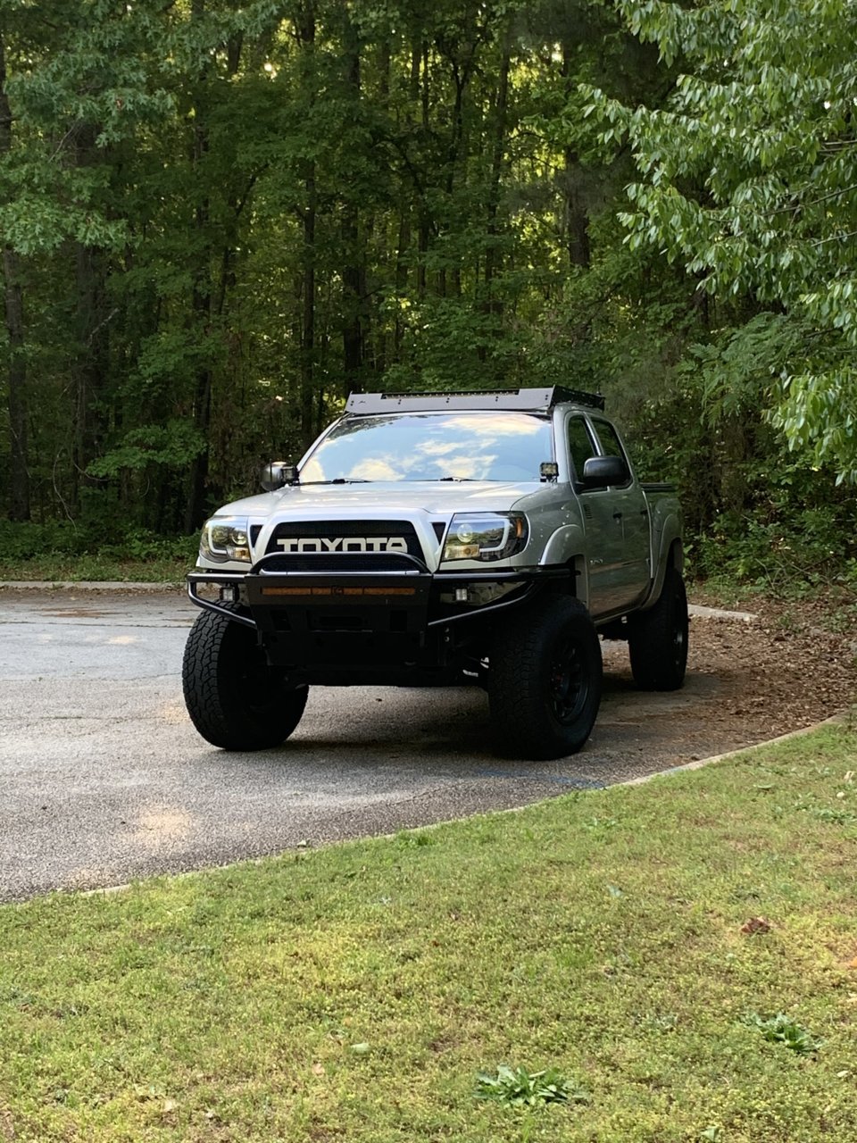

    Do you think a aftermarket hybrid bumper form my 06 would fit if I do the 12-15 conversion? I’m contemplating this.

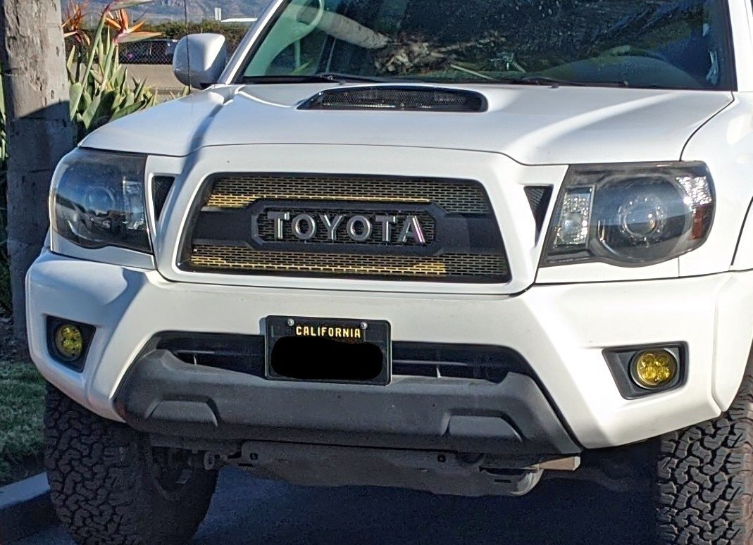

    So just to clarify, the painted part that you are pointing to came with the $99 ebay grill that you referenced, then you swapped in the TRD pro grill:

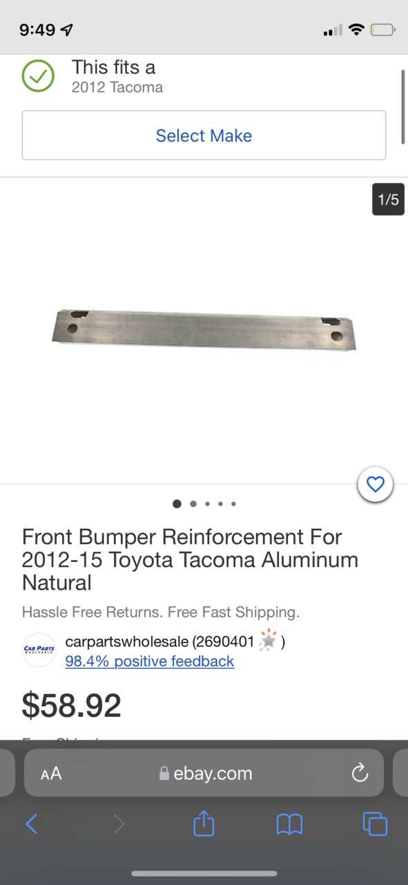

    What about the actual headlights filler? Amd if we find a crash bar with the brackets already attached, we can eliminate those four pieces, correct?

    That is the reinforcement you’ll need. You’ll also need everything else pictured in that link. If they don’t restock soon I’m going to list the parts in separate links.

    Ohhhh, that makes much more sense now. I thought they were a few items missing, so everything comes in this package? Do you happen to know the part number for that race bar that goes across the bottom? And what are the two triangular pieces?

    All the part numbers and part descriptions should be listed in that eBay link.
