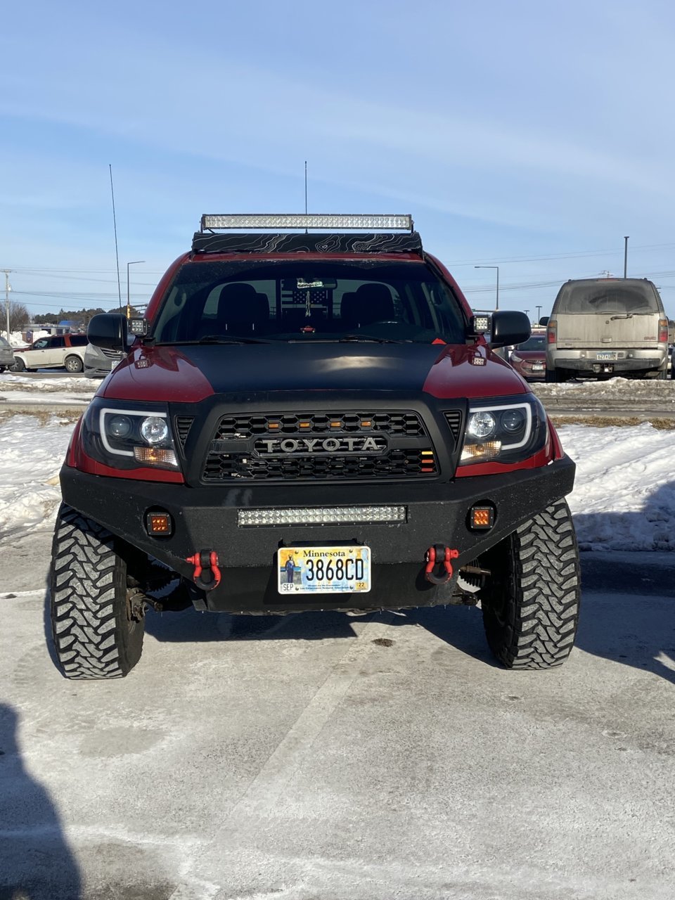

    Hey man! I have a custom bumper, do you know what I wouldn’t need?982E4CCA-4972-4D36-9C9B-7836ACCFD7F6.jpg

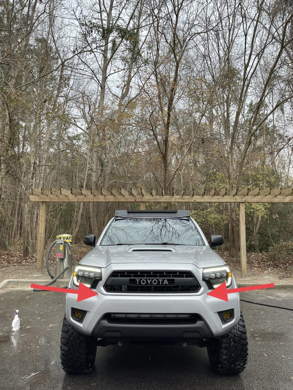

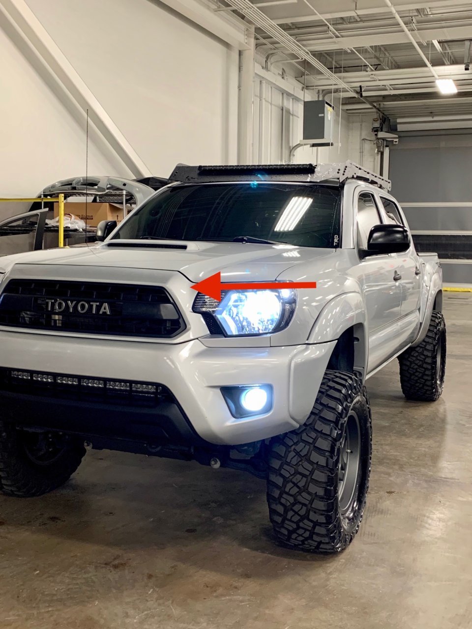

    Clean setup man, you won’t need any of the lower bumper brackets or reinforcement and no bumper and flare end caps obviously. You still need the upper brackets to hold the grille and headlight fillers.
    I’m not 100% sure how your new grille will fit up with your 05-11 aftermarket bumper though. I’m looking at this body line. You can see it’s flat across on your truck
    and on the 12-15 front end it dips down.
