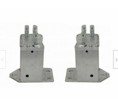

    Are the bumper reinforcement brackets reusable? Or should I just order a them too? It seems like they are the same part, just unsure if they are easy to swap over.

    Op, just to be a bit of a pain in the ass, do you happen to know the parts that are in the eBay bundle? Like if I want to purchase all those small brackets separately?

    I resprayed my entire truck, so I can’t give you a number for the front end only. I sourced all oem parts. Found a used sport hood, grille surround, bumper and bumper support. I bought new headlights, grille and brackets.

    I don’t recommend anyone go to the dealer for the brackets and clips. They will cost over $500 at the dealer
    I tried rock auto, cart came out to $250, but no shipping to CA because apparently these parts are cancerous (but only in CA)
    OP thanks for the eBay link, going to try to make a new car and hopefully it’s not outrageously priced

    Pretty much exactly what I'm trying to do right now. I would like all OEM brackets just because otherwise I feel like it's going to look crooked.

    OP, I have a few questions for you. How different are the fender liners? Do you possibly have pics? I am going to do the swap, but would prefer to keep the original liners if possible.
    Also, in the ebay link, where do they triangle shaped brackets go? I believe they call them just "bumper bracket".
