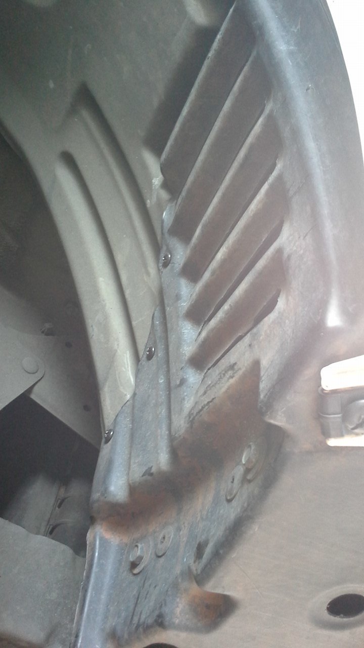

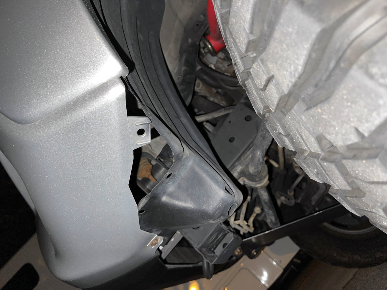

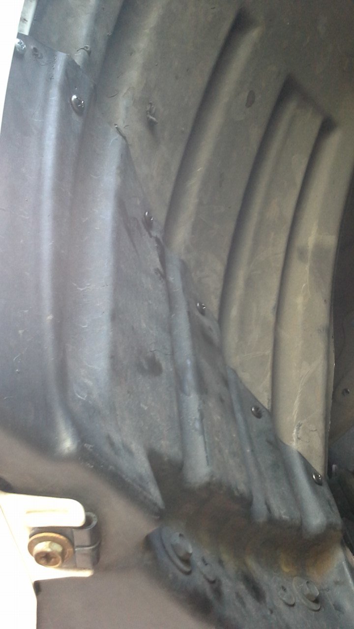

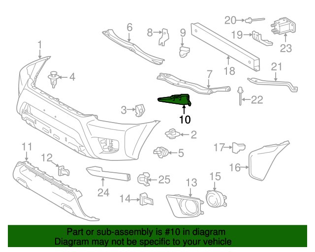

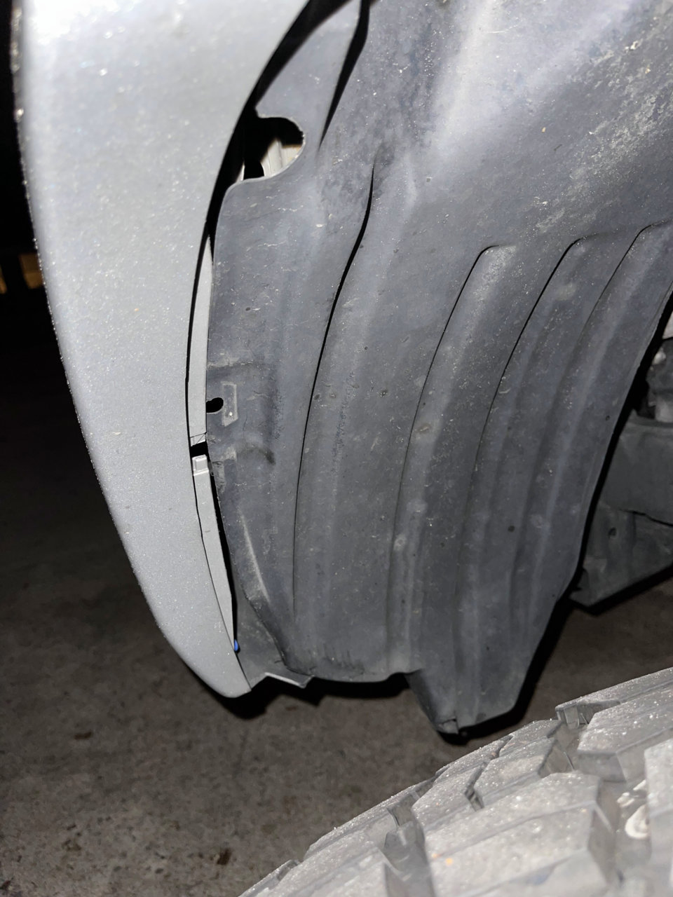

    Here's the fitment of the 05-11 wheels liners. It's not great, but also not terrible. Also do you have a link for the bumper brackets you're talking about?
    drewskie[QUOTED] likes this.

    If you can find someone who added steel front bumper and trimmed linner and they still have piece you can make it fit . Guy I brought bumper from also gave me the piece of linner he trimmed off
    Skawdee and drewskie like this.

    Awesome, thanks. It looks fine in your photos, but I think the fact that it doesn't line up with the holes would bother me. I will try and find a link for those part numbers. They are part of the eBay bundle in your links, but I saw them on the Toyota parts site too.

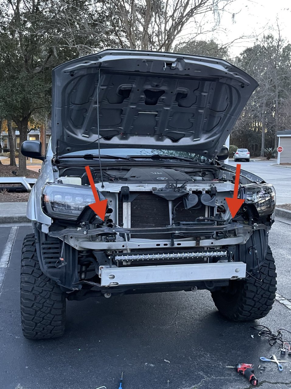

    53274-04030
    This bracket, one for right and one for left.

    Those brackets go on the left and right side of the radiator support and hold up the three center bumper brackets running across the front.

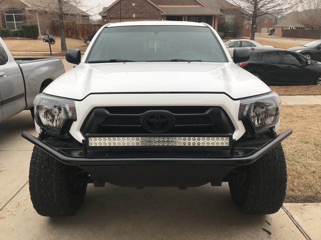

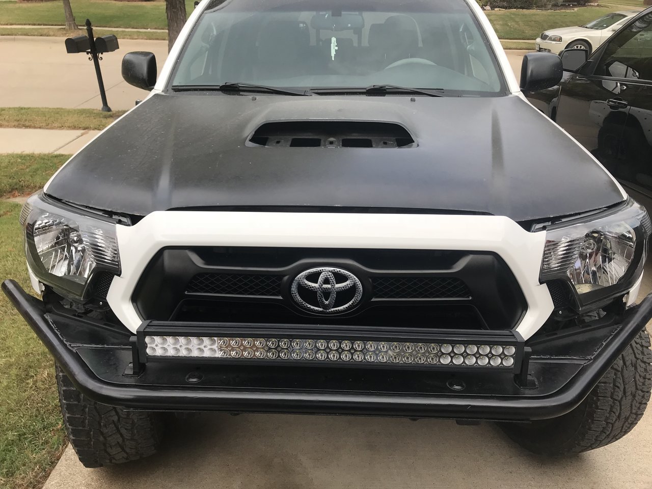

    There's a picture floating around here of someone that Left the old hood.

    Pic from thread in TW

    Agree . They posted pic to show how it would look . 2012 hood was installed and that truck looks awesome .Trying to find post again
