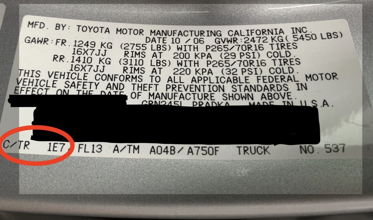

    Planning on doing this on my 2008 Tacoma. Only one question...is the Silver/Gray that came on the 2012-2015 models the same color that came on the preivous ones? Meaning if I got pre-painted panels, would the colors work fairly well? Or do I have to get the new hood/bumper/grill painted separately to match the current truck. Thanks!

    If you can get lucky and find the same color silver it will be the same, except in 2015 there was another shade if silver called silver sky.

    Depends what you're definition of "fairly well" is (which around this forum can be all over the place, especially when it comes to aesthetics). Also, for clarity sake when you say pre-painted are you talking about used factory parts removed from another Tacoma w/matching paint color codes or are you talking about online ordering new parts that come pre-painted? To me, you're rolling the dice ordering new pre-painted parts with nothing more than matching paint codes to your truck. Done right, you'll have the parts painted locally where they'll use your paint code as a starting point and tweak the shade from there to best match the rest of your truck. And if you really want to be proper about it, you'd consider having the adjacent panels/parts blended to account for their aged paint and clear coat.

    They are not the same color. the 12-15 models have a darker shade of silver.

    Like others have said there are 12-15 trucks that used the same silver but 12-15 Tacomas that also had a darker silver variant. Only way to tell is to check the paint code in the door jam sticker. You should have the paint code circled in red.
