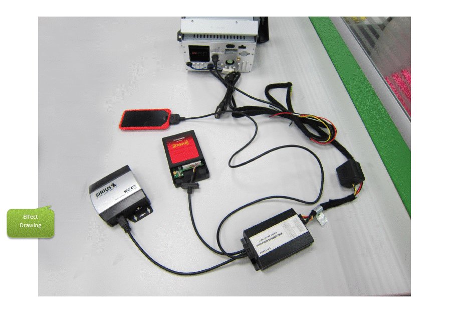

    Sorry, you said everything for sat ready version to work is included in the box - does that mean the SCC1 tuner is included? I'm unclear only because of the way I worded the question originally.

    The SCC1 tuner is not included. Im sorry fort he confusing picture you can visit our website for more detailed photos....

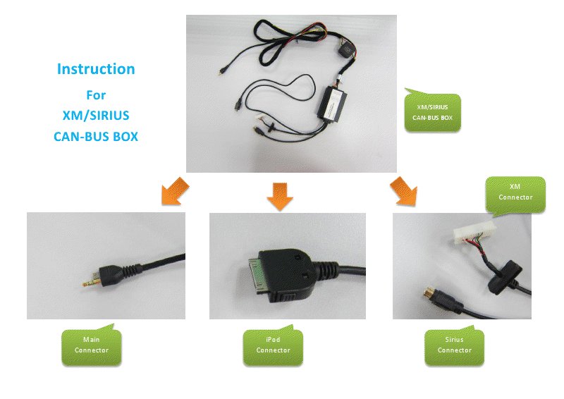

    Can anyone explain what wires marked #5 are for?
    #1 is Ipod
    #2 connects to Sirius tuner
    #3 connects to XM tuner (only #2 or #3 is used, not both)
    #4 connects to head unit
    #5 ????
    On the website, they are just coiled up with the HU connection wire but not attached to anything.
    Also, the shark fin antenna adapter should plug into the SCC1 tuner correct?

    #5 is just ground and yellow and red are power...same as radio harness
    and yes the shark fin antenna adapter should plug into the SCC1 tuner...is it not?

    Just doing some research ahead of time. Wife says the HU and SCC1/SFA were delivered today - Plan to tackle the install this weekend but wanted to have some idea what I was getting into before opening up the dash.
    So do these 3 wires (red, yellow and black) need to be connected to something for the interface to function? I thought this was plug and play. If these 3 wires need to be connected, I'm going to need to splice into something else. Or is connection #4 all that is needed?

    All installed today :). Hardest part was running the mircrophone, gps antenna, sat radio antenna wires. I did have to splice in the 3 wires on the sat radio interface to get power to the module. At first, did not have video on the dvd but after grounding the pink wire, all is good. Everything seems to work but I still need to go through some menus to figure out some settings. Cant' get voice directions on the navi. Sound is on and I get a chime sound when it wants to tell me something but no voice. The speaker icon on the screen has a red line through it and I haven't figured out how to activate it yet. Other than that, it's all good. DVD, bluetooth, ipod, navi, sat and FM radio. I will post some more detail on the install when I get a chance.
