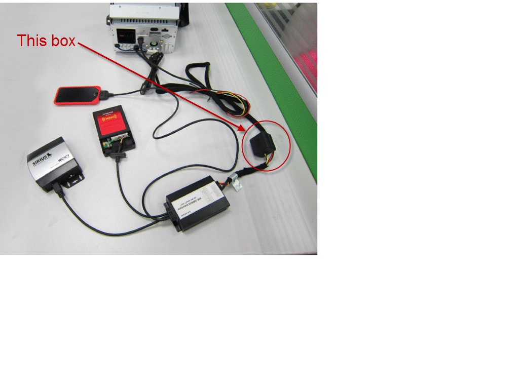

    I have been having trouble with my sat radio and ipod. Finally tracked it down to this fuse box. Does this box serve any other function than a fuse holder? It contains a glass cylinder type fuse and maybe a resistor but the fuse seems to have intermittent connection. When I lose sat and ipod, if I fiddle with the fuse, I can usually get those functions to work again. I'd like to replace it with a blade type fuse by simply cutting it out and replace with blade type fuse holder but don't want to mess up any other functions.

    you can cut it off and add your own if you would like. what you point to is just a fuse box holder.
