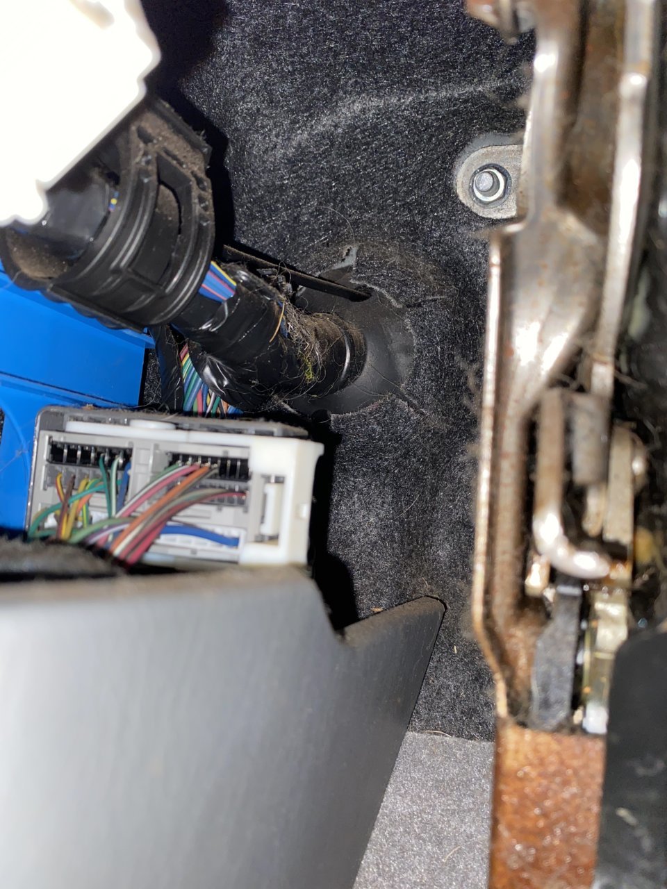

    I ran my ADD wires through the passenger side firewall. I believe there is a small grommet there near the ABS unit. It's been a while since I did my swap so I dont remember exactly.

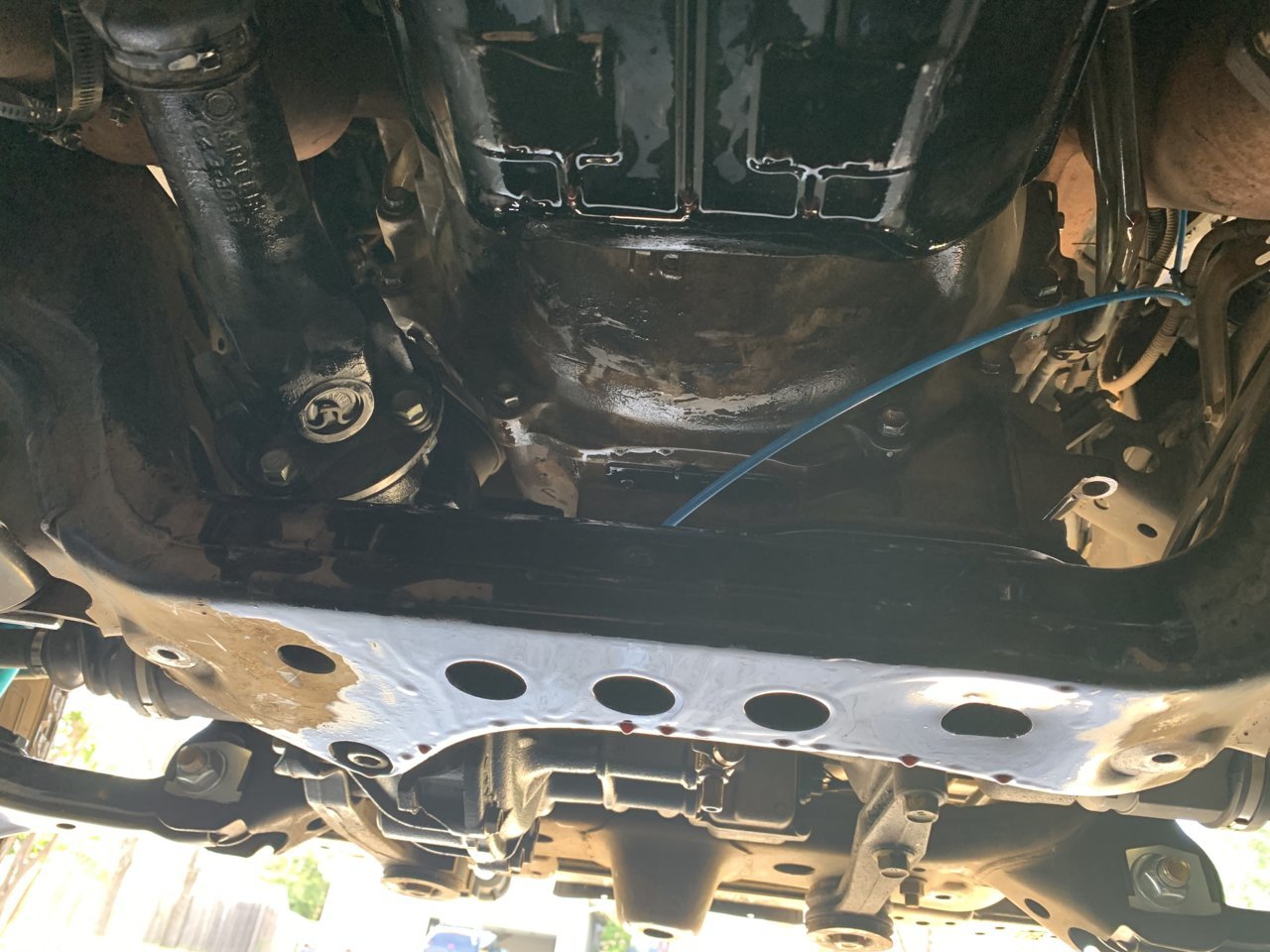

    so I did everything myself first time around, but the trans I bought had a BAD shaft seal leak. Took it to a trans shop and they suggested a full rebuild. I swapped the trans out via the parts yard warranty and brought it to the trans shop and they swapped in the new trans/ trase etc with a new labor warranty.
    Pic of original 750F trans after I drove it 2 miles to the shop. Replacement trans hasn’t dropped a drop.
    Ricardo13x likes this.

    tape the ends to the end of a screwdriver. Push from the engine side and boom, they’ve got their own hole in the grommet. :notsure:

    I drilled another 1" hole next to the factory one that allowed room for expansion. Not sure why'd you go to the driver side though. I'd be routing them passenger since the ADD is over on that side where there is already a spare grommet, which leads right into the glovebox area.
