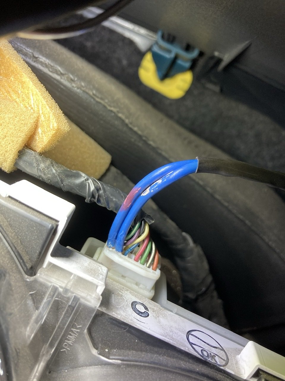

    Awesome! What did you use to connect the wires to speedo? Bare wire?

    Seems like that’s the route, or secure a connector with that type of micro pins. I was able to track the part number( that I can’t find) for the connector but comes in a bag of 100 and I was like ”naaah”. I fed bare wire and secure the cables in place with a dab of gorilla glue gel and then secure the 2 wires to the bundle of wires going in to the connector. Tested on vibration and still working as it should.CE8B1D78-2DDE-44C1-BB16-C13C32A59551.jpg

    Yeah bare 18 AWG wire jammed in nicely. I stripped about 1cm of bare wire which was enough to get it to stay but still establish a connection.
    I found it was really sensitive to shorting so it took some finagling to make it work. I might consider that glue method if it gives me issues after a few drives off road.

    correct, i did remove some strands off the actual wire for a perfect fit. I was not concerned since that circuit is ground being provided to the circuit.

    i just jammed mine down in there bare and have been going strong for 10k
