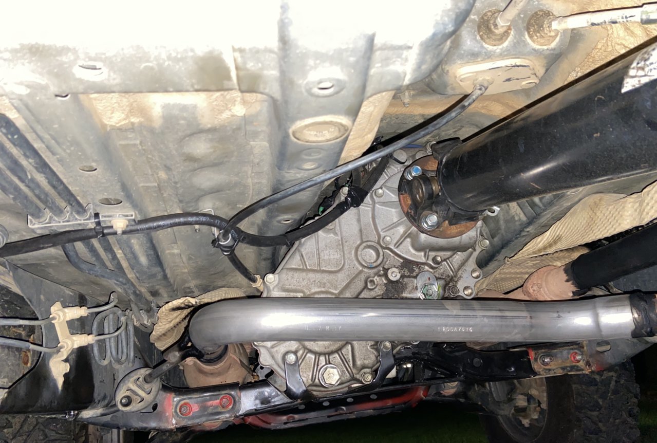

    By chance do you have a pic of how you fixed/re route your DS exhaust after the cat?

    All I got

    That will work!

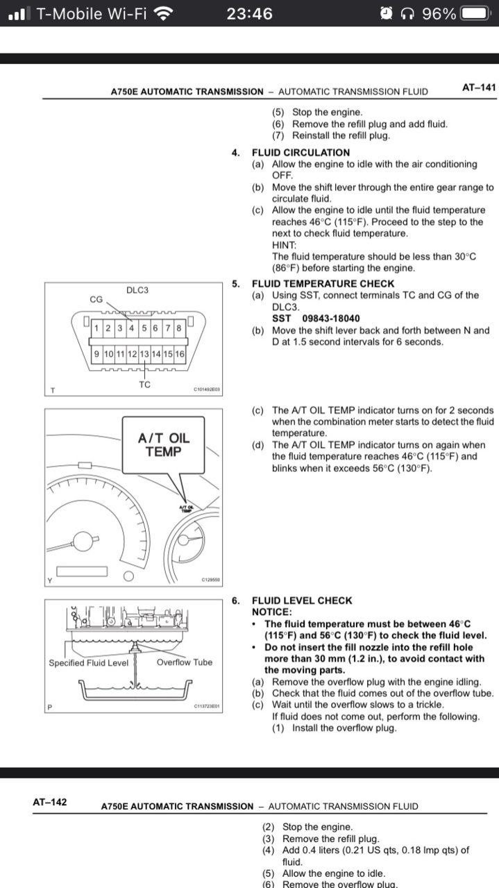

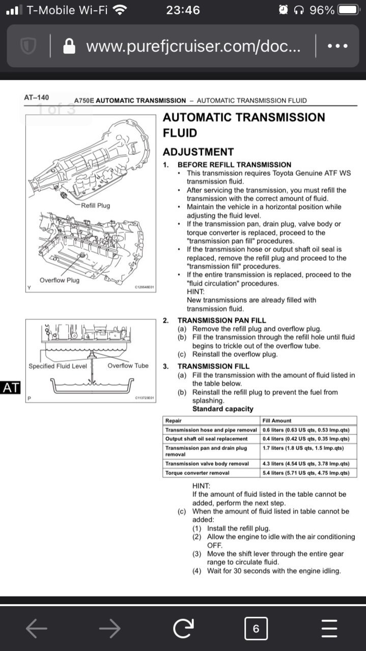

    Sweet post man super helpful for me! I’m doing the same thing for my truck right now, and am almost done, but my trannys shifting super hard. Any ideas on what it could be? I check the fluid level about 3 times and it’s good. Almost 100% sure all the electronics are plugged in but I’ll triple check. Junkyard told me if somethings wrong with the tranny they’ll swap it out so I’m not too worried but did anything like this happen to any of you guys? Probably just going to have a professional look at it on Monday to possibly clear some codes if there are any, but just really would suck if I gotta drop the trans and replace it again.

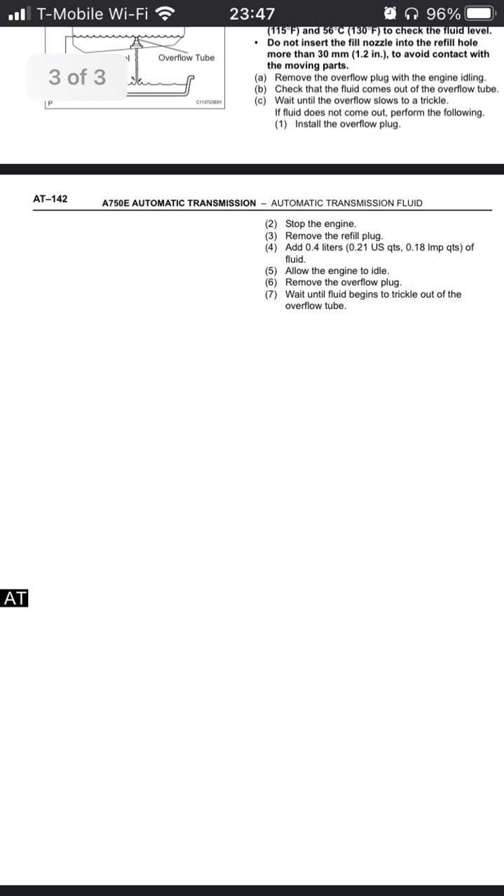

    I don’t know if you have seen this in the past but this is the right procedure to check fluid amount, I had some shudder issues, after a cycle and some shudder fix my transmission runs like new, I have put this thing to the test and runs like a dream.

    MA_TACO
