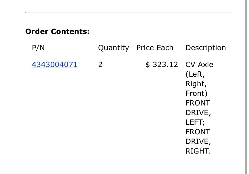

    @pdaddy @Ricardo13x Since your here,or anyone else can chim in! Are the front CV Axles the same parts number for left and right?
    Part Number: 434300401084

    That’s a CV for the first gen!!!! You should be looking for 4343004071

    Noooo that’s first gen lol This is exactly what I ordered

    This is why it never hurt to ask a dumb question! Thanks

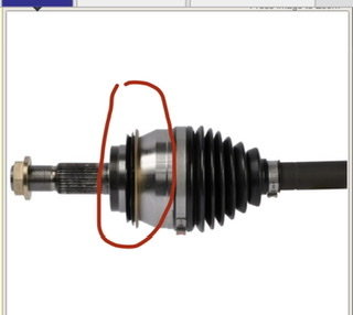

    Some of the axles don't come with the hub seals. They are a PITA to install if you don't have the right tool but NAPA has the axles with the seals installed already.

    Good to know! The seals your referring to are the same ones the guy from Toyota said are on backorder. Couldn't have been better timing, I'm buying my axles today!

    This is the seal they are talking about. By the way I went with cardone on 665235HD from Rock auto. Paid like 80 bucks each. I have put them through some serious stress and they have work perfectly.

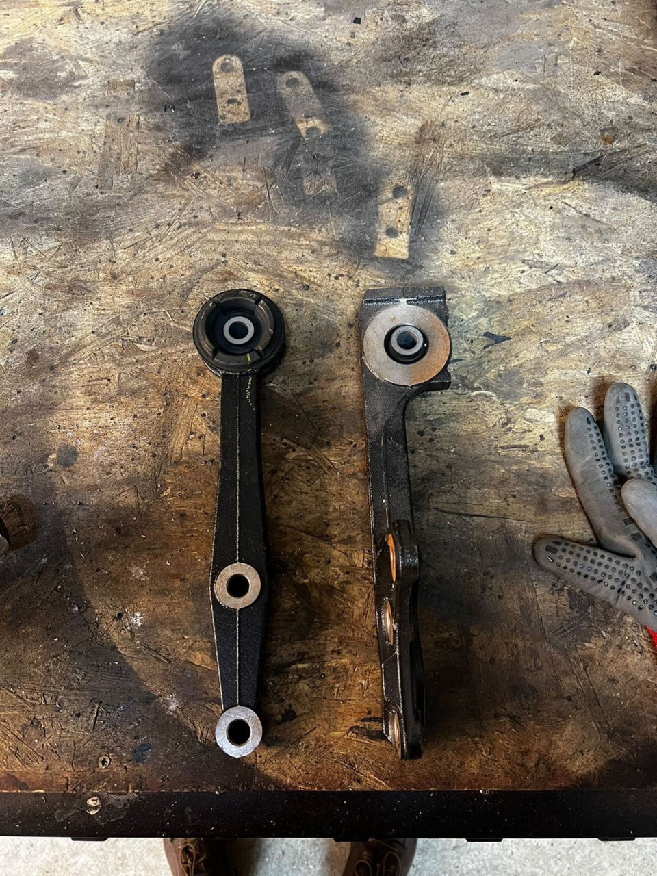

    I’ve got some brand new front diff arms for sale if anyone needs them for their conversion, $150 plus shipping.
