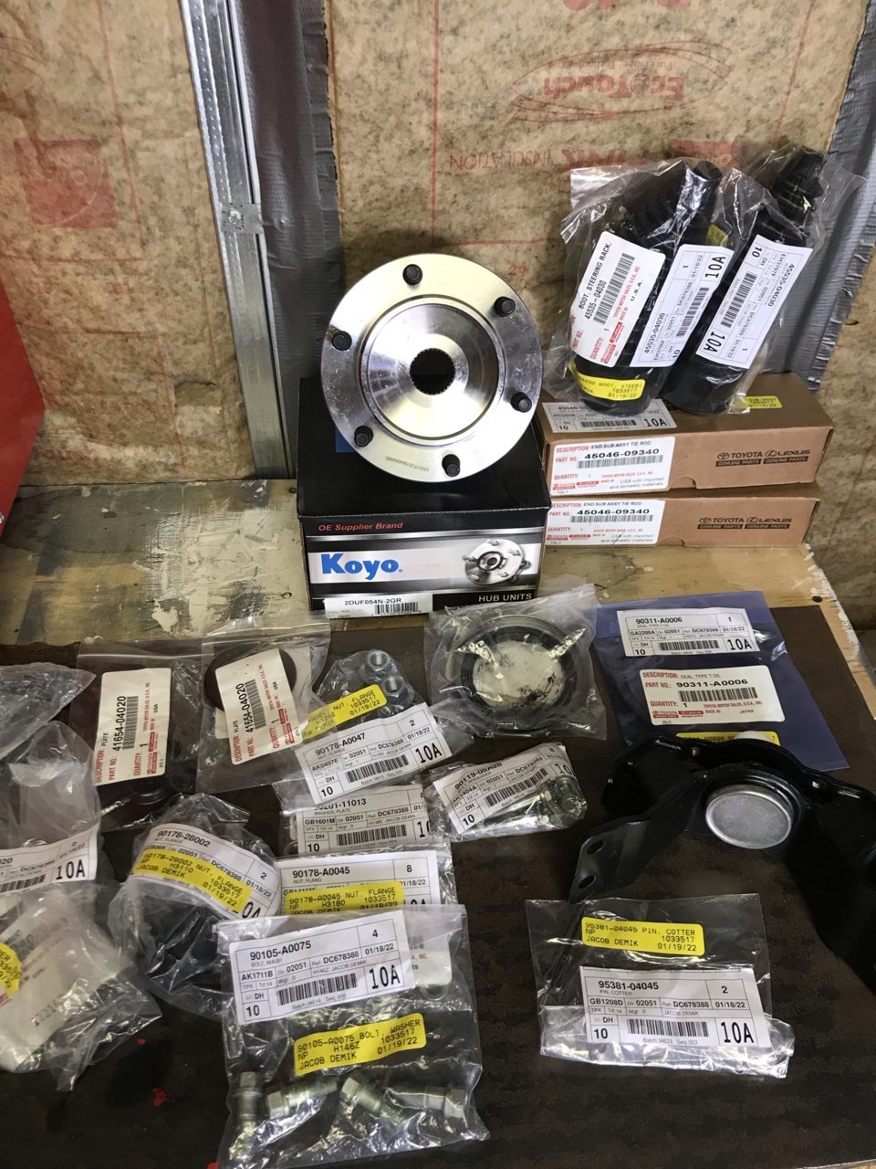

    Couple nuts and bolts 4x converted
    Small parts showed up!!

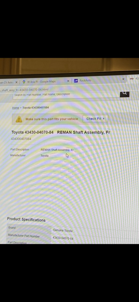

    Your welcome lol for anyone looking for cv, this comes directly from Toyota

    "Remanufactured"
    I had an Oh Fuck moment...
    I just purchased new from NAPA,(43430-04071) believe they come with the seals as well. Thanks for the share

    Yes remanufactured but literally just as good as brand new. I only run reman cv (cvj) they’ve never let me down even locked in front

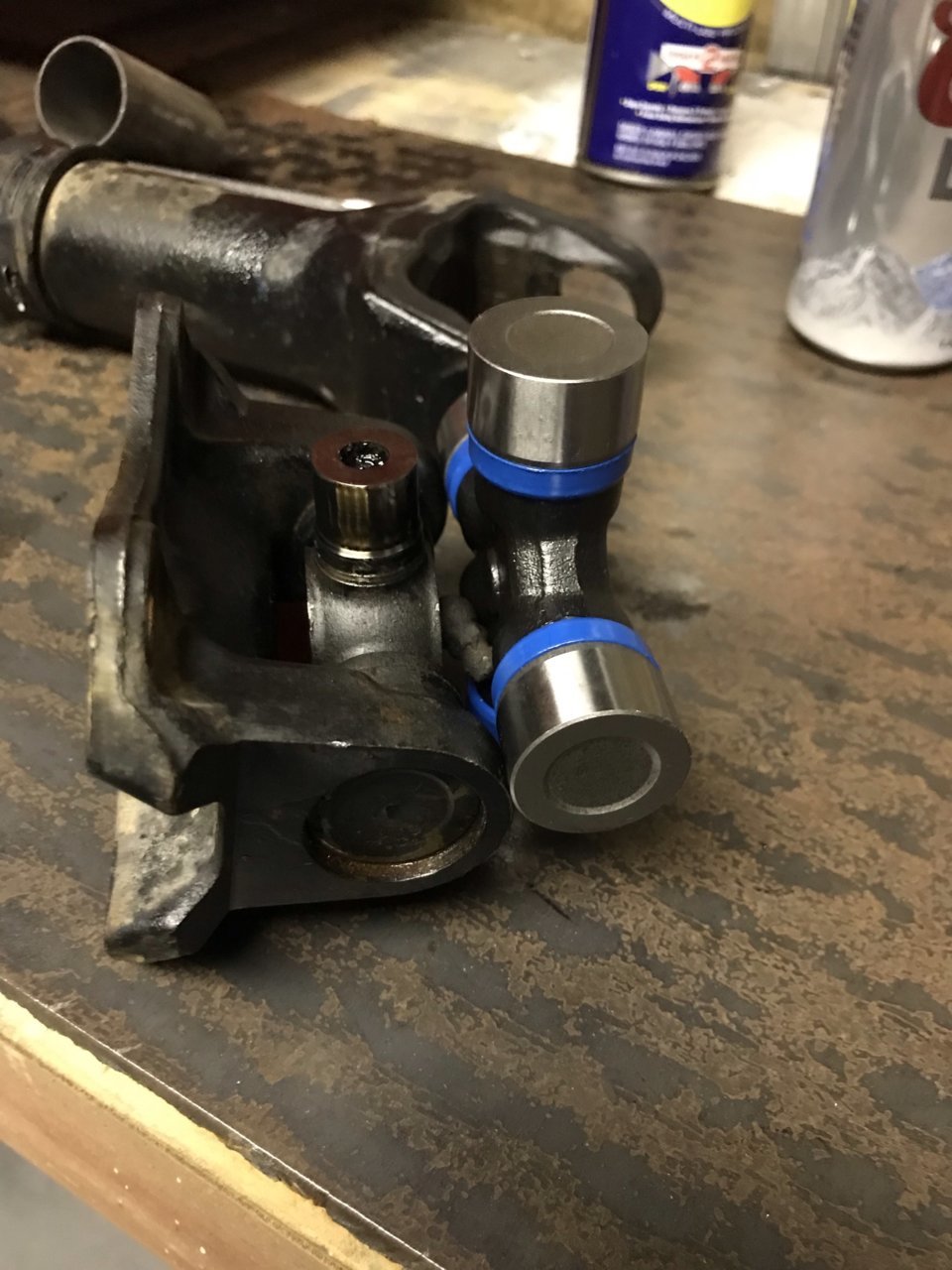

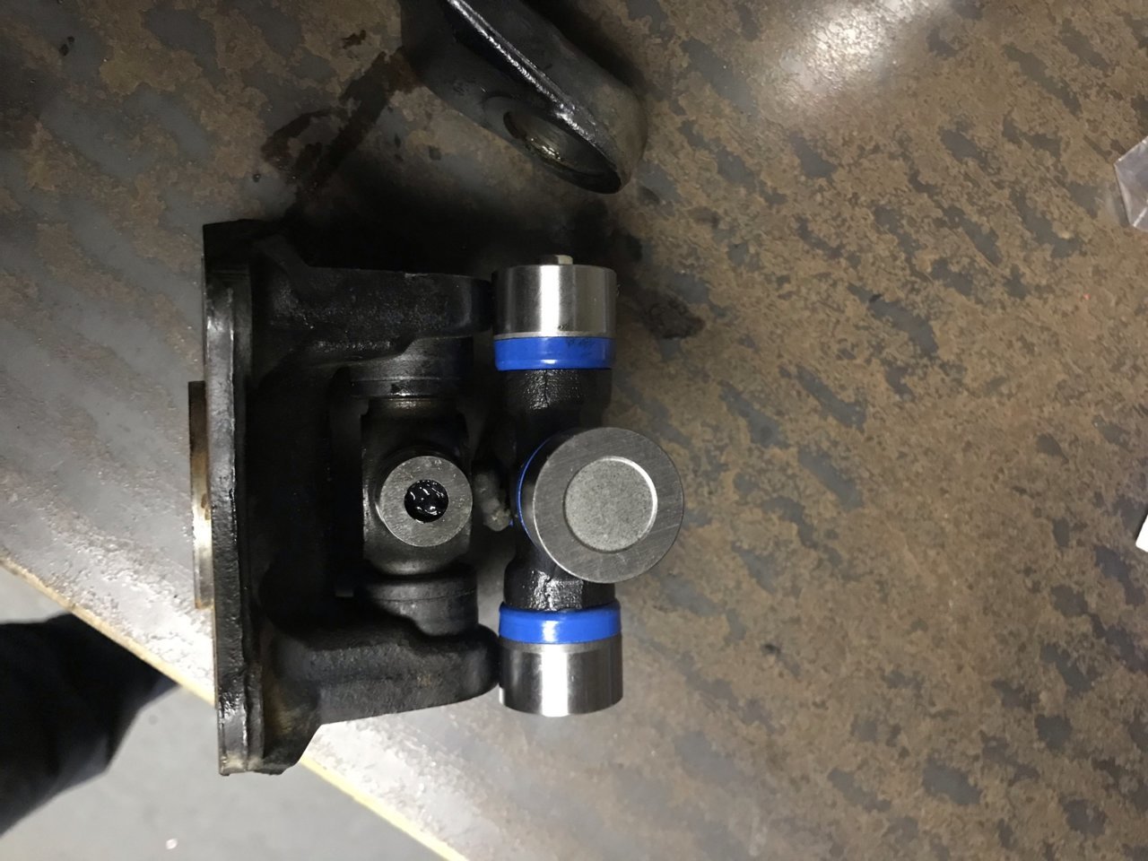

    I may have asked this before on another thread? Im looking to replace the u joints in the front axle i purchased before install. I had thought my findings were correct, but it looks like the rear shaft u joints are larger and deff wont fit properly with retainer clips... NAPA guy at the time wasnt sure.
    Thoughts? I can find the other part number without going into the dealership...I referenced the vin off the donor truck front axle.
  12. Feb 3, 2022 at 7:05 PM
    pics for visual
    Hope your cool if I do some QnA on your thread!

    You need the part number of the u-joints in the front drive shaft? If so, moog 325 is the one for the front driveshaft, same at the front diff and front transfer case. If my research is accurate Toyota PN should be: 0437104044
