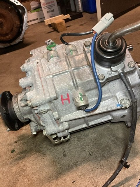

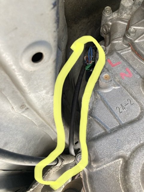

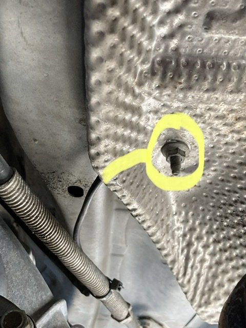

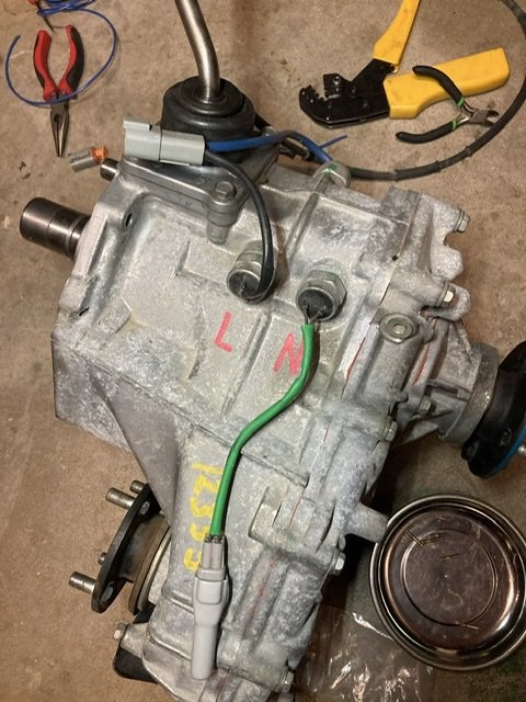

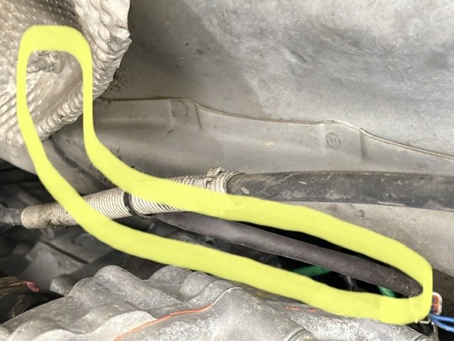

    I did ground one side(used a solid stud protruding from floorboard and nut that secures the heat shield for the exhaust and cab; I used an eyelet properly sealed ), I’m a nerd when it comes to electrical and don’t like to leave room for errors. As mentioned multiple times these normally open switches on the transfer case are a path to ground for the dashboard light.

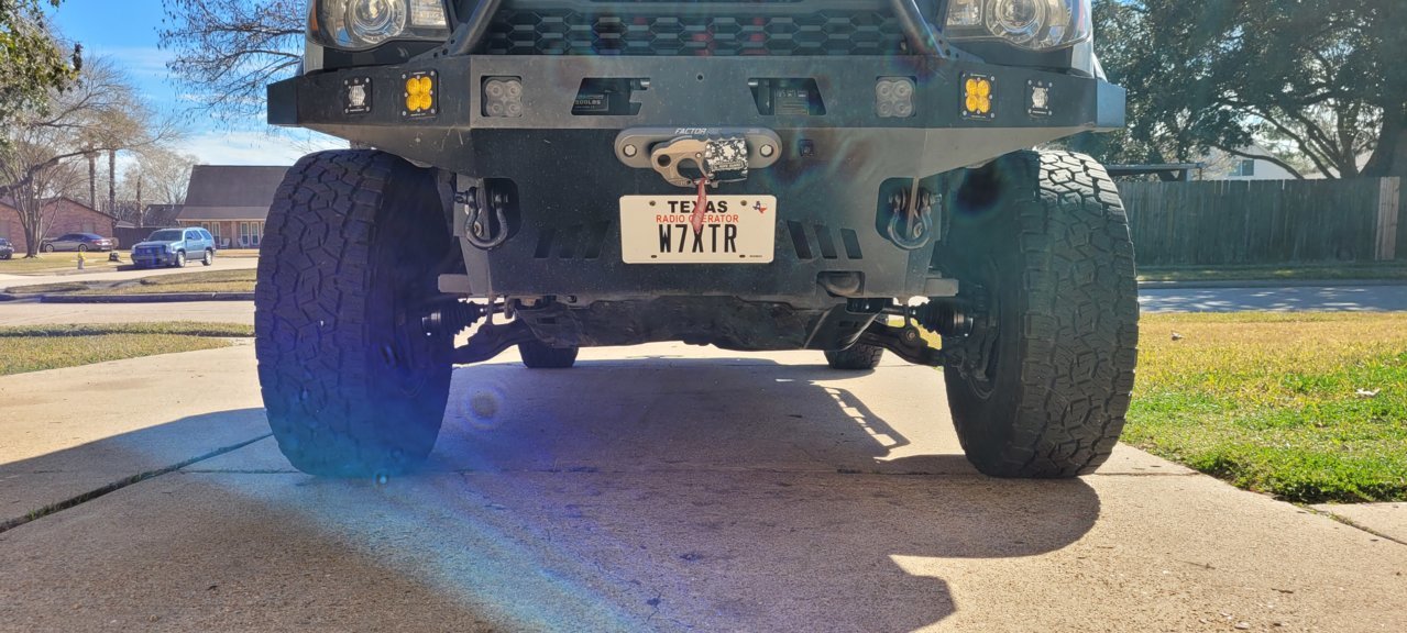

    Got the front end components on. Was really tedious getting the front diff on and then attempting to put the rear Allen bolted mount on.
    Excuse the glare from the camera lens protector lol
