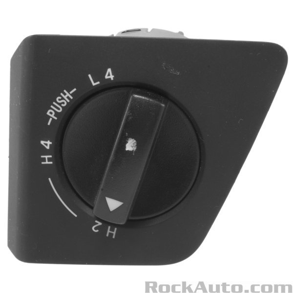

    Hey. Is there a way to convert it to a 4x4 with the Tacoma 4WD switch instead of the lever most use in convertions?1S7433__ra_p.jpg

    Sure. You need the 4WD ECU. And a lot more wiring to make it all work.

    yes but takes a tremendous amount of extra work for an inferior system.

    Alealexi

    Is it really that bad? I'm still a noob when it comes to this.

    yes its alot of wiring and you also have to switch out your computer if im not mistaken. Also you have to rely on a computer that might tell you it cant shift into 4wd. Where as the manual one you pull the lever and thats it.

    Anything is possible with enough time. Most conversions exclusively provide a solution to the clunky add/4x4 system by utilizing a manual lever. You cant tell me this isnt desirable :D
