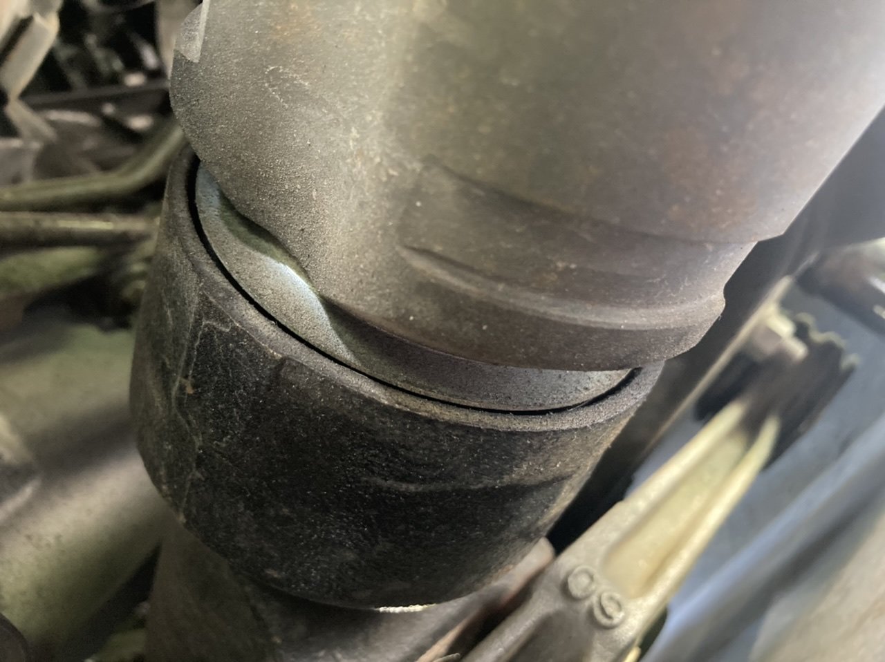

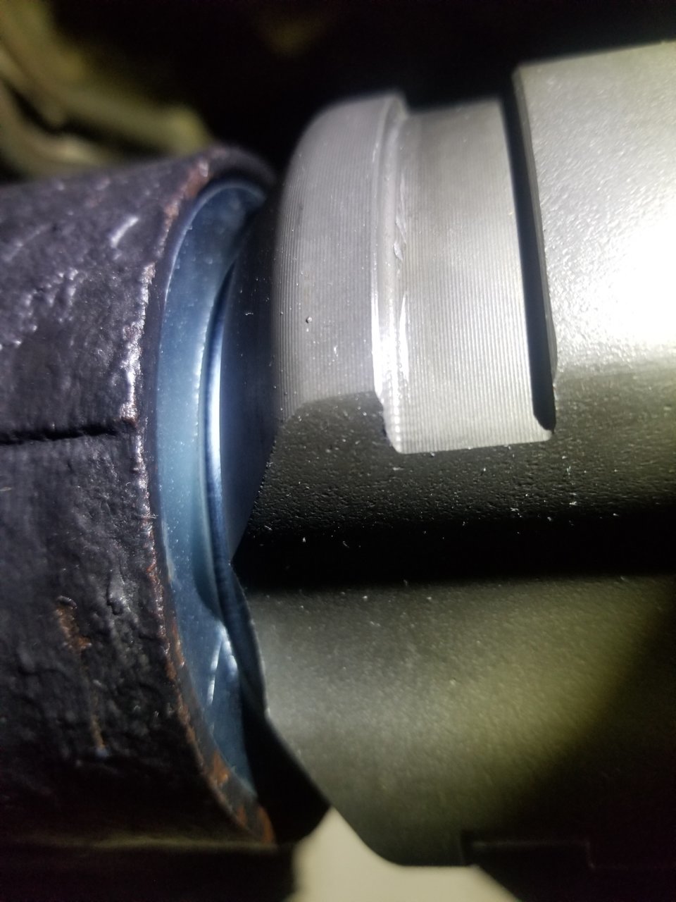

    Diff leak cv axle connection help-

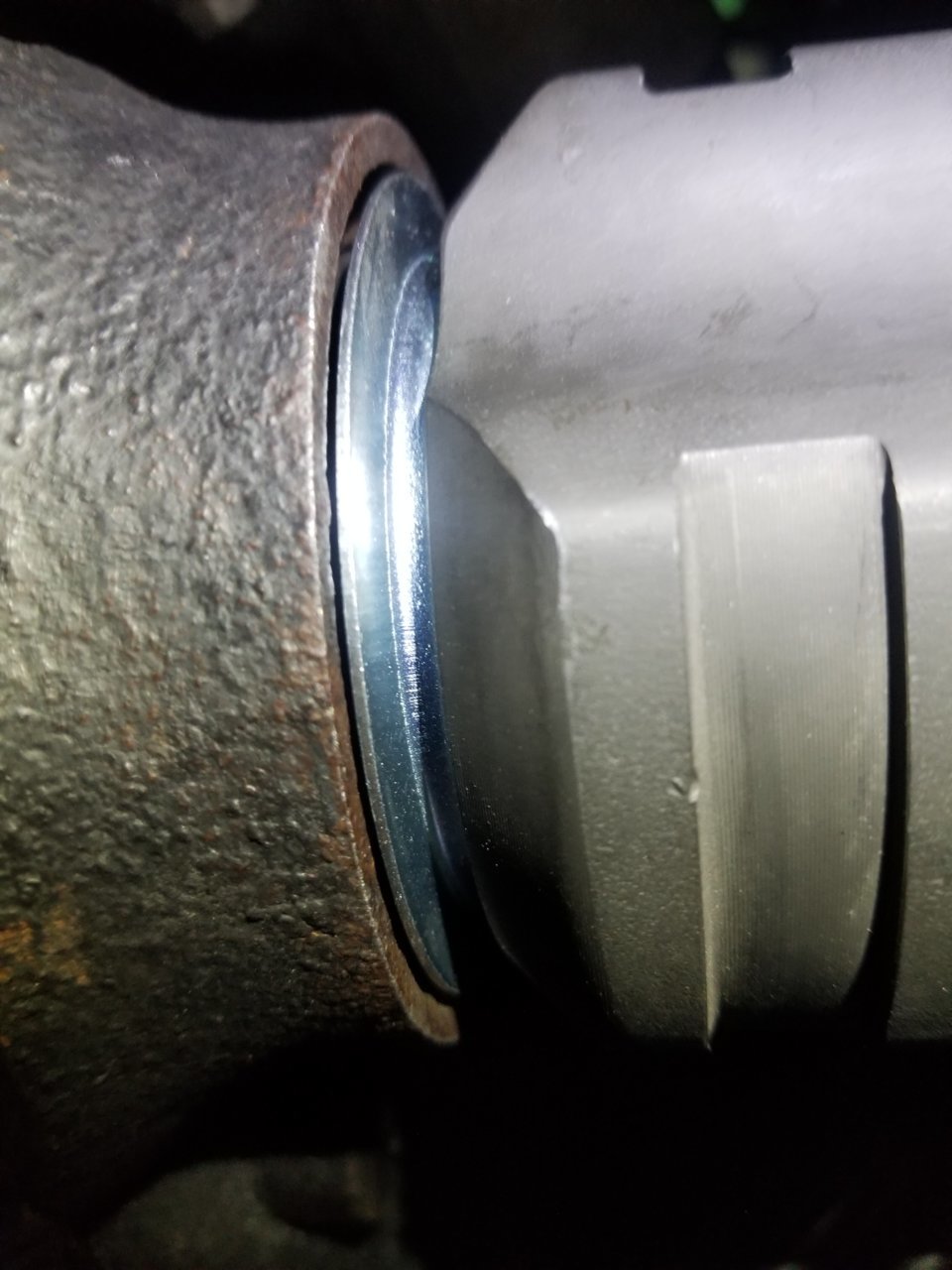

    Hey guys, was feeling super accomplished with our phase 1 front end completion (diff, cv axles, hubs, new uppers and lowers, disconnecting sway bar links and new brakes) but after a few small test drives noticed a small diff leak from passenger side diff & cv axle. Had no clunking/ weird noises and other than alignment everything felt great. I think it's one of two things below but could use any opinions and help you can offer.
    Cause #1 Are our axles sealed to the diff properly? Worried the non leaking side is not inserted deep enough and the leaking side is inserted too far.
    Picture 1 is the non leaking side, but is not resting flush. Am I getting lucky here?
    Picture 2 is the leaking side- did we insert too deep? If so could we have damaged the seal and created cause #2?
    Cause #2 Diff seal leak- I listed as 2nd because I had a shop re-gear, install an arb air locker, install bushing upgrade and new seals. They said they didn't swap one (passenger side) because it was in good shape- I thought it looked fine as well. Could we have damaged by driving axle too deep?
    Any solutions or other causes would be appreciated. First time we've done anthing this intensive (a shop is doing t swap & transfer case install) and I thought we did pretty good until this :confused: Thanks in advance!

    First picture looks good, the second one looks too deep. @6 gearT444E whatcha think?

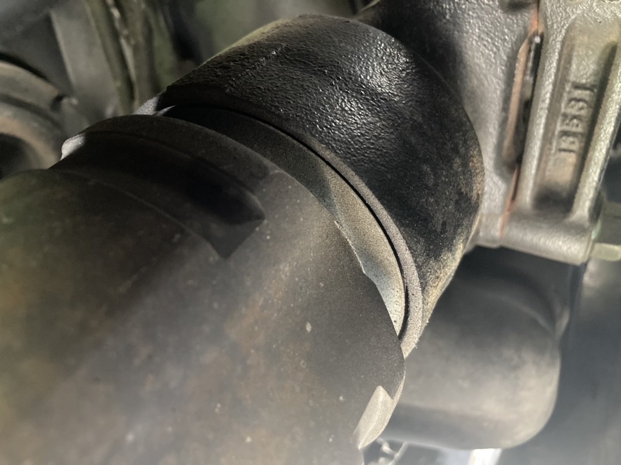

    Including a pic so you can see leak amount, seems to stay steady here and drip one drop per day.

    replace the axle seal.

    Thanks & that's what I'm thinking- I think I'll try to back it out a little first (hoping we seated a little deep), but replacing the seal will be next course of action.

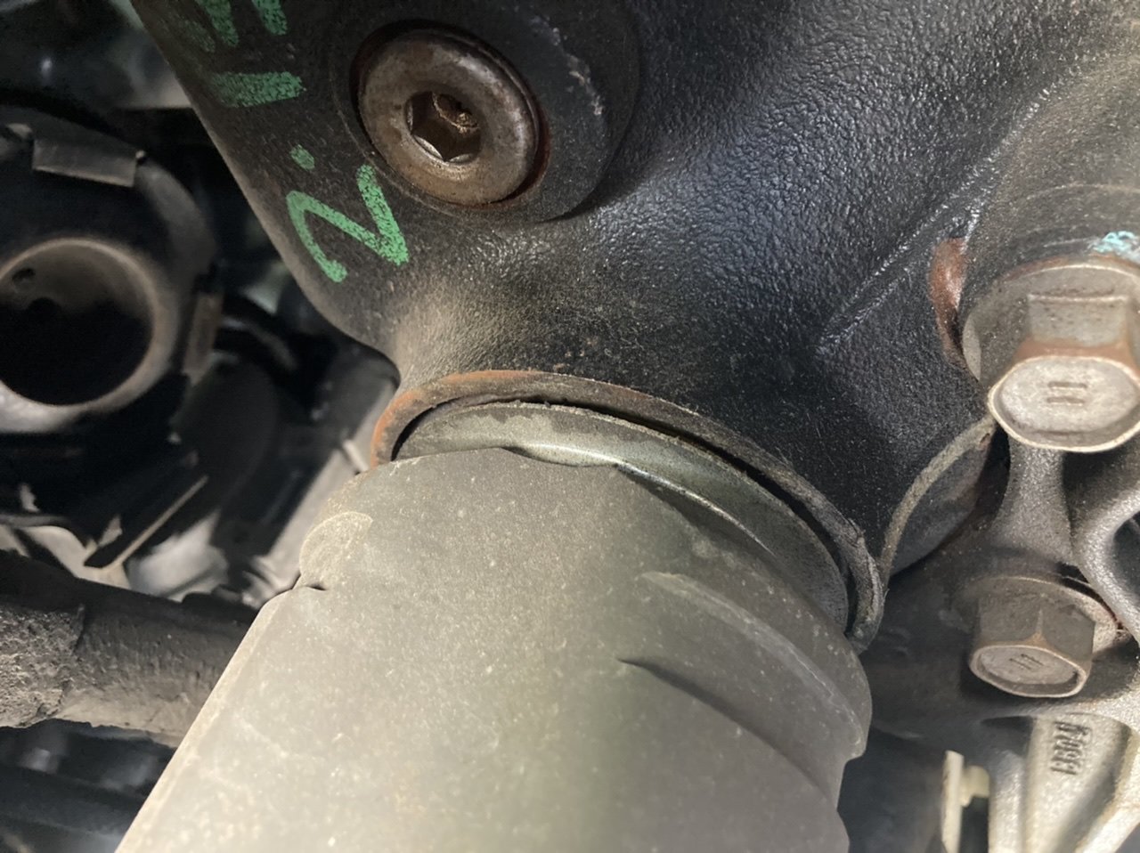

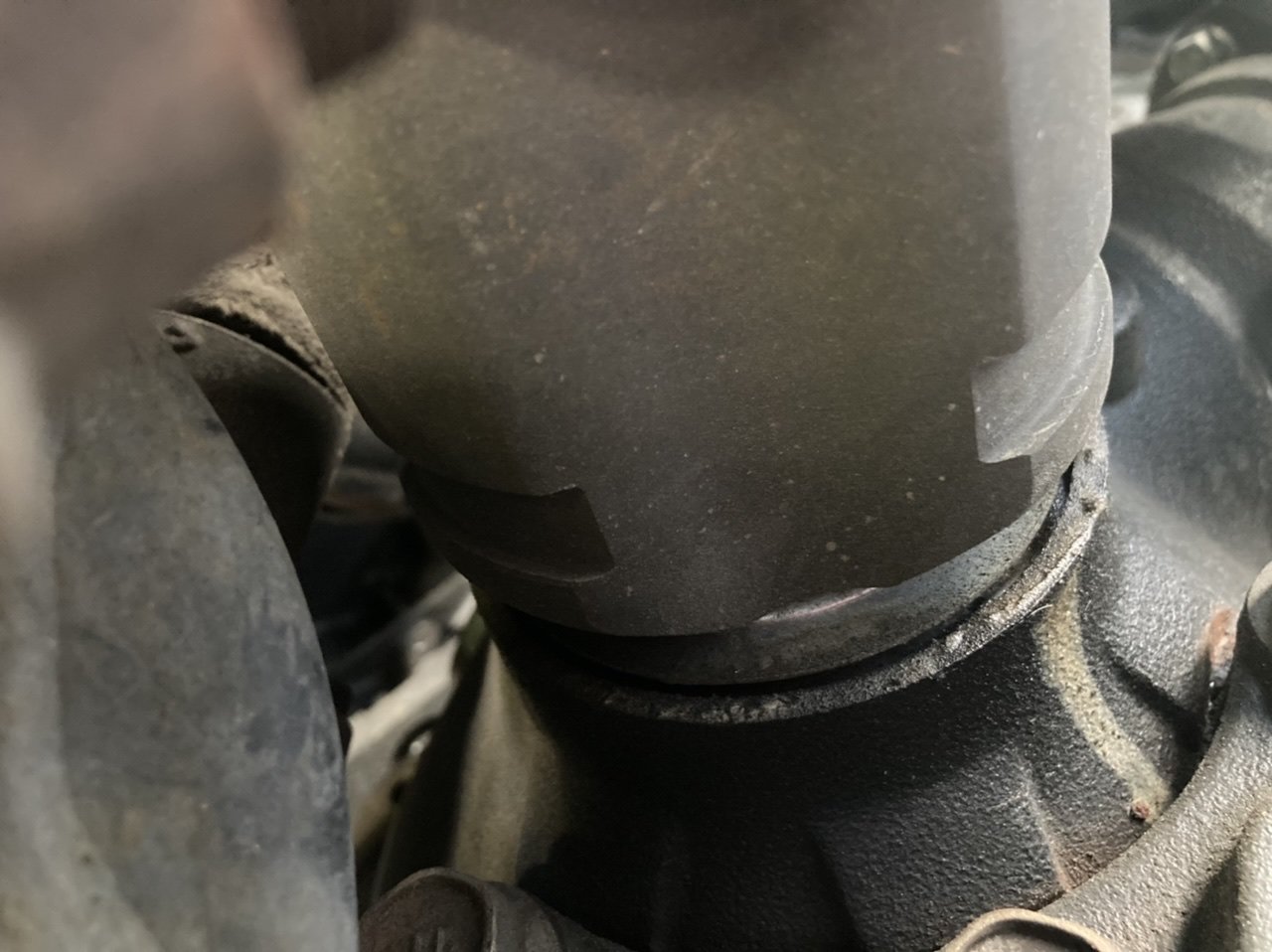

    I got curious and went and take a look, the passenger seems to sit a little deeper that the on the driver side.
    A1786C15-D6AC-40A7-97F8-5CC6799EF93D.jpg 57872A09-F34C-4157-959C-467999CBD142.jpg
    Driver side(images below) seems to sit a little outer.
    82BCA371-1B39-4ABB-A4FB-60ABE1B230B6.jpg 14ED6125-D67A-4296-90BF-CFE953DE2EBB.jpg

    I actually have the part- asked my shop to do it when they re-geared & changed bearings + needle bearing bearing replacement... they said they didn't change passanger side because it looked good... should have had them do it regardless while the diff was out... not a fun change with everything put together :D live & learn!

    Thanks! Mine is definitely seated deeper than either of yours. Curious what @6 gearT444E says if he weighs in.
