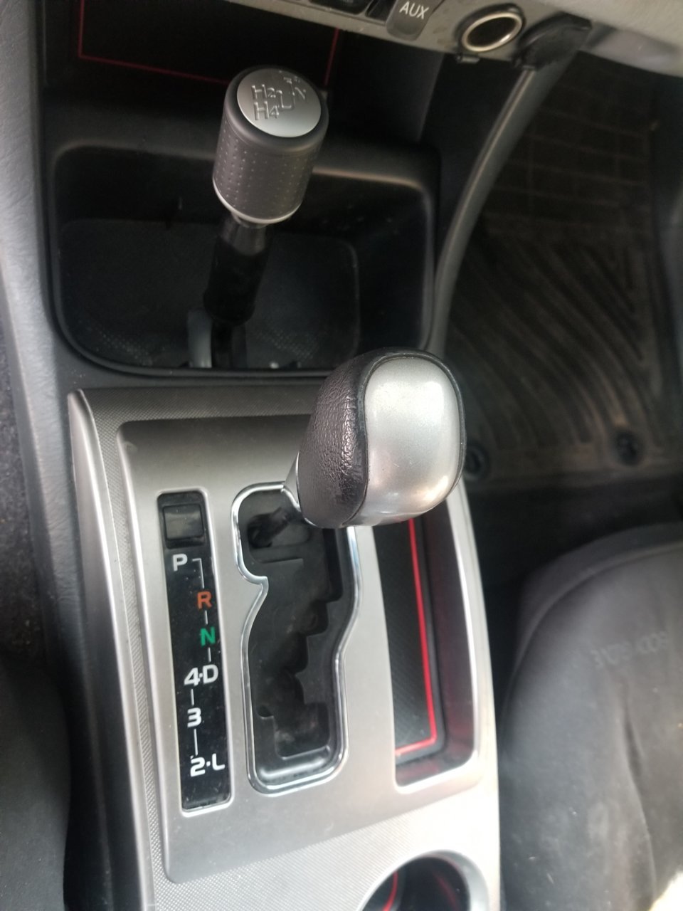

    im guessing your shifter is hitting something and pressure is being applied to it. Or you don’t have the right detent spring for the 4wd shift rail.

    Thanks @6 gearT444E I had seen a YouTube vid about detent spring fixing this issue on a Jeep transfer case. Nice to know it's applicable to the FJ transfer case. Your other option is possible too- the shop I went with ran the transfer shifter long (not next to transmission shifter) so that would make sense as well. Moving to PHX next week so I'm hopeful that I can find a good shop there to help me button up a few details... living the apartment lifestyle and working some long corporate hours so I simply don't have the time, tools, space and most importantly skill to KO alot of the things you and so many on this board have accomplished.
    For my very beginner level, I'm still happy with the work I didn't outsource, but none of it would have been possible without this board and the contributions of too many to name... many thanks everyone

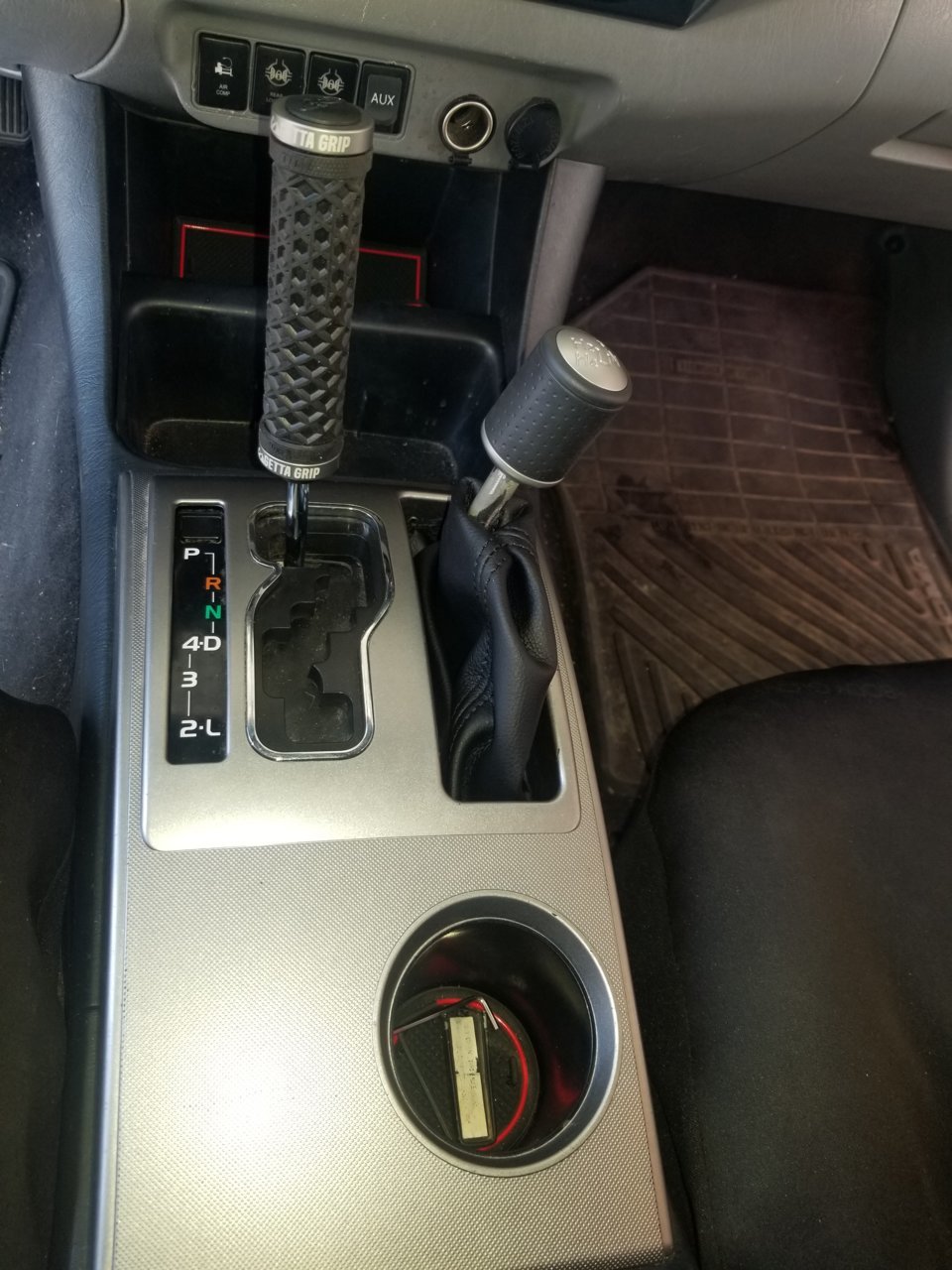

    Very cool weekend- met up with @Yacob_D who kicked ass & relocated my shifter. Had a great time & went wheeling after & finally got to test that 4x4 out- really enjoyed/ was impressed with 4Low! This was a major milestone in my project, still want to address some driveshaft vibration @ 70-80 mph but the truck is good to go and 4x4 operational.
    Before & after pics below- J shift is much smoother in this spot. Can't thank @Yacob_D enough! @6 gearT444E I changed detent springs but it was the plastic from the automatic shifter popping the J shift into 2- relocation fixed it.
