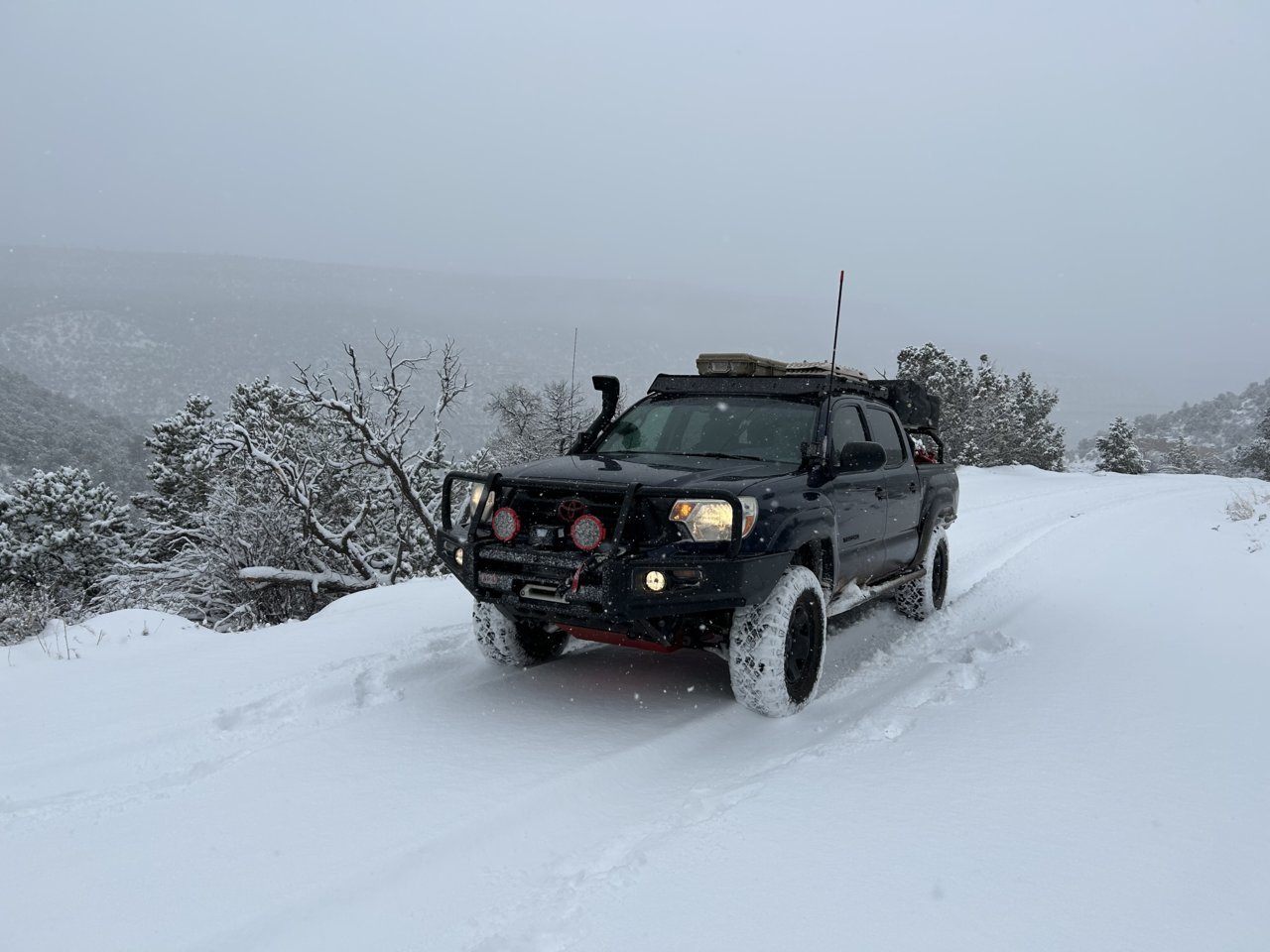

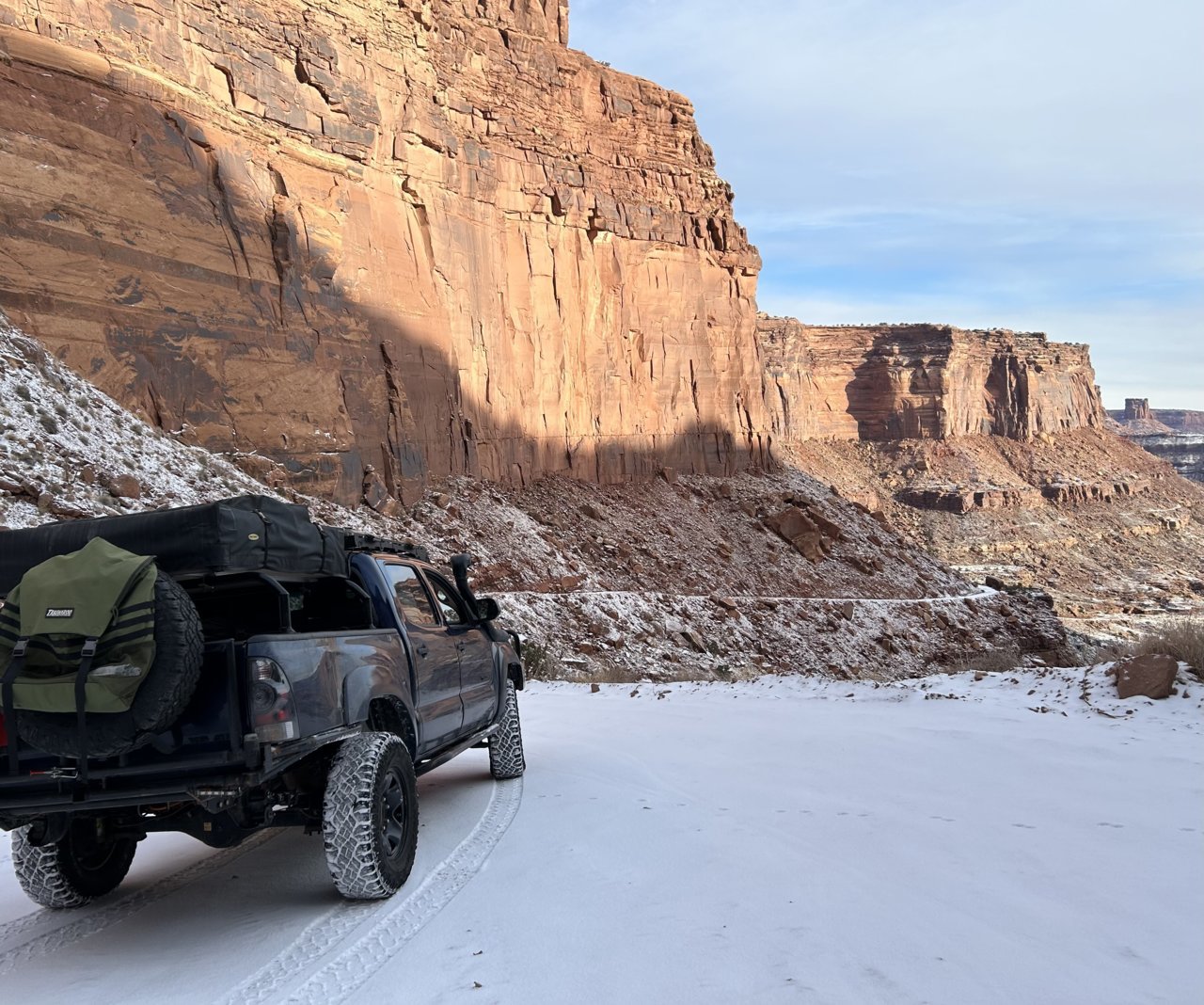

    Another little update: it’s been 40K miles since the conversion (225K total), again no issues whatsoever. Just got back from a 4K mile trip to Utah/Colorado. Used the 4wd system heavily in deep snow and icy highway conditions. Was shifting in and out of 4wd at 60mph. Had the truck in 4hi doing 75-80mph for hours and hours. Truck took it like a champ, shifting still is buttery smooth:D
