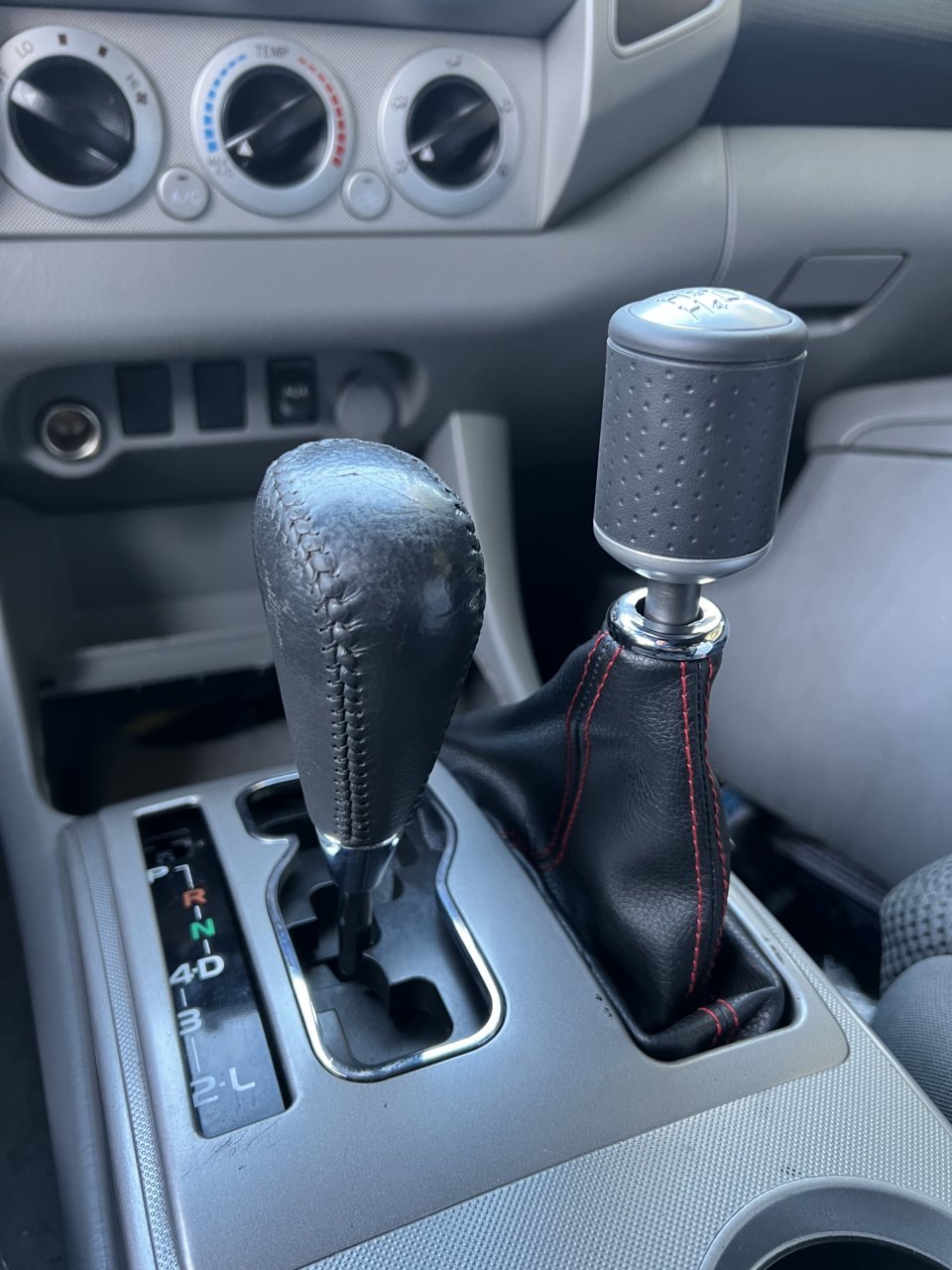

    I was going to say you may want to extend that shifter a little higher. When I did mine I had the fj shifter at about the same height and when I tried shifting into 4lo, it would hit on the side where the shifter came up through. 4hi was no problem, just when I tried shifting 4lo. Good luck with it!

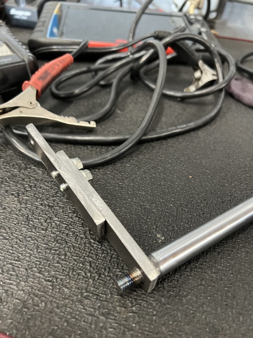

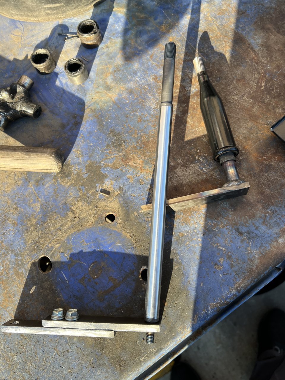

    That would be sweet. I don’t own a welder or know any welders so the crossmember and shifter seem intimidating. How did everyone figure out the measurements for the shifter before welding it up?

    I chopped the shaft off about an inch up and tacked pieces together up till it poked out of the coin holder while it was installed. You can pull the shifter out and weld it solid out of the truck after you get it in the right spot. You can just modify your stock crossmember to relocate the Tranny mount. It just needs to be more forward to match the bolt locations on the 4x trans.
