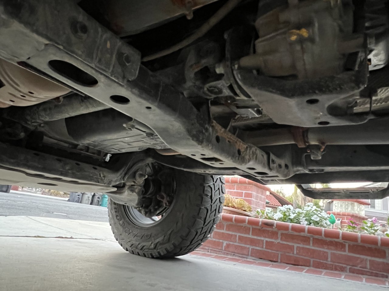

    Checkk
    Checkk Well-Known Member
    Apr 23, 2016
    #185107
    124
    Tom
    2011 Toyota Tacoma Prerunner TRD OFFROAD
    still have to fab it, 4wd crossmember sits higher.

    Checkk
    Apr 23, 2016
    #185107
    124
    Tom
    4wd crossmember. I flipped it, cut it down and welded a plate and drilled the holes to mount the transmission mount. I think only benefit with the 4wd crossmember that it did clear the front driveshaft. I did have to grind down the holes a little bit to install the bolts on the crossmember to the vehicle.

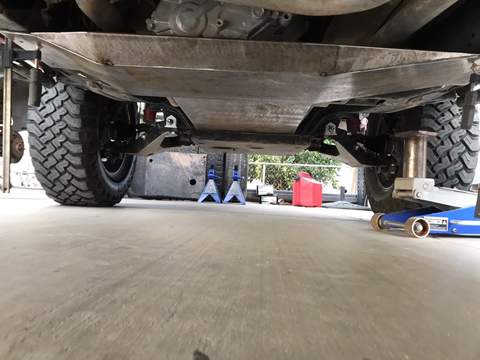

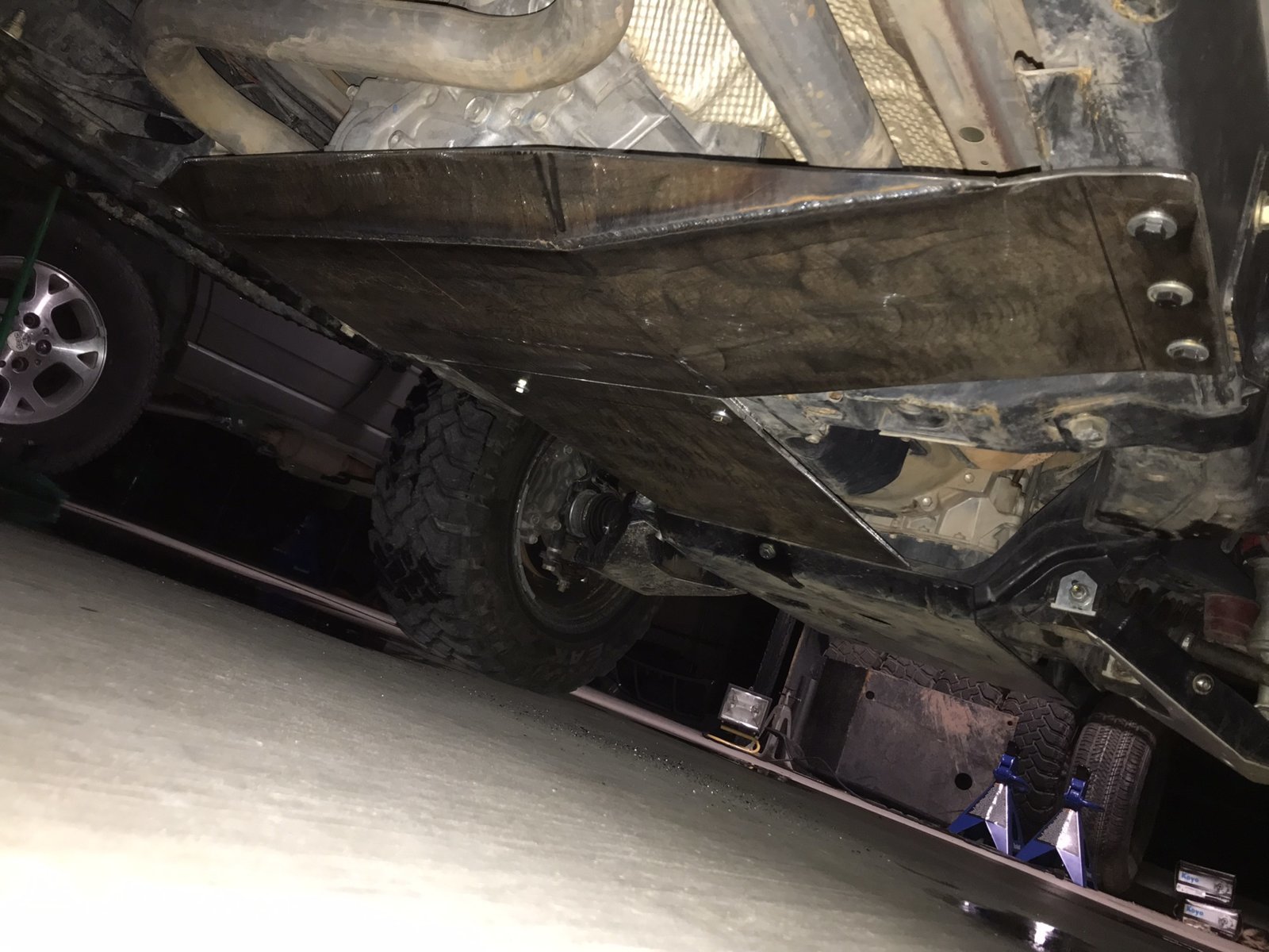

    Yacob_D It's Fine, Leave It.
    Aug 12, 2020
    #337449
    1,321
    Jacob
    The J
    08 Red, AC
    Couple nuts and bolts 4x converted
    Added some serious Beef after the last 10g skid i destroyed. Dont skimp on the material thickness, went 1/4" all around and the front skid is 3/16" chromoly
