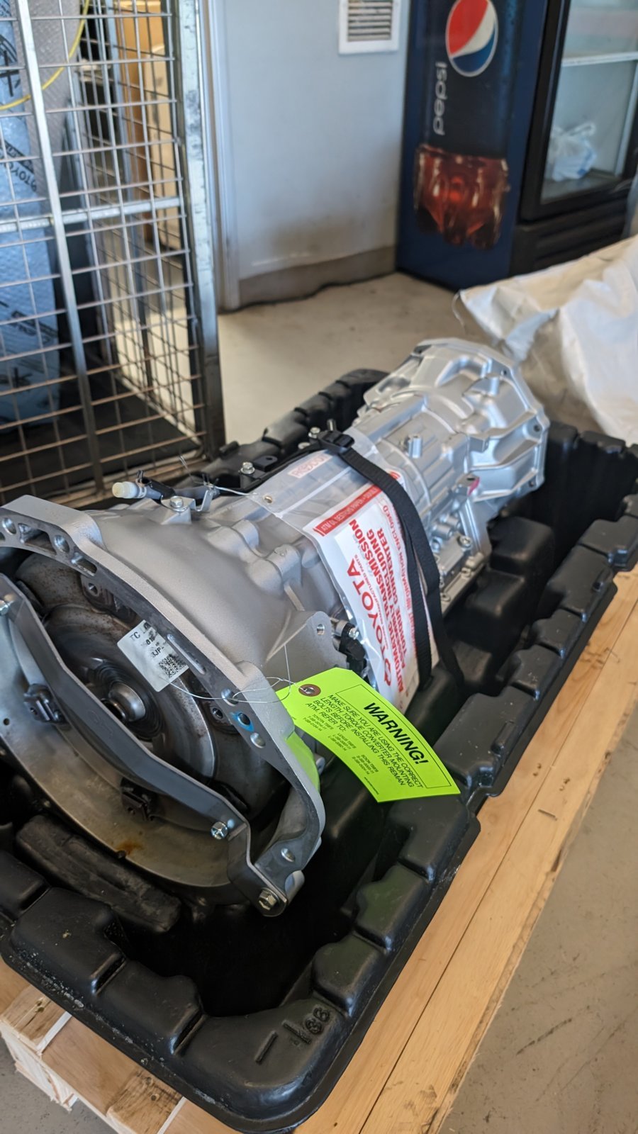

    PXL_20240104_230405614.MP.jpgtoyota transmission secured just need to put a transgo kit in it over the weekend and I'm off

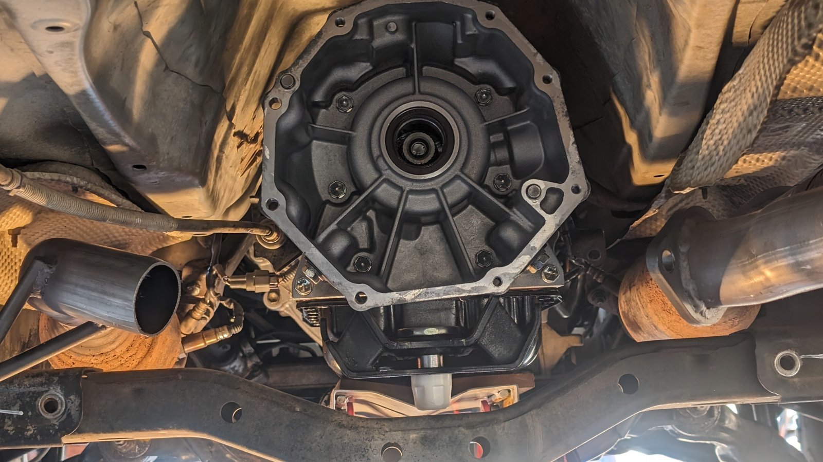

    PXL_20240114_185114906.MP.jpg Holy shit that transmission install was a bear

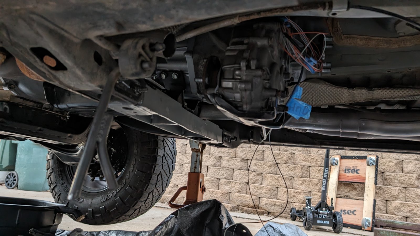

    PXL_20240118_011002441.MP.jpg PXL_20240117_193618419.MP.jpg Crossmember, transfer case, and front differential in:thumbsup:

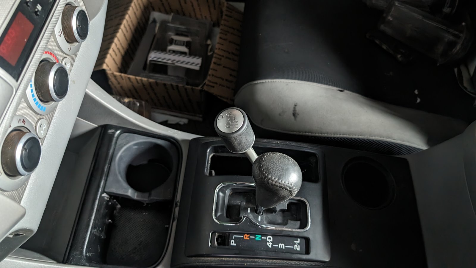

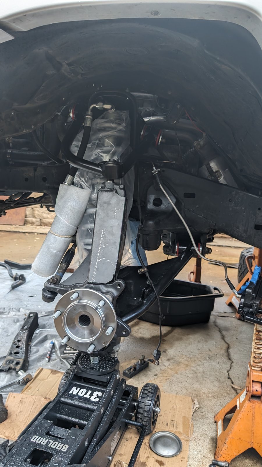

    Haha hell yeah got half the front in today called it early because of rain and it's a good reason to stop PXL_20240121_235912295.MP.jpg

    Is it normal for the transfer case to move a little under throttle? Or does that mean I need to beef up my crossmember more because it's torquing?
    Or is that normal because I don't have solid transmission mounts and that rubber joint has movement on purpose?
    Sorry just some tired anxious thoughts lol
  15. Feb 2, 2024 at 10:48 AM
    #555
    Y2kbaja
    Y2kbaja Well-Known Member
    Jun 11, 2013
    #106028
    1,375
    Sacramento
    05 Total Chaos Tacoma
    Total Chaos
    With stock engine mounts the TC shifter will move with engine torque...normal operation.
