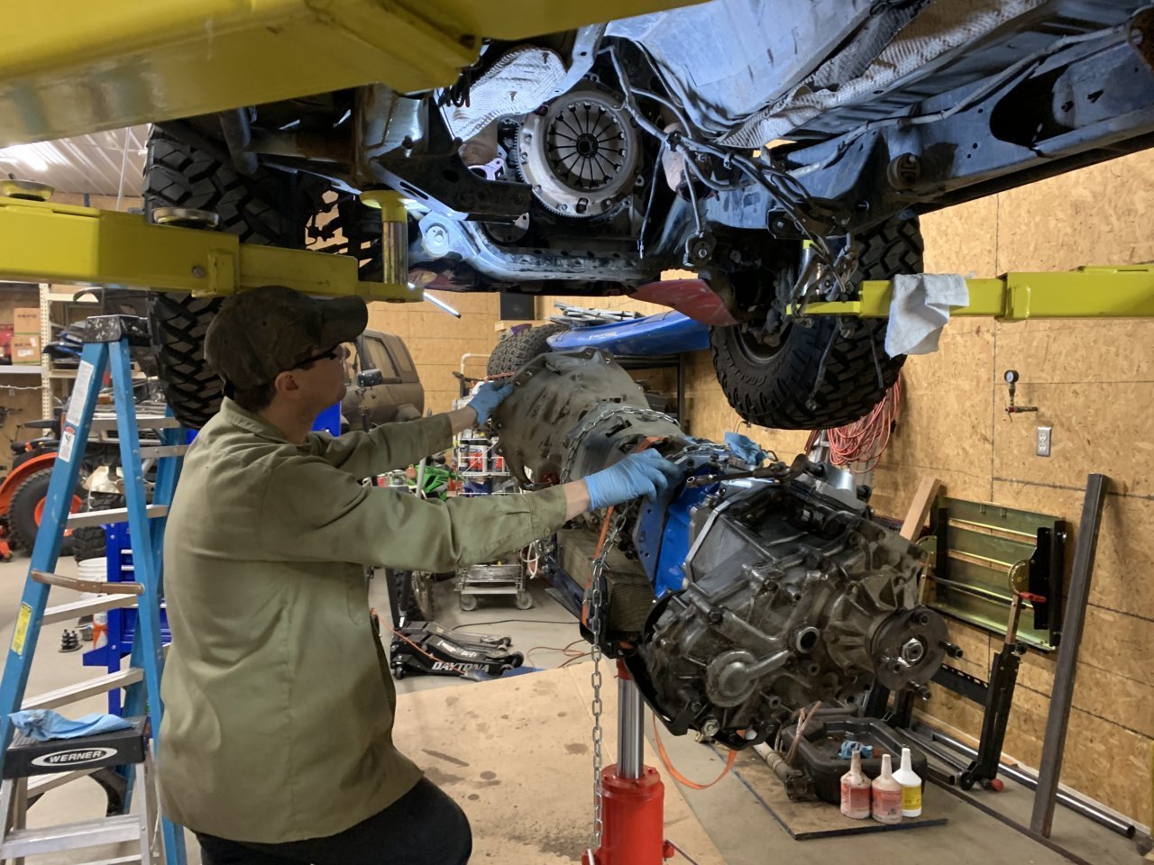

    Great post! I'm really hoping to do this one day. One thing that I've been confused about is the transmission swap. Is that always necessary or are there just certain models that require it? '07 automatic prerunner here.

    You have to have a 4wd output shaft to mate with the transfer case. Yours doesn't have the correct output shaft. You can convert yours or make it easier on yourself and just swap the whole transmission and get a lower mileage one in the process.

    I ended up getting a transmission and tcase with 70k less miles than my motor, so win for me.

    yep thats what i did as well. My trans had 109k on it and i swapped out to one that had 54k!

    Definitely a good way to get fresher parts. I have ~150k on the motor. New trans has 80 and the tcase had 25 (came out of a 2018 TRD trail edition 4Runner). Shop and ask around when they have multiples.

    Yea I had 185K on the truck, trans now has 55K. Def shop around. I know I overpaid for my t case at $451, especially with no shifter, but i am very impatient and wanted 4x4 now lol

    Fellas, any tricks to torque the bolts on the torque converter? I am having such a hard time with that shit. Thanks in advance.

    I couldn’t get my torque wrench in there. I just used a small ratchet and estimated the torque. Oh and use loctite

    Swap in a 6 speed while you’re having the drivetrain out, problem solved :)
