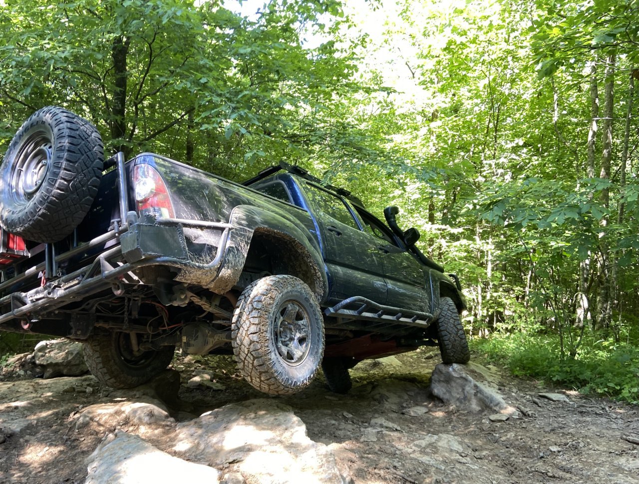

    Let me just say 4WD IS AMAZING LOOK AT THE COOL PIC 4LO GO BRRRRRRR

    Facts!!!!!
